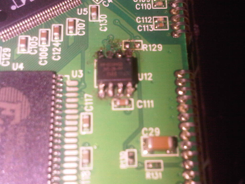

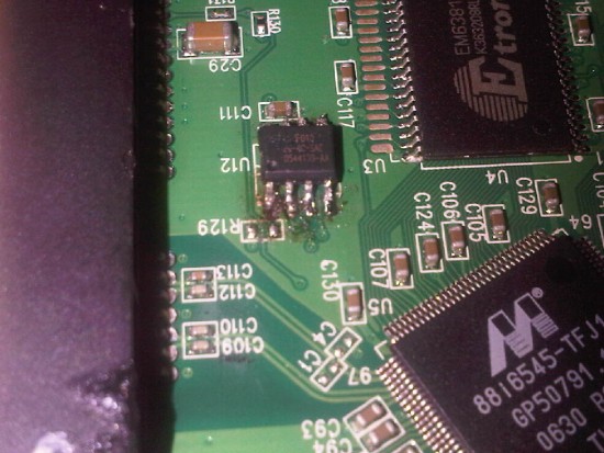

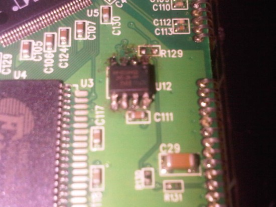

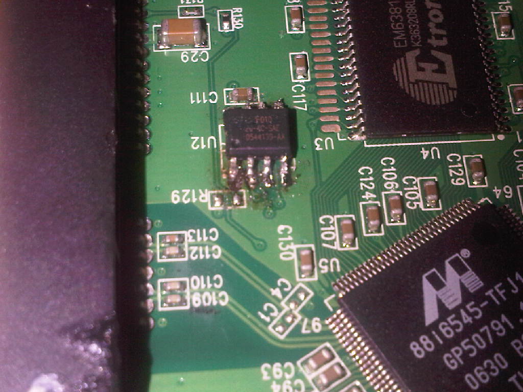

Here is a photo of the solder job its not pretty but its my first run so be gentle

I think I see a solder bridge between 2 adjacent pins.
Get some liquid rosin core flux -- along with a needle tip dispenser --- and apply it to the joints to be soldered. Check for shorts and then CLEAN UP your work with flux remover or isopropyl alcohol and a Q-Tip or two.

second pin is touching the other pin.
you can see that.
allso the second pin at the top is touching.
like jono-ats says
try and remove the flux with isopropyl alcohol and a toothbrush slowly.
then you can see the print clear
