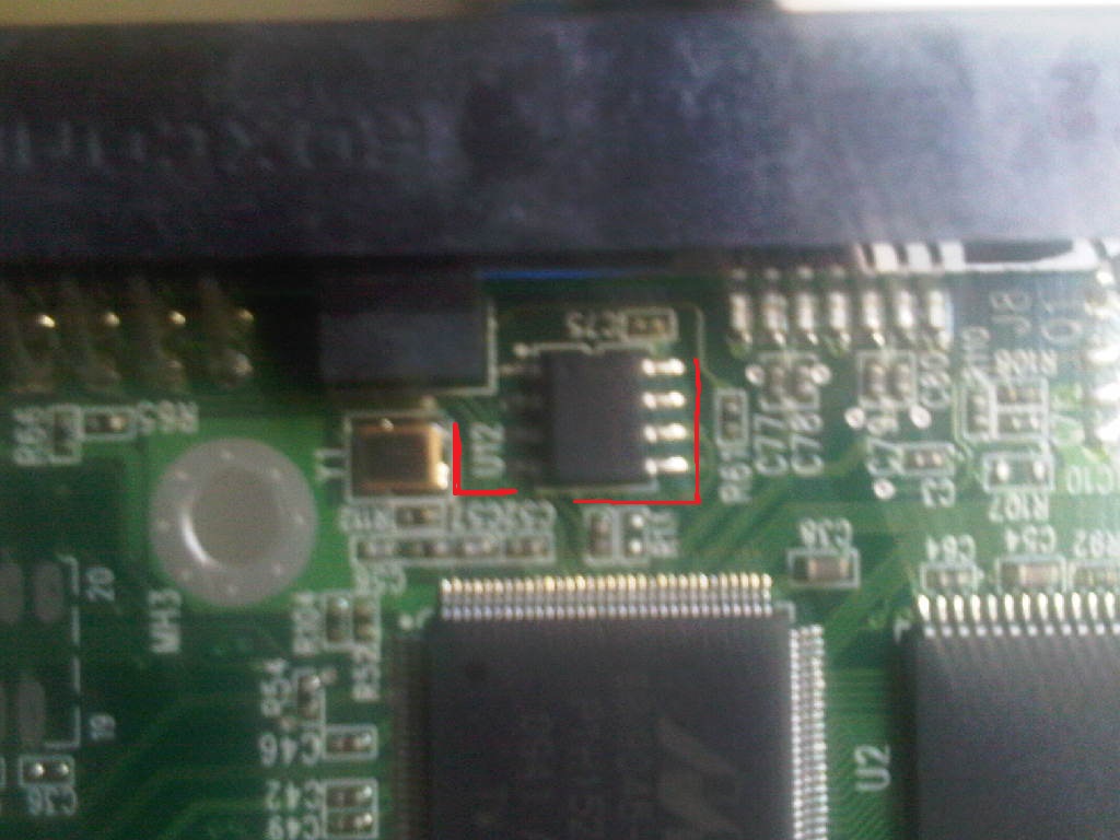

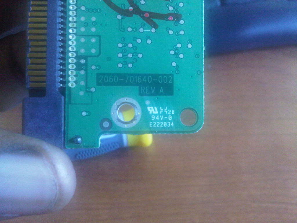

Hey Guys/Gals im back with another hdd issue
this is a real world situation now and not me just practicing.
Today my friends WD5000AAKS-00V1A0 500GB Movie drive crashed/stopped working.
What the drive is doing is spinning up for about 1min then nothing.
when it is actually spinning its not detected in the bios or anything.
What im wondering is would a PCB swop and a U12 transplant work on this
drive if he can find a donor PCB.
Ive done this procedure on a WD 80GB and it worked like a charm but with these
newer drives im not sure... any input would be greatly appreciated as per usual
thanks guys/gals

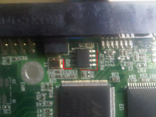

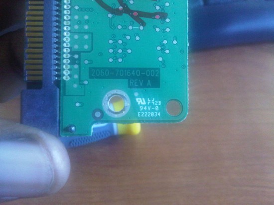

 Post subject: Re: WD5000AAKS-00V1A0 Spins up then Down again
PostPosted: April 15th, 2010, 8:16
Joined: March 23rd, 2010, 11:48
Posts: 57
Location: barbados
unknown20010
I see U12 on the PCB if thats where the ROM data is stored on this drive thats another story... Help any one... :)
ive attached to pictures for your viewing pleasure hehheheheh
PostPosted: April 15th, 2010, 8:22
Posts: 1729
You still have to change the heads. :)
PostPosted: April 15th, 2010, 8:24
Posts: 1419
Rare case, but they do exist.
You only have to find same board which has U12 also.
PostPosted: April 15th, 2010, 8:31
Posts: 2984
This is rare. Only other ROYL disk I have seen with External ROM is 2.5" Orion family. Looks like maybe some DragFly4 also use external ROM.
PostPosted: April 15th, 2010, 8:45
Posts: 2984
I would try to avoid any internal work on this disk. A professional will charge you around several hundred dollars for recovery in this state, if you open the disk, even for a quick peek inside, the costs will increase to thousands.
