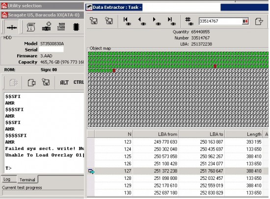

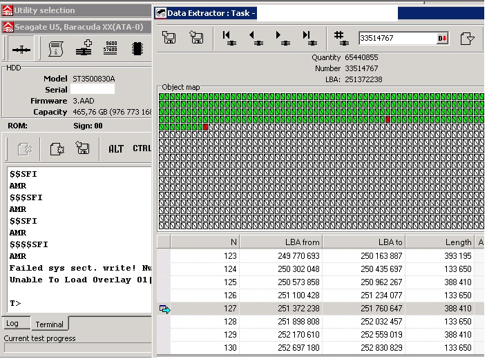

I am using a loader to get ID with the drive.
Now i check it that i can edit the sectores from H0, H1, H2, H5 and i get the data well, if i go FF or BF with the mouse i can clone it, but the problem is that i have to be with a click mouse and the cursor have to be on the right place.
This will take a lot of time, if i try to read that sectores with the DE the disk start BSY and it lost readiness.
Anyone have worked a job like this one ?
any info will be great,
ZeBong
