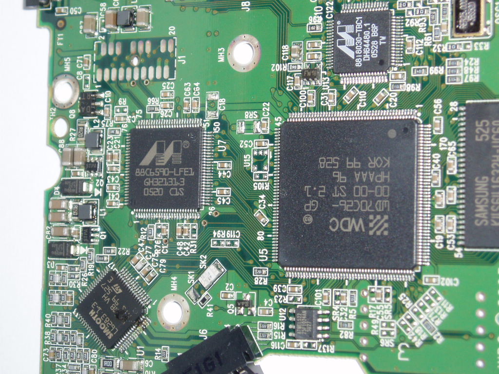

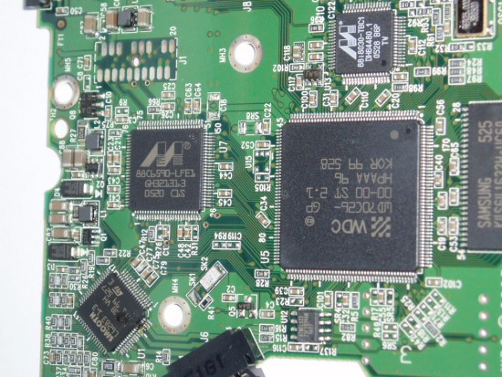

I'm looking for a working PCB for my WD2000JD.
WD P/N: WD2000JD-22HBC0
Form Factor: 3,5"
Code on PCB: 2061-701267-001 Rev A
Code on sticker: 2061-701267-200 AL
Main controller WD70C26 - GP v2.1
Motor controller L6283 v1.3
Thank You in advance

 Post subject: Re: PCB WD2000JD Wanted
PostPosted: May 2nd, 2010, 14:17
Joined: April 30th, 2010, 22:30
Posts: 5
Location: North Dakota
Here is the image of the burnt chip L6283.

I have the 2061-701267-001 Rev A PCB not the -001267 I think that will make a difference.
PostPosted: May 6th, 2010, 4:02
Joined: July 14th, 2005, 0:59
2061-701267 SATA = 2061-701265 PATA + rewrite flash :D .
