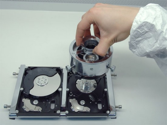

Hi to all.
I need a tool for make swap platter from a Motor Blocked Hdd to a good motor same type Hdd.
The problem is to do not loos allignament from Hdd !!!
This Hdd have some metal block part, between platters (have 4 platters).
Someone can tell me if HDRC tools can make that swap if the Hdd have that Block between platters ?
If with HDRC tools is not possible, someone can tell me if there is some other tools for make that ?
Thank you very mutch to all. Bye :D

No, HDRC tools and SD tools are not good (or even functional) for drives with spacers

I would like to correct you. HDRC tool can easily move platters from one HDD to another. Whether the HDD will actually work again is something completely different. :D

I do not wish to sound mean, but you should not even be considering moving platters if you are not aware of the options and solutions that are out there for doing so.
There is basically 3 options: SERT, HDDSync, or self designed tools.
All of these options are going to run you at least ~$5000USD, and you will need a ISO100 (minimum) clean room to be able to perform it.
All of these solutions require a lot of practice to execute safely. Even seasoned techs who have done many of these transplants don't enjoy it; because no matter how practiced you are at the procedures there is still many things that can go wrong.

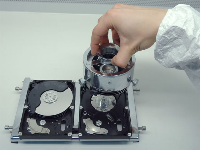

any body know where to get this one? any feedback for it?

It's HD HPE SP. SD don't sell it now, because it need corrections.

I have this for sale, bought it a while ago and not dared use it on clients drives.

have SD HPE pro. Dont dare using on clients drives but as practice had maybe 60 percent sucess with 2.5s and 30-40 with 3.5 drives.

I contact SD, and they say me that now the SD HPE PRO is not ready to sell.
They must be correction on tools, but tell me the new release can be used with Disk Space Hdd.
For now we can only wait, when new release are ready.
Thank you to all, for comment. :wink:
