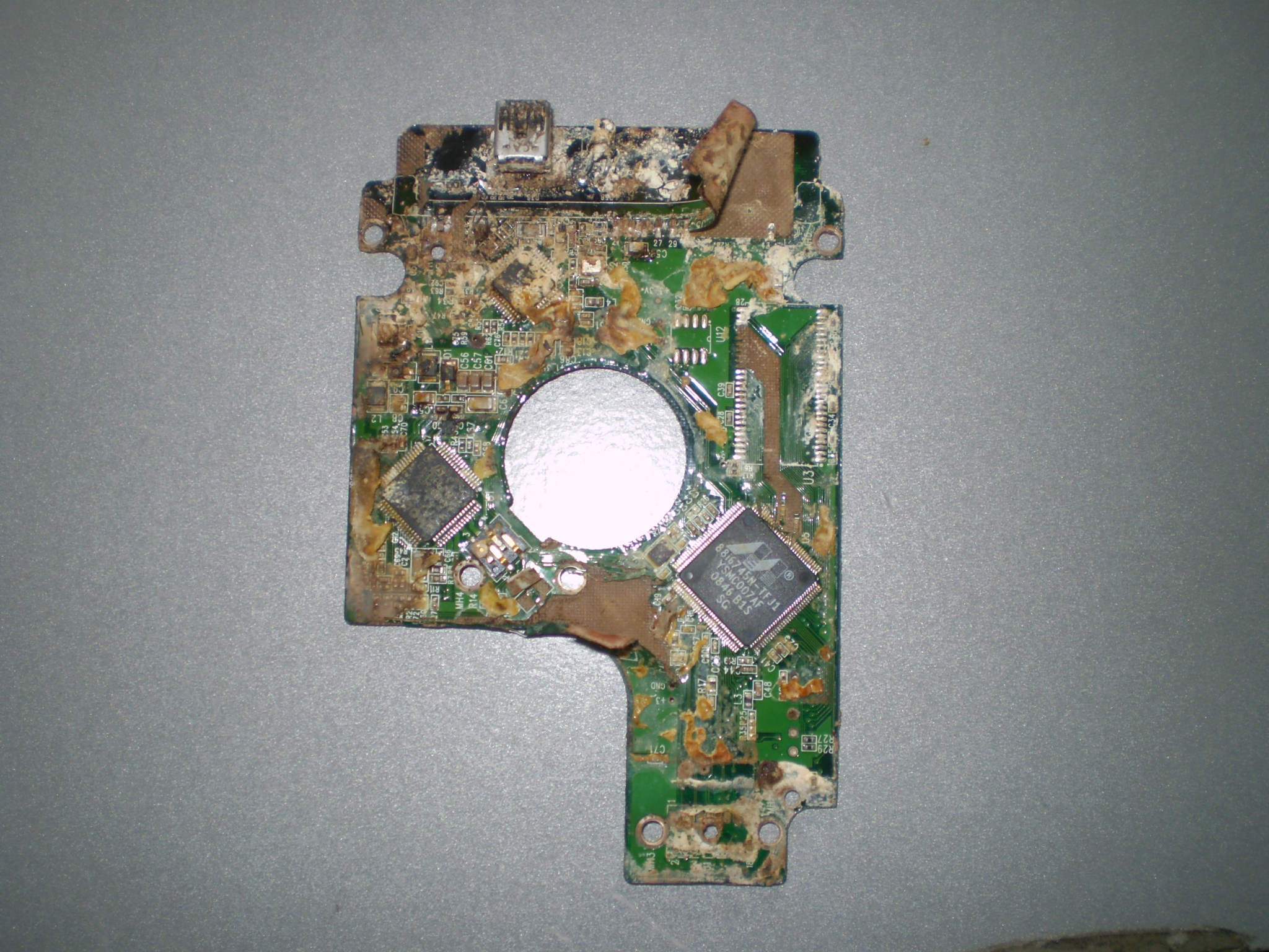

I need to find out the type of WD with PCB code 7016115-003. It's a 2,5" HD with a mini USB integrated at the PCB. Please help me if you know. Thank you.

Yes the drive model, sorry. The cuestion is the pcb is burned.
Edit: I attach the picture.

I think the drive model would be WDxxxxBMVV-xxA1PS0. But why you need to know the drive model anyway ?

I need a exactly donor (Western Digital 2´5 HD) to change the platters. My PCB it´s burned but
not carbonized completely, but the ePROM doesn´t survive. I can read yet a part of the code.
PCB CODE: 2060-701615-003
I don´t know the p/n, firmware or the DCM codes. However, I suspect it may belong an HD of
the Scorpio Blue or Scorpio Black series like:
wD3200BJKT
WD2500BJKT
WD1600BJKT
WD3200BEKT
WD2500BEKT
WD1600BEKT
It has two pairs of heads and two platters and micro-USB connector located at the PCB. It hasn´t SATA neither
IDE connectors.
Please, answer the following questions as soon as posible:
Anybody has a similar HD with micro USB located at the PCB without IDE or SATA connections?
Anybody knows which would micro-USB connector be included at the PCB?
Anybody has seen a notebook with micro-USB connections exclusively to connect the HD´s to the mother board
directly?
Thanks!

i belive WD passport drives used to do that. USB only. Indeed scorpio inside.

Seen the damage, this drive will be unrecoverable.

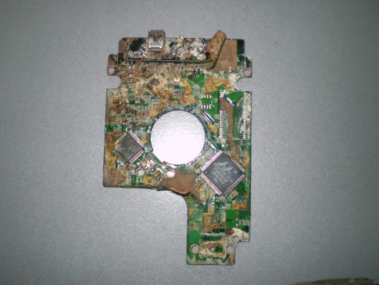

post the rest of the pictures.
the plattes
this drive will a challenge to recovery :) or maybe not ;)

The platters are fine, but I don't know where these are guard. I agree it's a challenge.

Magnetic data will be erased by temperature.
Read about curie-temperature.
No solution possible

To me drive is partially to full recoverable but there's a lot of work to do. And it would be a really expensive case.
