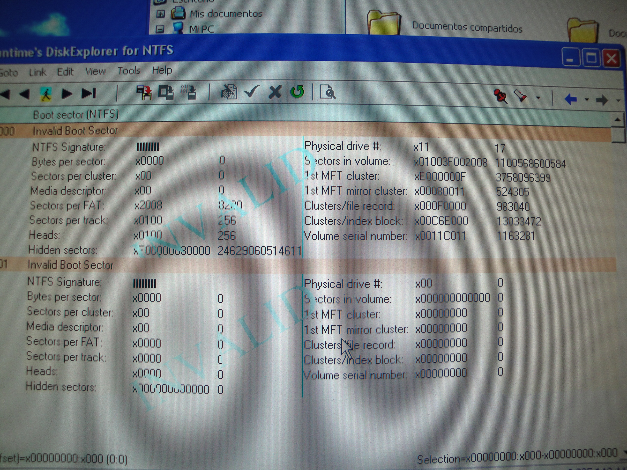

I have a disk (Fujitsu MHZ2320HZ G2) that suddenly crashed. Discarded PCB problem I went inside of it. Lucky me a friend of mine had exactly the same disc, so I did a platter exchange.
Now I'm able to see parts of files with GetDataBack but I got many CRC errors (first of them on sector 0 - never got it fixed) and also some of them make the process be halted.
Also trying to make an image of the disc (to really trash the device and work safe) it gets halted or hung! :(

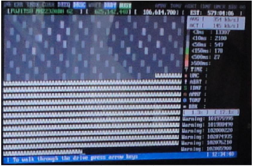

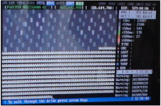

Running MHDD I have zones of delaying blocks that I'm trying to remove (or mark to be avoided by other programs), but they appear over and over again. The head sometimes gets really noisy!

Yes, MHDD passes most of them as OK and many are delaying/timeout.
The weird thing is that sometimes the same sector throws a TIMEOUT, sometimes (a few) AMNF or ABRT, and others passed fine.

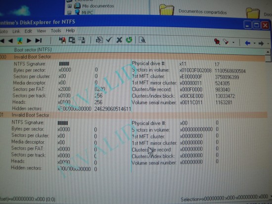

FYI, the *very first* time I connected the disc after the platter exchange, and booted with XP restore console, did a DIR and saw under C: files and directories from the 3 partitions! Also, connecting the disk via USB firstly showed me 3 partitions, unformatted.
Then started degrading. Windoze showed me just 1 partition with the full size and now doesn't shows any partitions at all, but the disk appears in the Device Manager.
Running GetDataBack many times got freezed by these reading errors, and ALWAYS (every program) gives me an error reading sectors 0-63.
Ok, I tried to avoid them and when running a partial scan I've seen a lot of

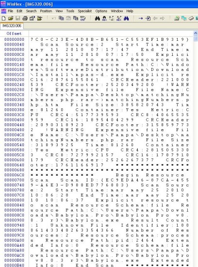

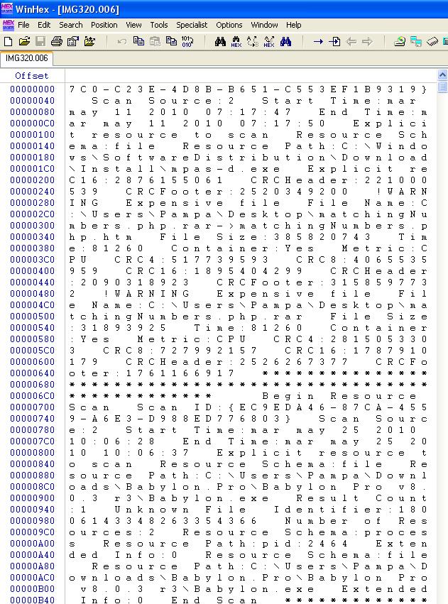

When I was able to do an image with Runtime's DiskExplorer (brother of GetDataBack) I had the 298 GB as in the above screenshot. Many many many entries related to real files!, but no content... as if the whole image were a giant file assignment table.
I have to say that I've used the strategy "skip block on bad sector found" and took about 30 hrs. Running a "retry each sector" will take 59 days :(

My goal now is to ignore completely the first 50GB of the disk (which is where the C: partition used to be, for the OS) and try to recover as most as possible the rest of the disk, ignoring the bad parts. If a file is corrupted it's fine. I'm not going to cry. :oops:
Also, FYI, the disc is giving a looooot of CRC errors, and I think that's because of the missinformation on the first part of the it, telling wrong values.

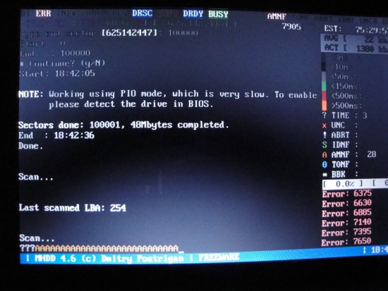

Another two screens that could help to realize what's going on.

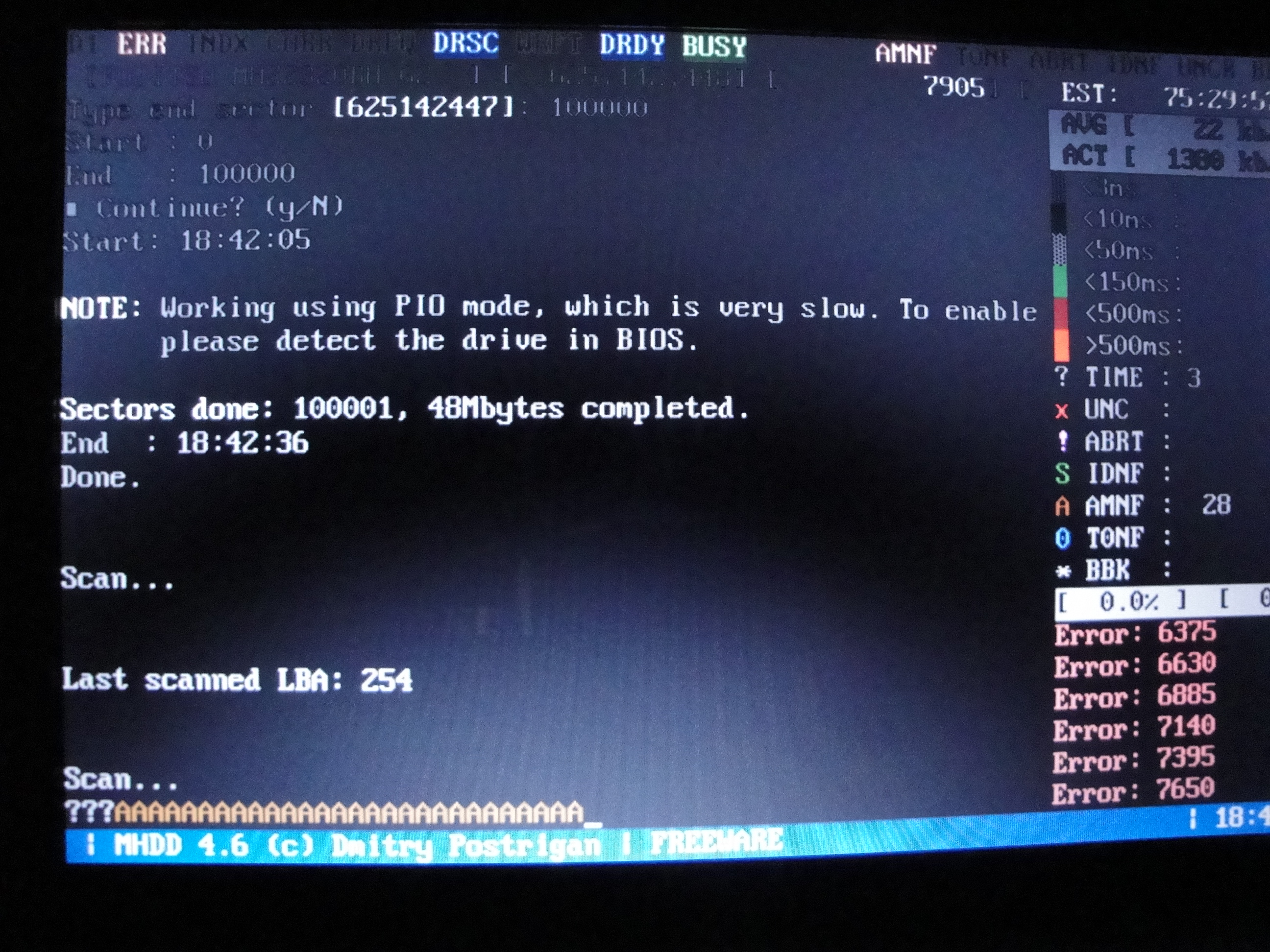

No, that was just to illustrate what happened in SCAN mode after ERASING the first 100.000 sectors.
As I said, not all the time the result is the same.
BTW, there are other parts of the disc that are getting <3ms access time, and some other real bad, however not that that happens in the first 50GB of the disc, which shouldn't hurt so much... the rest are much better.

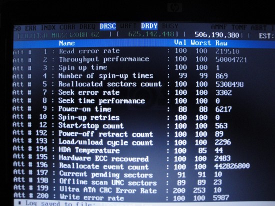

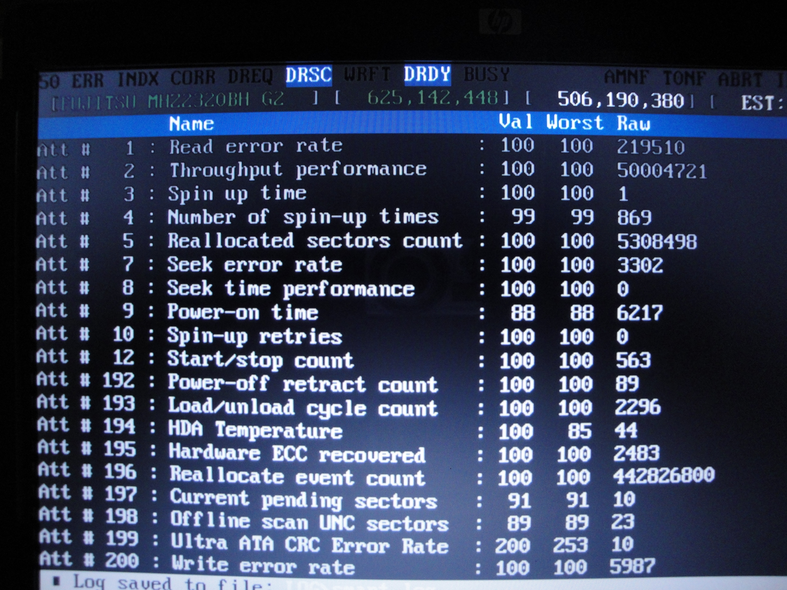

Spildit wrote:
Your realoctaion sector count is at 5308498 !!!!
You need to convert the raw value to hexadecimal. Then you will see the real number of reallocated sectors. Do the same for the reallocate event count.
That said, the normalised values don't make sense in either case.
