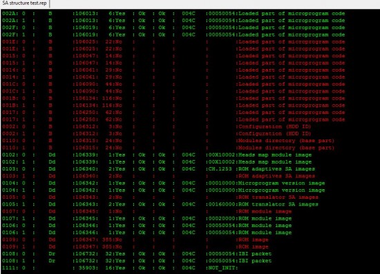

Hi to all!
Model WD2502ABYS
bads modules.
No acess data.

My problem is SA not having experience of WD. these modules a question where can I find them to write them. Or still have some function that I can access the data without having to take these modules equal to write them? how to restore the translator?
MDL: WD250ABYS-23B7A0
DCM: HGRNHV2AAN
DOM: 09 AUG 2008
Thanks!!

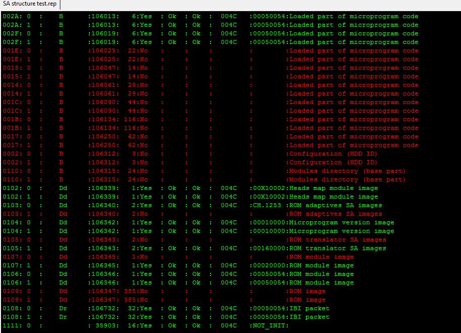

 Post subject: Re: BAD SA
PostPosted: July 15th, 2010, 8:10
Posts: 1060
HDD POSSIBLE DONOR

HDD BAD
Zone allocation table................... : HDDs RAM reading error - Device Error Detected: "VSCE PERM OVL NOT LOADED"
SA SPT.................................. : SA SPT determination error - Device Error Detected: "SERVO ERROR CODE BASE SvirADChang"
Head number reading..................... : Ok
Heads number............................ : 2
ROM:
Flash Dir reading....................... : Ok
ROM reading............................. : Ok
ROM Data size........................... : 192 Kb
ROM version............................. : 05.54B
ROM generation.......................... : 05.54B
Link table version...................... : 04.47.
Heads number in use..................... : 2
Switched off heads...................... : No
Head map................................ : 0,1
ROM Firmware version.................... : 00050054
Service area:
SA dir reading.......................... : Unknown error. Code(0)
SA Copies avalabled..................... : NONE
Configuration reading................... : Module 02 not found
SA Firmware version..................... : Module part reading error - Device Error Detected: "Unknown error. Error code: 0101"
PCB HDD BAD IN HDD DONOR
Techno mode key
Techno mode key......................... : Ok
RAM:
ROM:
Service area:
SA structure test
FAIL PCB HDD BAD? AND OR NOT ORIGINAL PCB? THERE IS THE POSSIBILITY THAT WITH THOSE SELLING LOGS?

This post is fast becoming confusing.
First screenshot shows SA structures, but recent post shows no SA available? Why do you think you need donor, what do you plan to do?
This should be a pretty simple recovery with right tools. Some overlays damaged, some other modules may need repair, or HotSwap may allow access to data if done correct.
I can not understand exactly what you are asking here?
