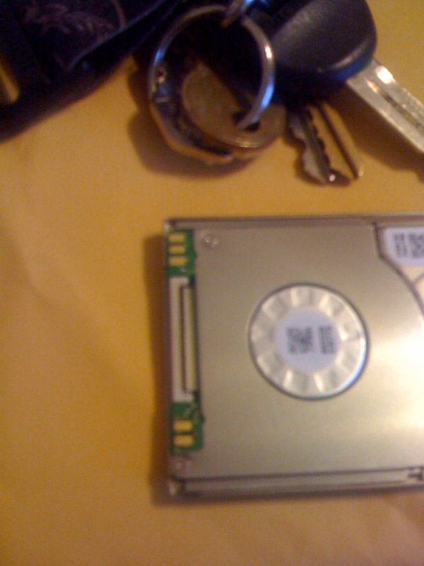

If ANYONE can help it will be a miracle. So my Dell 1210 hard drive crashed because well....it sucks. So I replaced the drive with another one that they sent me and now I am trying to recover all the files I had on the old drive. Only problem is that no one I have taken it to even knows how to retrieve data off this kind of drive. I took it to Frys, Best Buy, and a couple other places but no one can help. Stupid Dell and Samsung are completely useless for this operation and I don't want to pay a lot to get my stuff back since I have only had the computer for about 3 months. If you can just tell me the adapters I require I can probably figure the rest out myself. THANKS FOR ANY HELP POSSIBLE! - J1mbr0 (Attached is a picture of the drive. Sorry it is such crude photo but it is the best I can do right now.)

The problem is not the adapter ... Even with it if the drive itself is failing you need much more to get data. You had a replacement drive and their responsibility ends, they can't be blamed for not giving back you data you didn't backup. You could simply buy new hdd and send the drive for recovery to a serious DR company, if data was important. It's not an unknown or uncommon drive. I know, it's going to cost, but that's life...

The interface type is PATA/ZIF.

If the drive has internal problems, buying an adaptor is as useful as a tit on a bull. At least is the drive identified on post ?

Jimbro. Ur sittuation can be as easy as bad sectors on the MBR/MFT ( in that case u can get the adapter and try to clone ur drive onto a working drive , then get the data off the clone ) Or as bad as bad head(s) and or media damage ( no DIY solutions availible unfortunately )
I would strongly adivise u to find a local data recovery shop that provides free proper diagnostics ( Ontrack and I365 both do it i belive ) and see what they say / how much money they want.
