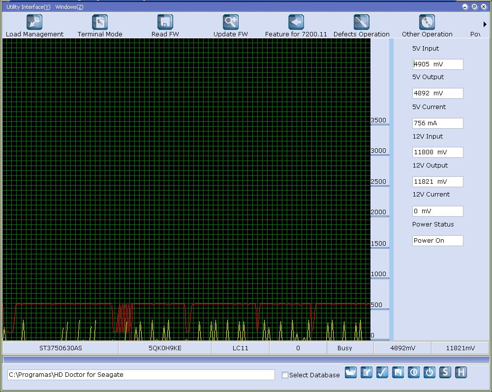

Hi
I have this disk, that was ons a USB enclosure and it fell down.
It's doing a bbzzz-bzzz, I think it's spindle (check the image of Power Situation)
Connected to the Doctor it's found, but always busy.
Tried to do the ES.2 Solution, but i get always this on terminal:
F3 T>/2
F3 2>Z
LED:000000CE FAddr:002802A1
F3 T>/2
F3 2>U
F3 T>/1
F3 1>N1
LED:000000CE FAddr:0028DFBB
What's the answer??

Whats the Firmware?
Free Solutions
 Post subject: Re: Seagate 7200.11 ST3750630AS
PostPosted: October 2nd, 2010, 12:30
Joined: July 12th, 2010, 4:38
Posts: 1459
FW: LC11
ACELab partner
PostPosted: October 2nd, 2010, 13:11
No amount of terminal jiggery-pokery is gonna fix a stuck spindle!
SD is picking up the model and s/n from the PCB.

12V current = 0 mV ?????
PostPosted: October 3rd, 2010, 2:09
Clean room work required...
lol SD's trying to say 0 mA on 12 volt
PostPosted: October 3rd, 2010, 5:12
Joined: October 20th, 2009, 18:25
Posts: 58
Location: Tehran/Iran
sometimes means HDD IS eat up high current
from power output of the device
(damage old and out of spec resistors or stuck / weak motors,...) .
It suppose to cut of power as a protection measure
usually the controller IC runs very hot in this case
however the drive may still work supplying enough current
if not stuck depending on situation.
