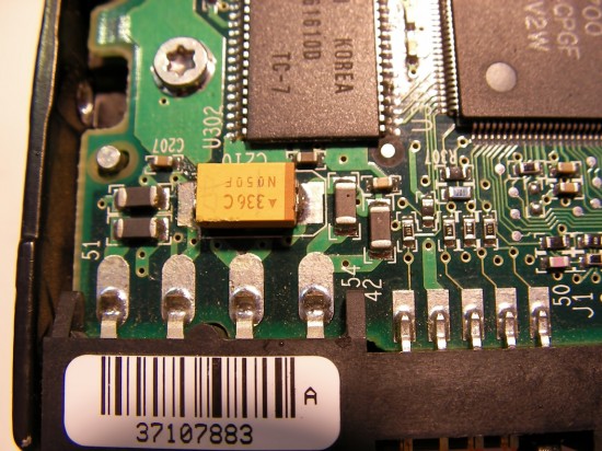

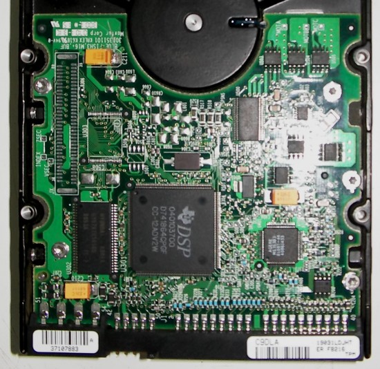

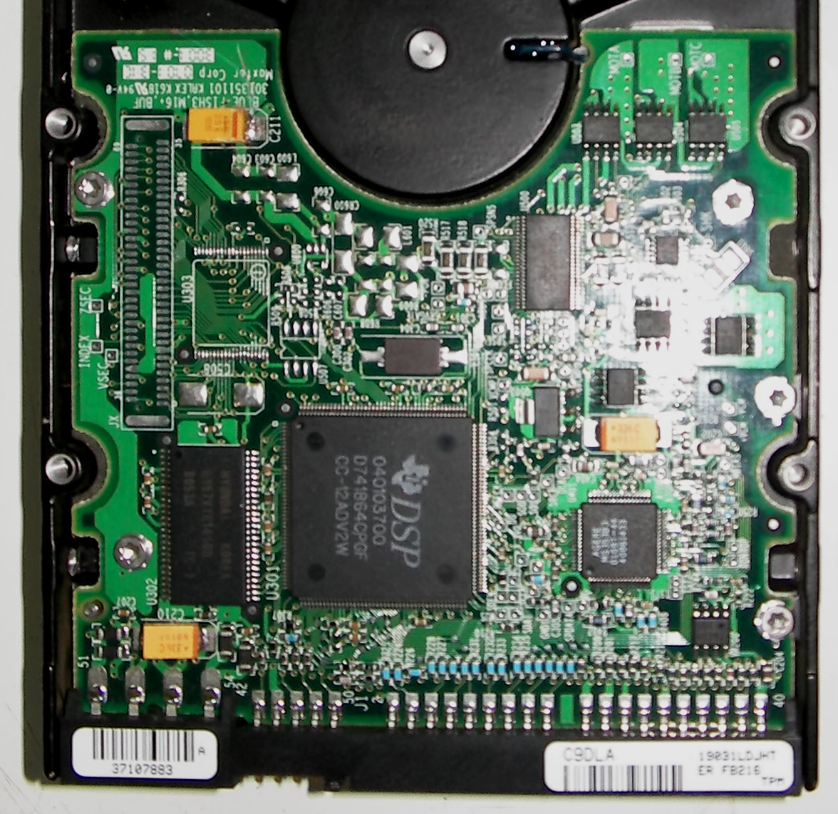

the drive was functioning normal (no anormal noises, slows down or errors)
it was removed from the computer, and installed on another PC, i believe they connected the power in the wrong direcction, or connected while the PC was turned ON.
now the drive does not spin at all, it isn't getting detected by the bios too, it's a brick
i'm assuming that is a TVS diode that needs to be removed, so i can work the drive to get the data, but i don't know how to locate the TVS on the PCB.
can anybody help me?
MAXTOR 20gb
Diamondmax VL 40
model: 32049H2

I guess it is 54 and 42 near the power connector.

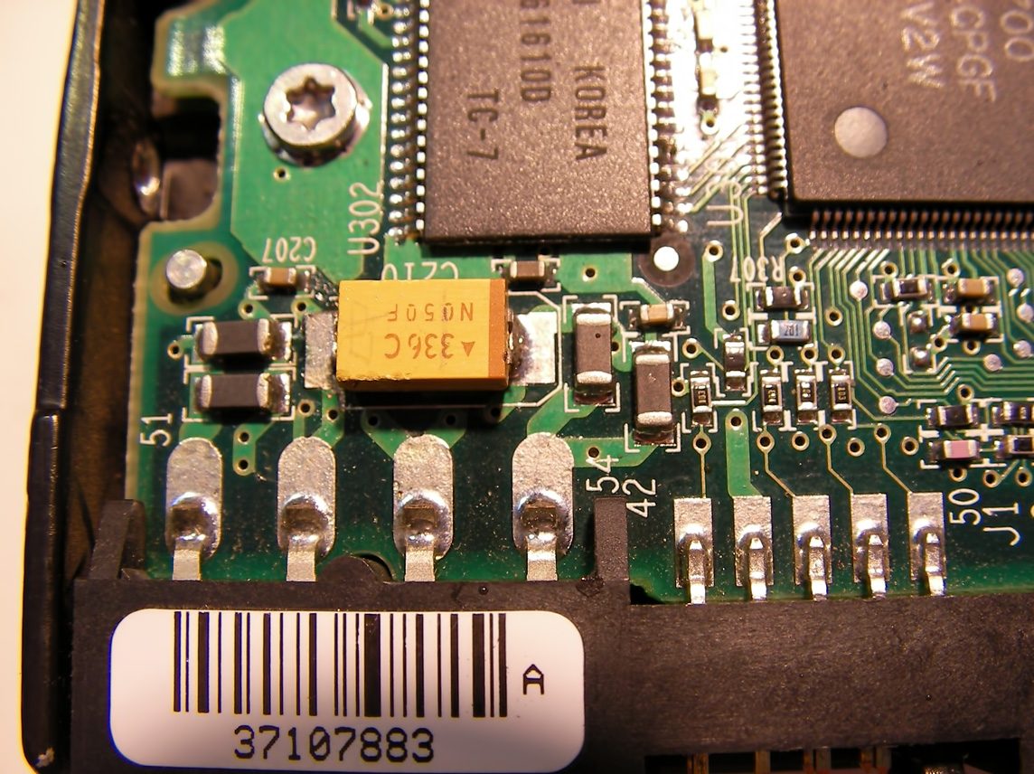

here is a close-up image of that area,
any other opinion? anyone could confirm or correct?

This drive have no TVS.
 Post subject: Re: help to locate TVS on maxtor
PostPosted: November 11th, 2010, 13:56
Posts: 1721
Not all drives have TVS like NC has said on this one. Do not remove what edsel said you will be sorry. This is an older maxtor with a DSP chip on it. You can have this one done really simply if there is no other damage to it by a DR company. They should be able to help you out on this one and get your data back on it. If yuo do not have problem with the preamp on it I am sure this should not be too hard of a job if you take it to a DR company in Chilie to have this done for you. They have the knowledge and tools to fix this and get off your data.

a PCB swap will work on this drive?
the donor drive has to be the exact model?
C9DLA code needs to be match on the PCB side, and the 4 letter code on the TOP cover, this way: M,?,?,M
PostPosted: November 11th, 2010, 17:50
Posts: 17238
54 and 42 appear to be inductors (or low ohm resistors?). They both look like they have been pinholed. Check their resistances on the 200 ohms range of a multimeter.

both shows 00.4 with 200ohm
They're OK then. There's 51 on the other rail, but it looks OK. Sorry, I don't know what else to suggest.
