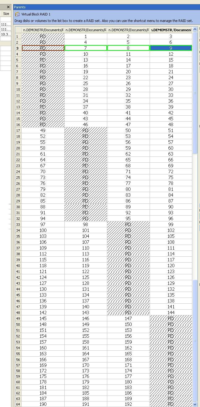

Thanks to a power spike around two weeks ago two out of four hdds in my server raid5 array died, i found a guy that was able to bring one of them back to life, but array didnt recognise it properly.
So atm, im trying to recover data from 3 out of 4 drives.
Server was configured by hp and it had standart raid configuration. Serwer model: Hp AIO 400r.
So atm, im struggling with guessing correct configuration,(i tried ZAR but it appears to hang @ 100% of quick identifing of data)
I tried R-Studio but resources on hp configurations of arrays are extremly limited. Scan of the virtual raid returns viewable files.
(Yes, i know what im doing, and yes the data is extremly important)
Can anyone help me out finding out the proper configuration for r-studio? (or sharing other suggestions ofc)

The E200 and P400 are LSI chipsets and don't follow the delayed parity rotation of the typical SmartArrays. RAID controller metadata is on the back. Search for keywords HPSA_RIS and the first hex character of that sector will spell out the order of each drive.
First off it's a Forward parity rotation usually 128 sectors starting at sector zero and not 1088. Also, partity starts on the second component and not the first.
This is the best Intel i was able to find on google [http://www.x-ways.net/winhex/forum/messages/174/2987.html?1280356762]
But i dont know how this translates to r-studio?

Ok, I studied some literature on the subject and so far i understand that this parity would look like this:
P1-01-02-03
P2-04-05-06
P3-07-08-09
P4-10-11-12
15-P2-14-13
16-P2-17-18
19-P2-xx-xx
This how forward async delayed parity with 4 stripes delay would look like I guess?
Hmmm, now I think i understand the second component parity
01-P1-02-03
04-P1-05-06
07-P1-08-09
10-P1-11-12
13-14-P2-15
ETC...
 Post subject: Re: RAID5 - HP Smart Array E200, failed drive.
PostPosted: November 24th, 2010, 16:07
Joined: November 24th, 2010, 10:08
Posts: 14
I dunno why i can't edit my previous posts...
In the end I think the order would look like this:
HDD1-HDD2-HDD3-HDD4
01-P0-02-03
04-P1-05-06
07-P2-08-09
10-P3-12-13
14-15-P4-16
17-18-P5-19
20-21-P6-22
23-24-P7-25
Does it make any sense?
Since it starts at sector 0 instead of 1088 this would mean this raid has no header... Seems like tomorrow is a hex day :/

I tried my own preset for r-studio assuming that delay = 4:

But it didn't work :P now im about to try delay = 8 gahh

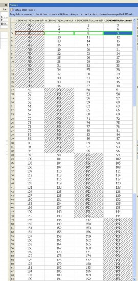

Okey, imteresting things came out when I made xml for Forward parity rotation usually starting on the second component, scan looks more like a regular hdd ....

Ok, gurus so far i got no real progress, but i found that each 8 sectors RCRD tag appears in asci, I got a wild guess this can be some kind of stripe marker and this would mean that stripe size is 4kb, whats more this tag appears on 0 sector on 2nd hdd just like that guy on x-ray forums suggested. Can any one confim this?
01-P1-02-03
04-P1-05-06
07-P1-08-09
10-P1-11-12
13-14-P2-15
ETC...
You are on right way, but still a lot mistakes :wink:
For forward delayd parity it should look like this:
  </RAID>
<RAID blockSize="65536" name="Smartv2" parents="4" rows="4">
<Table>
  <Block id="A1">1</Block>
  <Block id="B1" sequence="1">XorOfData</Block>
  <Block id="C1">2</Block>
  <Block id="D1">3</Block>
  <Block id="A2">4</Block>
  <Block id="B2">5</Block>
  <Block id="C2" sequence="3">XorOfData</Block>
  <Block id="D2">6</Block>
  <Block id="A3">7</Block>
  <Block id="B3">8</Block>
  <Block id="C3">9</Block>
  <Block id="D3" sequence="4">XorOfData</Block>
  <Block id="A4" sequence="2">XorOfData</Block>
  <Block id="B4">10</Block>
  <Block id="C4">11</Block>
  <Block id="D4">12</Block>
  </Table>
<Sequences>
  <Sequence id="1">B1 C2 D3</Sequence>
  <Sequence id="2">A4</Sequence>
  <Sequence id="3">C2</Sequence>
  <Sequence id="4">D3</Sequence>
  </Sequences>
  </RAID>
  </RAIDList>
I hope it will help you, take this :D :
<RAIDList>
<RAID blockSize="16384" name="RAIDLayoutHP_Forward4D" parents="4" rows="64">
<Table>
<Block id="A1">XorOfData</Block>
<Block id="B1">1</Block>
<Block id="A2">XorOfData</Block>
<Block id="B2">4</Block>
<Block id="C2">5</Block>
<Block id="A3">XorOfData</Block>
<Block id="B3">7</Block>
<Block id="C3">8</Block>
<Block id="D3">9</Block>
<Block id="A4">XorOfData</Block>
<Block id="A5">XorOfData</Block>
<Block id="B5">13</Block>
<Block id="C5">14</Block>
<Block id="D5">15</Block>
<Block id="A6">XorOfData</Block>
<Block id="B6">16</Block>
<Block id="C6">17</Block>
<Block id="D6">18</Block>
<Block id="A7">XorOfData</Block>
<Block id="B7">19</Block>
<Block id="C7">20</Block>
<Block id="D7">21</Block>
<Block id="A8">XorOfData</Block>
<Block id="B8">22</Block>
<Block id="C8">23</Block>
<Block id="D8">24</Block>
<Block id="A9">XorOfData</Block>
<Block id="B9">25</Block>
<Block id="C9">26</Block>
<Block id="D9">27</Block>
<Block id="A10">XorOfData</Block>
<Block id="B10">28</Block>
<Block id="C10">29</Block>
<Block id="D10">30</Block>
<Block id="A11">XorOfData</Block>
<Block id="B11">31</Block>
<Block id="C11">32</Block>
<Block id="D11">33</Block>
<Block id="A12">XorOfData</Block>
<Block id="B12">34</Block>
<Block id="C12">35</Block>
<Block id="D12">36</Block>
<Block id="A13">XorOfData</Block>
<Block id="B13">37</Block>
<Block id="C13">38</Block>
<Block id="D13">39</Block>
<Block id="A14">XorOfData</Block>
<Block id="B14">40</Block>
<Block id="C14">41</Block>
<Block id="D14">42</Block>
<Block id="A15">XorOfData</Block>
<Block id="B15">43</Block>
<Block id="C15">44</Block>
<Block id="D15">45</Block>
<Block id="A16">XorOfData</Block>
<Block id="B16">46</Block>
<Block id="C16">47</Block>
<Block id="D16">48</Block>
<Block id="A17">49</Block>
<Block id="B17">XorOfData</Block>
<Block id="C17">50</Block>
<Block id="D17">51</Block>
<Block id="A18">52</Block>
<Block id="B18">XorOfData</Block>
<Block id="C18">53</Block>
<Block id="D18">54</Block>
<Block id="A19">55</Block>
<Block id="B19">XorOfData</Block>
<Block id="C19">56</Block>
<Block id="D19">57</Block>
<Block id="A20">58</Block>
<Block id="B20">XorOfData</Block>
<Block id="C20">59</Block>
<Block id="D20">60</Block>
<Block id="A21">61</Block>
<Block id="B21">XorOfData</Block>
<Block id="C21">62</Block>
<Block id="D21">63</Block>
<Block id="A22">64</Block>
<Block id="B22">XorOfData</Block>
<Block id="C22">65</Block>
<Block id="D22">66</Block>
<Block id="A23">67</Block>
<Block id="B23">XorOfData</Block>
<Block id="C23">68</Block>
<Block id="D23">69</Block>
<Block id="A24">70</Block>
<Block id="B24">XorOfData</Block>
<Block id="C24">71</Block>
<Block id="D24">72</Block>
<Block id="A25">73</Block>
<Block id="B25">XorOfData</Block>
<Block id="C25">74</Block>
<Block id="D25">75</Block>
<Block id="A26">76</Block>
<Block id="B26">XorOfData</Block>
<Block id="C26">77</Block>
<Block id="D26">78</Block>
<Block id="A27">79</Block>
<Block id="B27">XorOfData</Block>
<Block id="C27">80</Block>
<Block id="D27">81</Block>
<Block id="A28">82</Block>
<Block id="B28">XorOfData</Block>
<Block id="C28">83</Block>
<Block id="D28">84</Block>
<Block id="A29">85</Block>
<Block id="B29">XorOfData</Block>
<Block id="C29">86</Block>
<Block id="D29">87</Block>
<Block id="A30">88</Block>
<Block id="B30">XorOfData</Block>
<Block id="C30">89</Block>
<Block id="D30">90</Block>
<Block id="A31">91</Block>
<Block id="B31">XorOfData</Block>
<Block id="C31">92</Block>
<Block id="D31">93</Block>
<Block id="A32">94</Block>
<Block id="B32">XorOfData</Block>
<Block id="C32">95</Block>
<Block id="D32">96</Block>
<Block id="A33">97</Block>
<Block id="B33">98</Block>
<Block id="C33">XorOfData</Block>
<Block id="D33">99</Block>
<Block id="A34">100</Block>
<Block id="B34">101</Block>
<Block id="C34">XorOfData</Block>
<Block id="D34">102</Block>
<Block id="A35">103</Block>
<Block id="B35">104</Block>
<Block id="C35">XorOfData</Block>
<Block id="D35">105</Block>
<Block id="A36">106</Block>
<Block id="B36">107</Block>
<Block id="C36">XorOfData</Block>
<Block id="D36">108</Block>
<Block id="A37">109</Block>
<Block id="B37">110</Block>
<Block id="C37">XorOfData</Block>
<Block id="D37">111</Block>
<Block id="A38">112</Block>
<Block id="B38">113</Block>
<Block id="C38">XorOfData</Block>
<Block id="D38">114</Block>
<Block id="A39">115</Block>
<Block id="B39">116</Block>
<Block id="C39">XorOfData</Block>
<Block id="D39">117</Block>
<Block id="A40">118</Block>
<Block id="B40">119</Block>
<Block id="C40">XorOfData</Block>
<Block id="D40">120</Block>
<Block id="A41">121</Block>
<Block id="B41">122</Block>
<Block id="C41">XorOfData</Block>
<Block id="D41">123</Block>
<Block id="A42">124</Block>
<Block id="B42">125</Block>
<Block id="C42">XorOfData</Block>
<Block id="D42">126</Block>
<Block id="A43">127</Block>
<Block id="B43">128</Block>
<Block id="C43">XorOfData</Block>
<Block id="D43">129</Block>
<Block id="A44">130</Block>
<Block id="B44">131</Block>
<Block id="C44">XorOfData</Block>
<Block id="D44">132</Block>
<Block id="A45">133</Block>
<Block id="B45">134</Block>
<Block id="C45">XorOfData</Block>
<Block id="D45">135</Block>
<Block id="A46">136</Block>
<Block id="B46">137</Block>
<Block id="C46">XorOfData</Block>
<Block id="D46">138</Block>
<Block id="A47">139</Block>
<Block id="B47">140</Block>
<Block id="C47">XorOfData</Block>
<Block id="D47">141</Block>
<Block id="A48">142</Block>
<Block id="B48">143</Block>
<Block id="C48">XorOfData</Block>
<Block id="D48">144</Block>
<Block id="A49">145</Block>
<Block id="B49">146</Block>
<Block id="C49">147</Block>
<Block id="D49">XorOfData</Block>
<Block id="A50">148</Block>
<Block id="B50">149</Block>
<Block id="C50">150</Block>
<Block id="D50">XorOfData</Block>
<Block id="A51">151</Block>
<Block id="B51">152</Block>
<Block id="C51">153</Block>
<Block id="D51">XorOfData</Block>
<Block id="A52">154</Block>
<Block id="B52">155</Block>
<Block id="C52">156</Block>
<Block id="D52">XorOfData</Block>
<Block id="A53">157</Block>
<Block id="B53">158</Block>
<Block id="C53">159</Block>
<Block id="D53">XorOfData</Block>
<Block id="A54">160</Block>
<Block id="B54">161</Block>
<Block id="C54">162</Block>
<Block id="D54">XorOfData</Block>
<Block id="A55">163</Block>
<Block id="B55">164</Block>
<Block id="C55">165</Block>
<Block id="D55">XorOfData</Block>
<Block id="A56">166</Block>
<Block id="B56">167</Block>
<Block id="C56">168</Block>
<Block id="D56">XorOfData</Block>
<Block id="A57">169</Block>
<Block id="B57">170</Block>
<Block id="C57">171</Block>
<Block id="D57">XorOfData</Block>
<Block id="A58">172</Block>
<Block id="B58">173</Block>
<Block id="C58">174</Block>
<Block id="D58">XorOfData</Block>
<Block id="A59">175</Block>
<Block id="B59">176</Block>
<Block id="C59">177</Block>
<Block id="D59">XorOfData</Block>
<Block id="A60">178</Block>
<Block id="B60">179</Block>
<Block id="C60">180</Block>
<Block id="D60">XorOfData</Block>
<Block id="A61">181</Block>
<Block id="B61">182</Block>
<Block id="C61">183</Block>
<Block id="D61">XorOfData</Block>
<Block id="A62">184</Block>
<Block id="B62">185</Block>
<Block id="C62">186</Block>
<Block id="D62">XorOfData</Block>
<Block id="A63">187</Block>
<Block id="B63">188</Block>
<Block id="C63">189</Block>
<Block id="D63">XorOfData</Block>
<Block id="A64">190</Block>
<Block id="B64">191</Block>
<Block id="C64">192</Block>
<Block id="D64">XorOfData</Block>
</Table>
</RAID>
</RAIDList>
