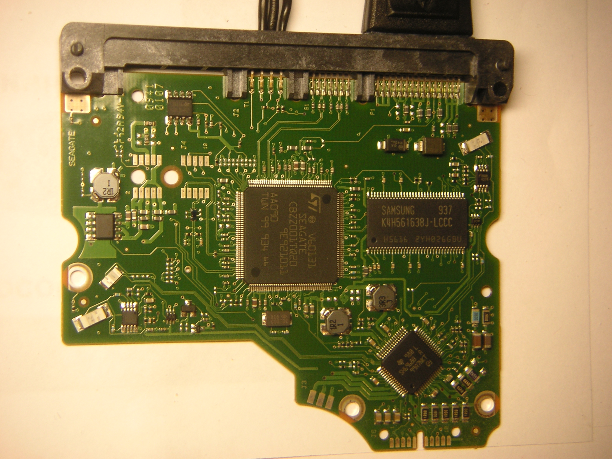

ththeod, I think you need to check your PCB first.
 Post subject: Re: Seagate baracuda LP ST31500541AS stuck on BSY
PostPosted: December 30th, 2010, 6:37
Posts: 1752
Check if you PCB is native.
Then if it is, you can try to follow up unlock procedure, but you must short the read channel.

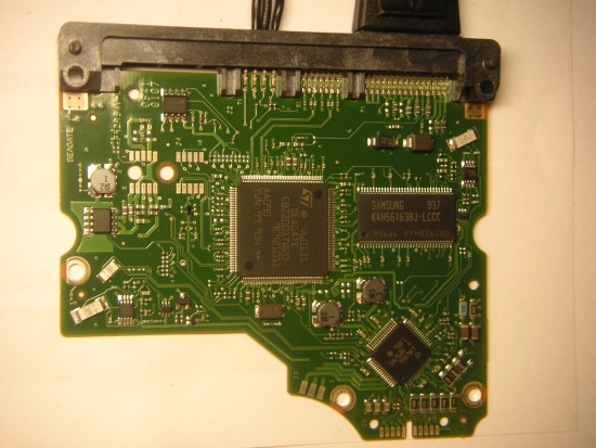

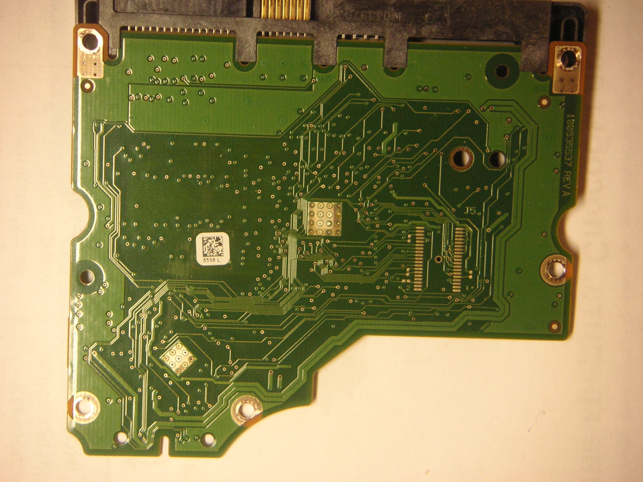

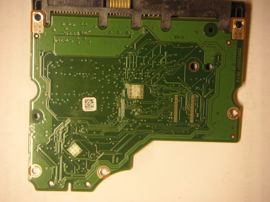

So, crtl+Ζ works, it is needed just to press right after Rst 0x20M, before (P) SATA Reset
BIOS can not recognise HDD, and it does not continue booting, if HDD attached, it gets stuck trying to detect HDD.
Here is the pictures of PCB
File comment: PCB
File comment: PCB
