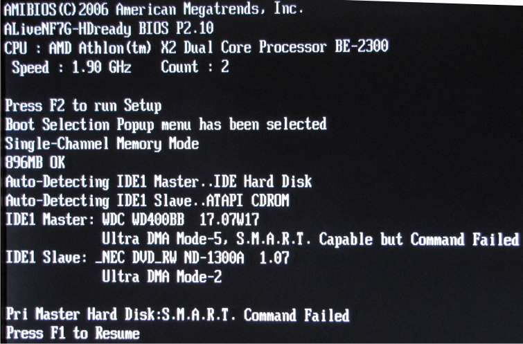

I've just found my old, broken WD400BB hard drive and thought I'd give it a try.
The hard drive spins up, gets recognised by the bios and the operating system but sadly that's all it does. When trying to read data from the device in Linux I wound up with about 40GBs of zeros (there is something else at the start of the file, I can't make out what it is, though).
File comment: Bios recognising the hard drive

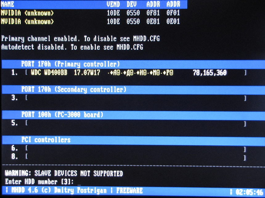

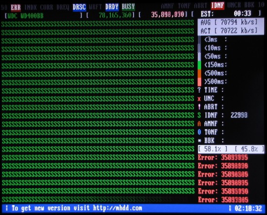

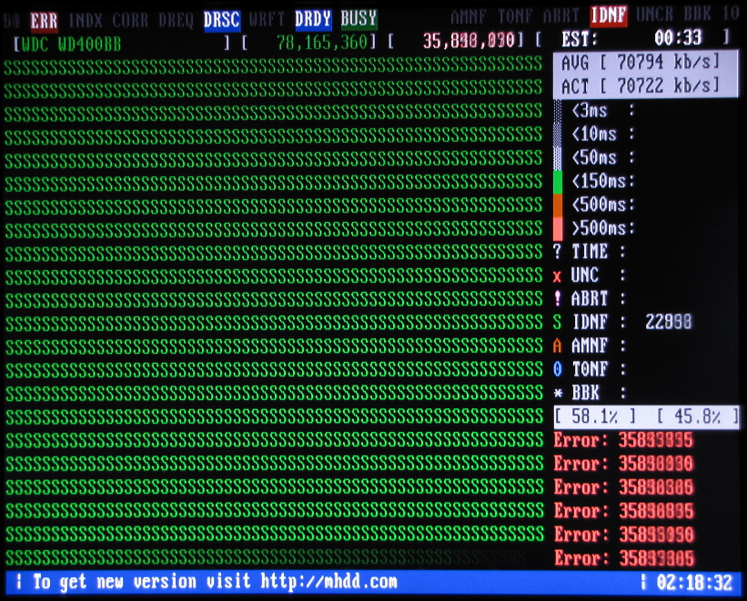

Afterwards I hooked it up to an IDE port of another machine and gave MHDD a run. S.M.A.R.T. isn't working and MHDD generates "S" errors only. I've attached 3 pictures of the bios and MHDD recognising the hard drive. I also attached a picture of the errors shown in MHDD.

File comment: MHDD errors

I'm new to all this hard drive repairing stuff and to this forum and just trying to provide you with as much information I can get. Can you make any useful assumptions out of this? The MHDD FAQ says, that in case MHDD reports 100% bad blocks "it is either a head crash, pcb damage or firmware issue".

Probably translator problem, U need pro help.
"no user servicable parts inside" :)

It's a PCB and Translator problem I think.
The drive not recognized correctly.
replace PCB and free HDD_Repair software may solve your problem

I wouldn't think it's a PCB probem at ll, it's almost certainly a translator issue like pepe says IMHO.
Doubtfull HDD_Repair would be able to fix this, use this at your peril.
If you just want to repair the drive then by all means give it a whirl, but if you need the data then do not attempt the repair yourself.
