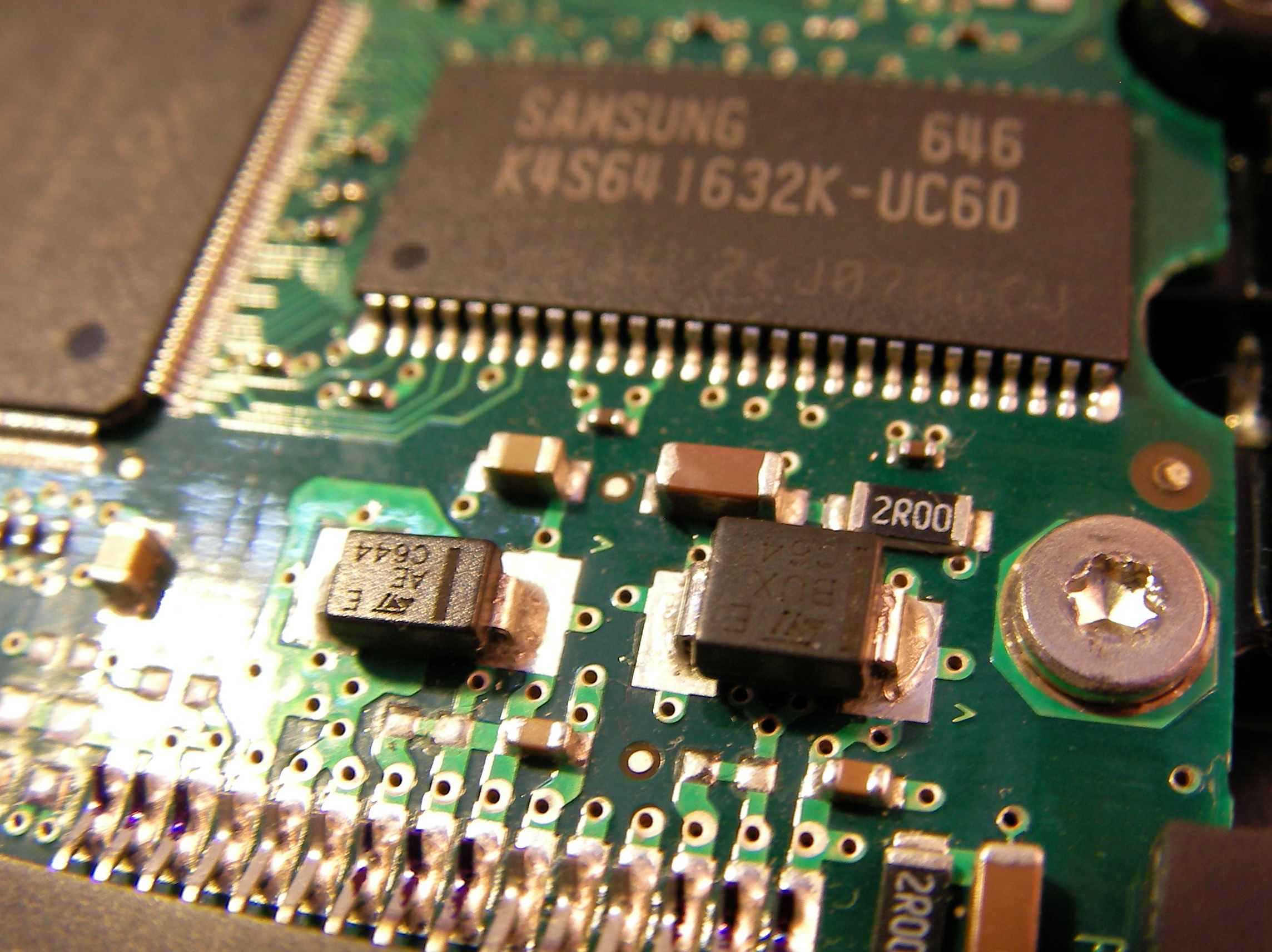

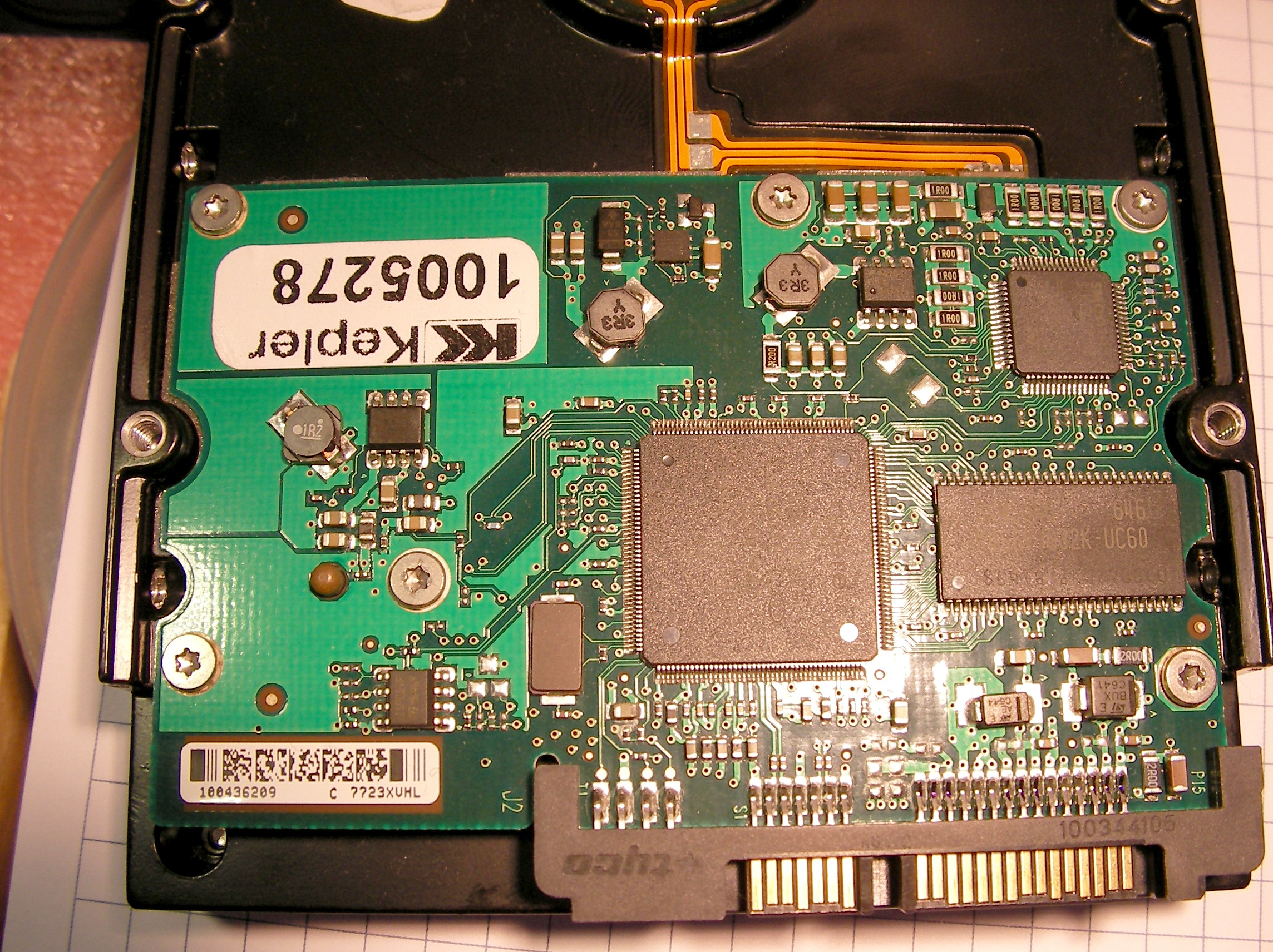

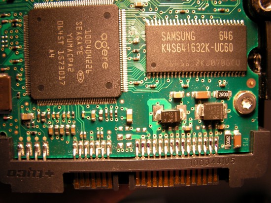

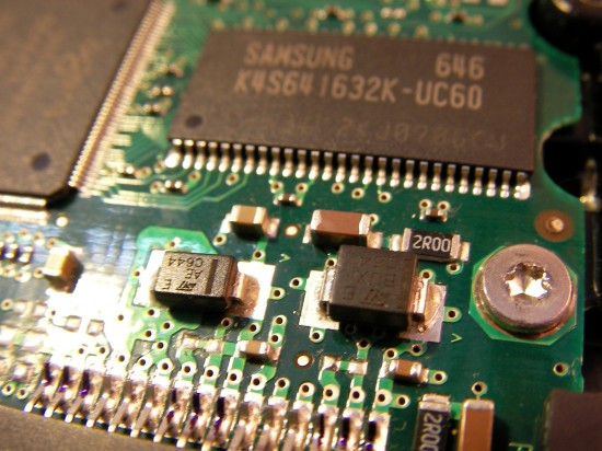

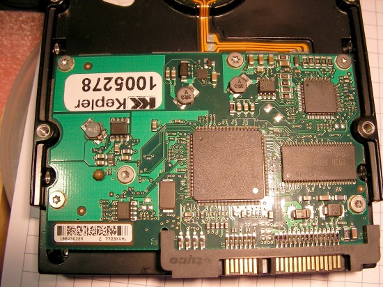

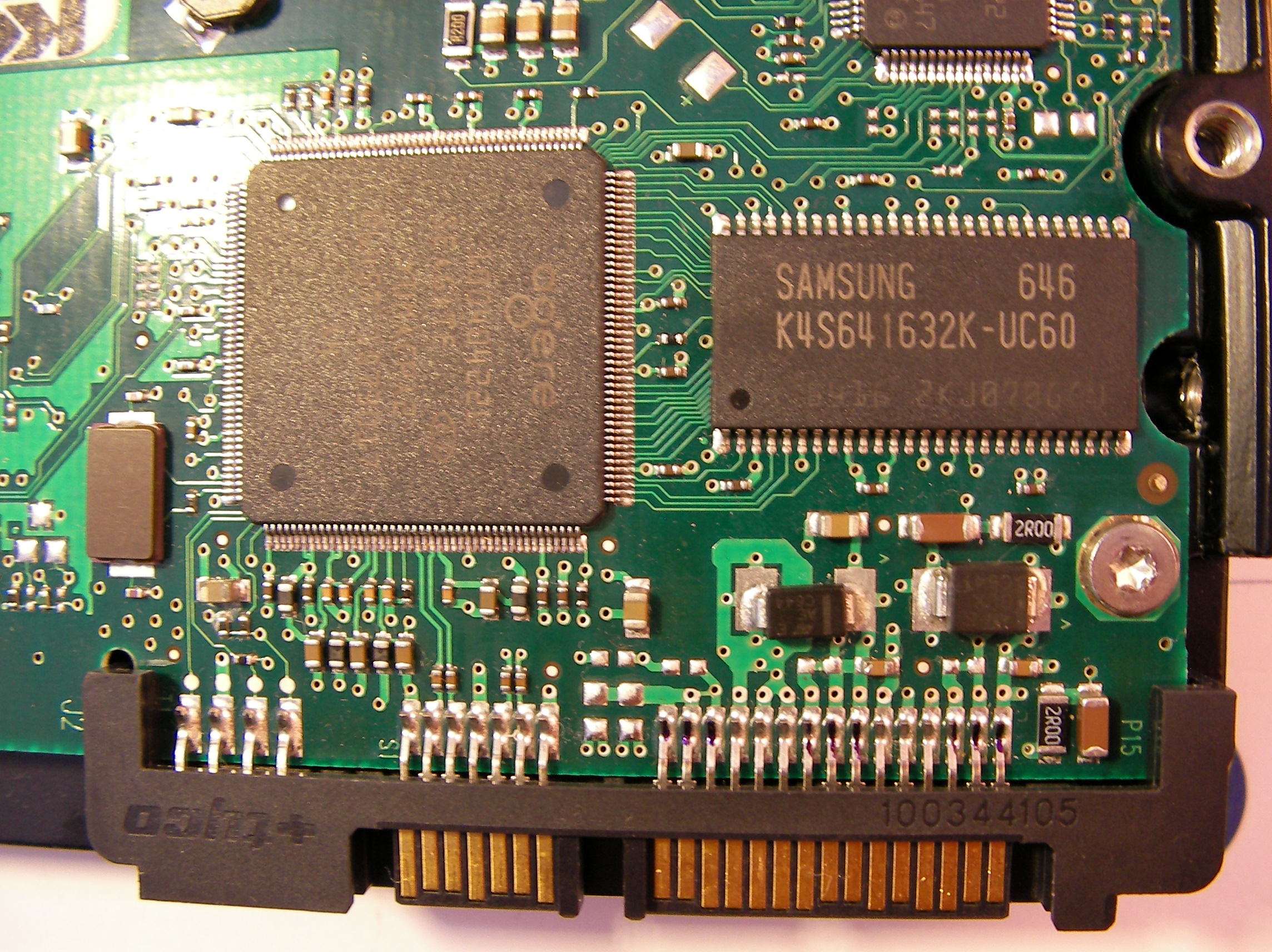

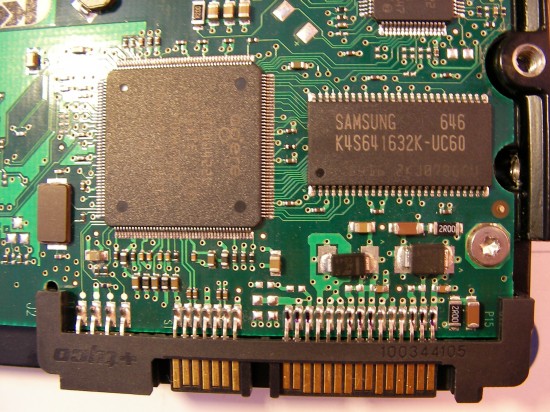

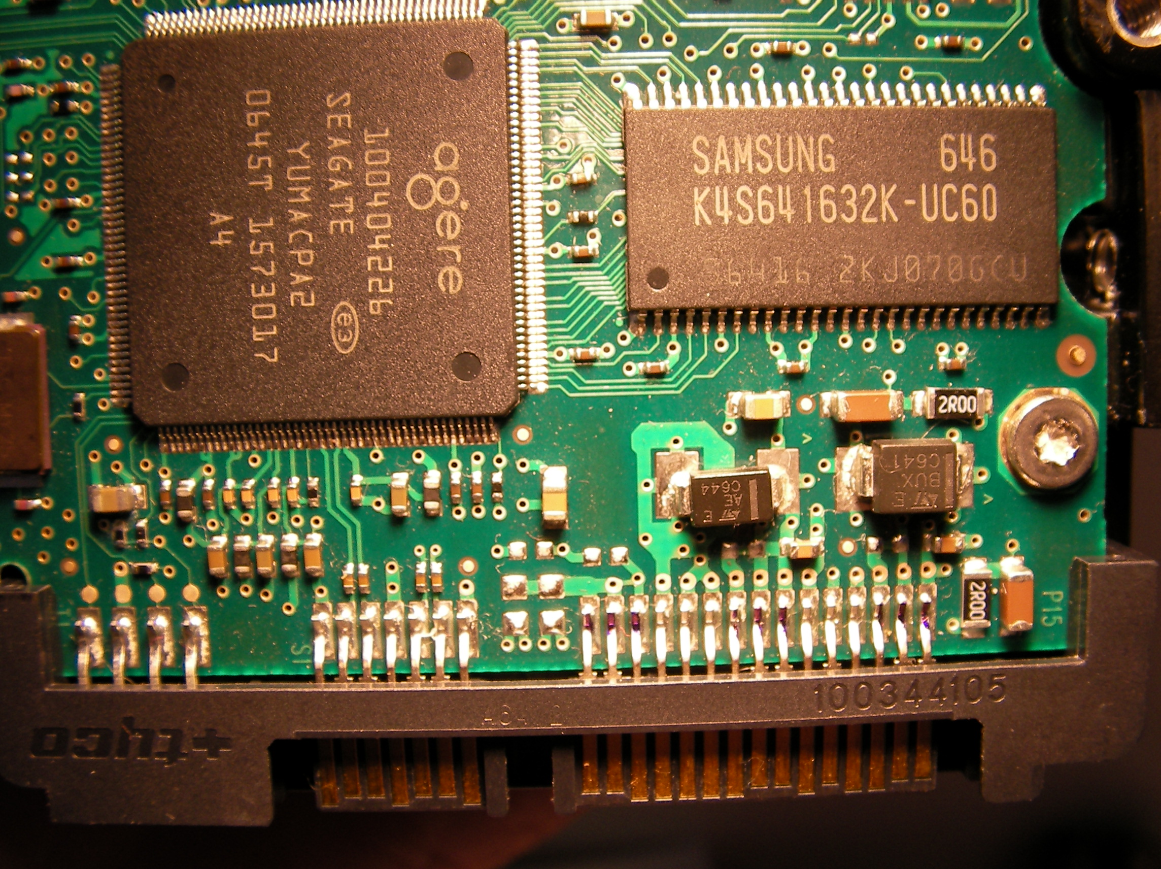

i have an ST3250820AS
was functioning without problems
after a power faliure it died, no spin up, no noises, no signals of power, a brick
it can't see any burned or damaged component
i tested the both TVS with a multimeter reading resistance in 200 ohm, in forward and reverse direction
obtaining a reading of "1" in all tests
does that "mean" that the TVS are in good or bad condition?
what other tests are recommended?
should i remove the TVS?
please comment

Judging by the sticker on the PCB, have you already sent this drive for recovery? What is the history of this drive?

poehere wrote:
Search function you will find all your answers on this one. Hint Franc or TVS and you will get all that you are asking for now on it
i already search, and read sveral posts, but the readings im getting on the TVS, dont fit on what i've read.
for this reason im recurring this forum, to get some advice from the most experienced people

i removed both tvs
the disk still show no spin up
but now the drive get a little warm in the sides (the disk area), and the bios get some time (as it was trying to detect the drive) but finally dont detect nothing

logix wrote:
i removed both tvs
You found your anawer it is not TVS. It is internal to your HDD. You do not have much chance now to fix it and this needs clean room work on it. Seems you have gone as far as you can on this one right now. Your problem is elsewhere now

A reading of "1" is indicating "overrange". It is the same reading you see when you hold the probes apart, ie an open circuit. A short circuit is when you touch the probe tips together.
If it's just a board fault, then try the following vendor:
http://www.onepcbsolution.com/
His price is US$40, plus $10 for a ROM transfer. The ROM transfer involves moving the 8-pin serial flash memory chip from patient to donor. This chip stores unique, drive specific information. It is located near the PCB label, and has a "25" in the part number.
BTW, I am not associated with any supplier.
