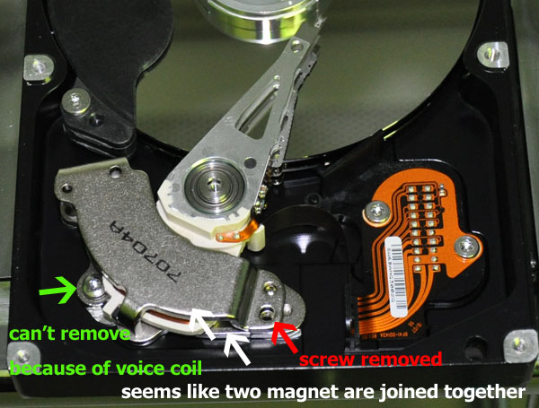

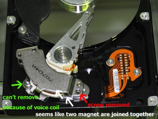

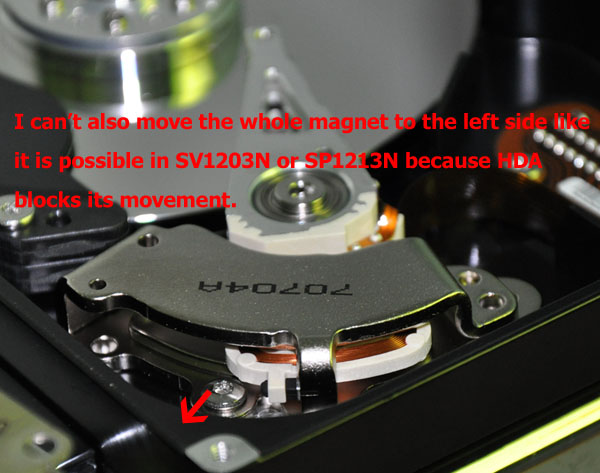

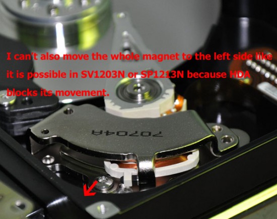

I've got HD321KJ and need to perform a head swap.
I've encountered problem during removing the magnet, I am not exactly sure which way it shall be removed ?
Please see attachment, I've took 2 photos showing magnet view.
In the past I've successfully made head swap in SV1203N and SP1213N, in these HDD's the magnet was not splitted to top or bottom magnet - it was one part. So I had to remove it carefully moving the whole thing to the left side.
But in this case the HDA is blocking its movement to the left side.
I don't want to use force at the moment, so if anybody has got an advice of how to do it I will appreciate any comments.
Thanks in advance,
File comment: HD321KJ magnet view

just tell me if in this model there is installed one magnet like in SV1203N, etc. ?
or are there two magnets ? (top and bottom) ?

There are always 2 magnets.

in fact You are right, but I mean if there is a situation like here, please take a look to this movie (03:17)
http://www.youtube.com/watch?v=Q9AoMeHRIPU
Of course there are 2 magnets, but the bottom and top part are connected together, so while removing it, the magnet looks like one part.
My magnet exchanger tool from Salvation Data couldn't handle it, I had to lever it up with another tool, and I removed it successfully. Thanks for help guys.

There are 2 magnets. It's like a Seagate magnets(not exactly the same, of course, but similar)
