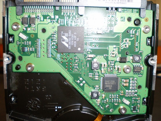

hi to all
i have the above drive that was mounted in an external casing. Drive will power up and spin but not be detected in bios.
Looking at the external drive casing it came from there appears to be a burn mark right where the 2 protection diodes are on the board. the diodes measure ok and i can see no pysical marking to indicate an burns on pcb.
i want to begin by swapping boards to test and see what happens but am not sure if the rom is built in the main chip or not, there is a small 8 pin ic which i think may be the rom but an not sure.
can anyone please clarify if this is the case
picture included.
thank you

Nope, that looks like a transistor / driver array, definitely NOT EEPROM.
I suspect the ROM info is masked in the CPU.

just swapped boards and the patient board works fine on the donor drive, will look at heads now as there is a clicking sound from drive
thx for reply
 Post subject: Re: Samsung HD103UI
PostPosted: March 30th, 2009, 2:30
ROM is inside the Marvell CPU. Look at heads...
