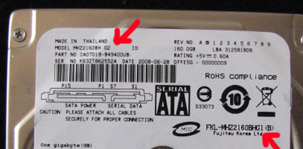

Hello guys,
want to ask You a question related to MHZ2160BH disk, there is a G1 and G2 version.
Does anybody know if PCB in these two models are interchangeable ?
I've got MHZ2160BH G1, it's hard to find the exact donor with matching firmware, I found the G2 version with the same firmware and I am curious if can I use its PCB to verify if the damage is related to PCB?

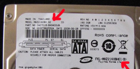

By the way, a propos the MHZ2160BH G2 version, please take a look to the picture below.
There is a weird nomenclature on the label - I marked it in red.
Thanks in advance for reply.
File comment: On the label there are two different models name written. Does anybody know why ?

VoodooPL wrote:
Hello guys,
Yes, for this model they are. You can use it to check if PCB is at fault.
