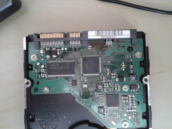

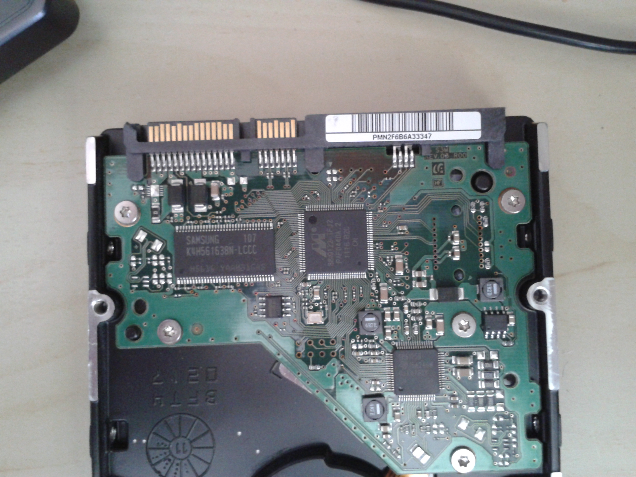

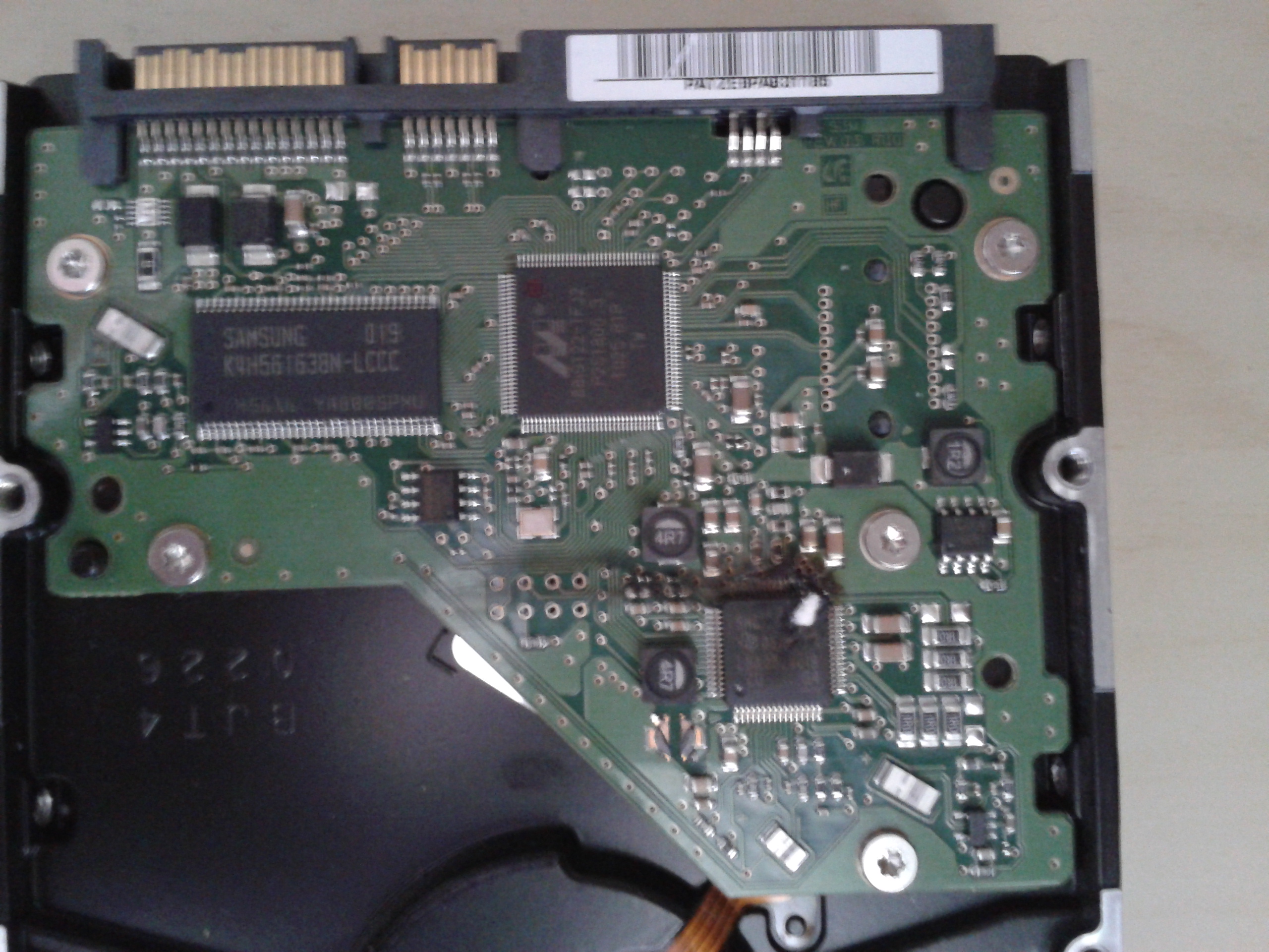

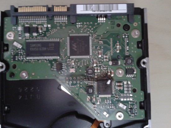

I am hoping you have an answer for me that will help.
I have 2 2tb Samsung drives, 1 of them has the PCB that has a burned out motor controller chip (i think) and i need to get the data from it if i can - the 2nd drive is identical apart from one of the components says 4R7E instead of 4R7, i am not sure if it makes a difference because i don't know what it is.
if i try and swap over the boards all i get is a kind of beeping sound as if the heads are trying to spin up but cant.
Thanks in advance
Nathan

Just for viewing pleasure i am attaching the images of the pcbs.

Those components are identical. From what you describe i would say stiction. Probably not DIY.

Are you prepared to pay for professional services? If not, and if the only alternative is to throw the drive away, then try some "percussive maintenance".
BTW, I don't whether your model has unique information on the PCB. If it does, then you will need to transfer the 8-pin serial flash memory chip (below the SDRAM), or its contents, from patient to donor.

Hi, The heads don't spin, the patters do. I know what you mean though, and swapping the boards without ID the problem could leave you with 2 blown up boards and no data.
I would suggest contacting a pro. If the Dobre's theory is correct, it is not DIY and anything more you do can be the kiss of death for your data.
I know people must think that we suggest a pro because some pros frequent this forum and we want to drum up business. Well, I am not a pro, but I have seen that yes there are DIY fixes but the percentage of DIY to Pro fixes is small.
