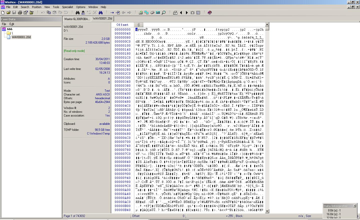

Hi friends,
I have a .20d file. How I make to enter the type of file in r-studio? (please to see the image)
Best Regards,
Carlos
 Post subject: Re: *.20D - *.60D GE DVRME 16 CT II Video File
PostPosted: April 30th, 2011, 16:12
Posts: 360
Location: Toronto
1. I need at least 2 such files with different content to see their common patterns.
2. I need both the ASCII and Hex representations of the files, as there may be some non-printable characters in the signature. The editor built into R-Studio would suit better.
3. Also, the ends of the files are also worth to look at, as there might be possible to create a signature for the file end. This is important to correctly truncate the file.
By the way, we have on our site an article Creating a Custom Known File Type for R-Studio describing almost your case: a file signature file for a digital movie. It's definitely worth looking at.

Thank you so much,
the patern is:
Sector 4050517 (Parent: D: Sector: 1418170725)
7B9CAA18: - 00 00 00 0C 6A 50 20 20 ....jP
7B9CAA20: 0D 0A 87 0A 00 00 00 14 - 66 74 79 70 6A 70 32 20 ..‡.....ftypjp2
7B9CAA30: 00 00 00 00 6A 70 32 20 - 00 00 00 2D 6A 70 32 68 ....jp2 ...-jp2h
7B9CAA40: 00 00 00 16 69 68 64 72 - 00 00 00 F3 00 00 02 D0 ....ihdr...ó...Ð
7B9CAA50: 00 03 07 07 00 00 00 00 - 00 0F 63 6F 6C 72 01 00 ..........colr..
7B9CAA60: 00 00 00 00 12 00 00 00 - 00 6A 70 32 63 FF 4F FF .........jp2cÿOÿ
7B9CAA70: 51 00 2F 00 00 00 00 02 - D0 00 00 00 F3 00 00 00 Q./.....Ð...ó...
7B9CAA80: 00 00 00 00 00 00 00 02 - D0 00 00 00 F3 00 00 00 ........Ð...ó...
7B9CAA90: 00 00 00 00 00 00 03 07 - 01 01 07 02 01 07 02 01 ................
7B9CAAA0: FF 52 00 0C 00 00 00 01 - 00 04 05 03 00 00 FF 5C ÿR............ÿ\
7B9CAAB0: 00 1D 22 67 1E 66 EA 66 - EA 66 BC 5F 4C 5F 4C 5F .."g.fêfêf¼_L_L_
7B9CAAC0: 64 48 03 48 03 48 45 4F - D2 4F D2 4F 61 FF 90 00 dH.H.HEOÒOÒOaÿ..
7B9CAAD0: 0A 00 00 00 00 00 00 00 - 01 FF 58 00 .........ÿX.
PostPosted: May 1st, 2011, 4:04
Posts: 360
Location: Toronto
I can't figure out the offset of the pattern from the picture above. 7B9CAA18 seems not a correct one.
And once more about a pattern for the end of the file. Quite often a lot of service information is stored there. Without it programs cannot play such files correctly. So, it would be good if you look at the end of the files.
