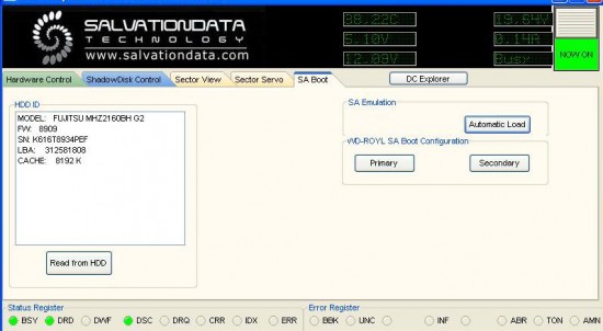

My DC can read the model number, the spinning is fine, the heads seems doing the calibration.
does PC-3000 or atola repair/view firmware of this model?
my salvation data doctors can't.

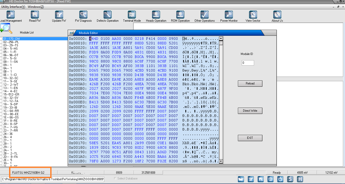

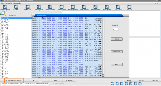

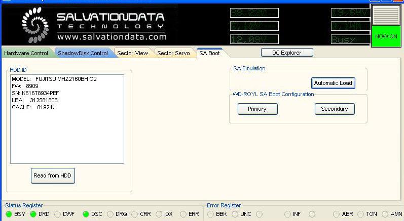

hi,
fujitsu SD tool support MHZ family here below a picture...
so you can use your tool, you simply need to make the SA MAP file, if you need i can give you teh one i made (PM you email address).
Bye
Luca
