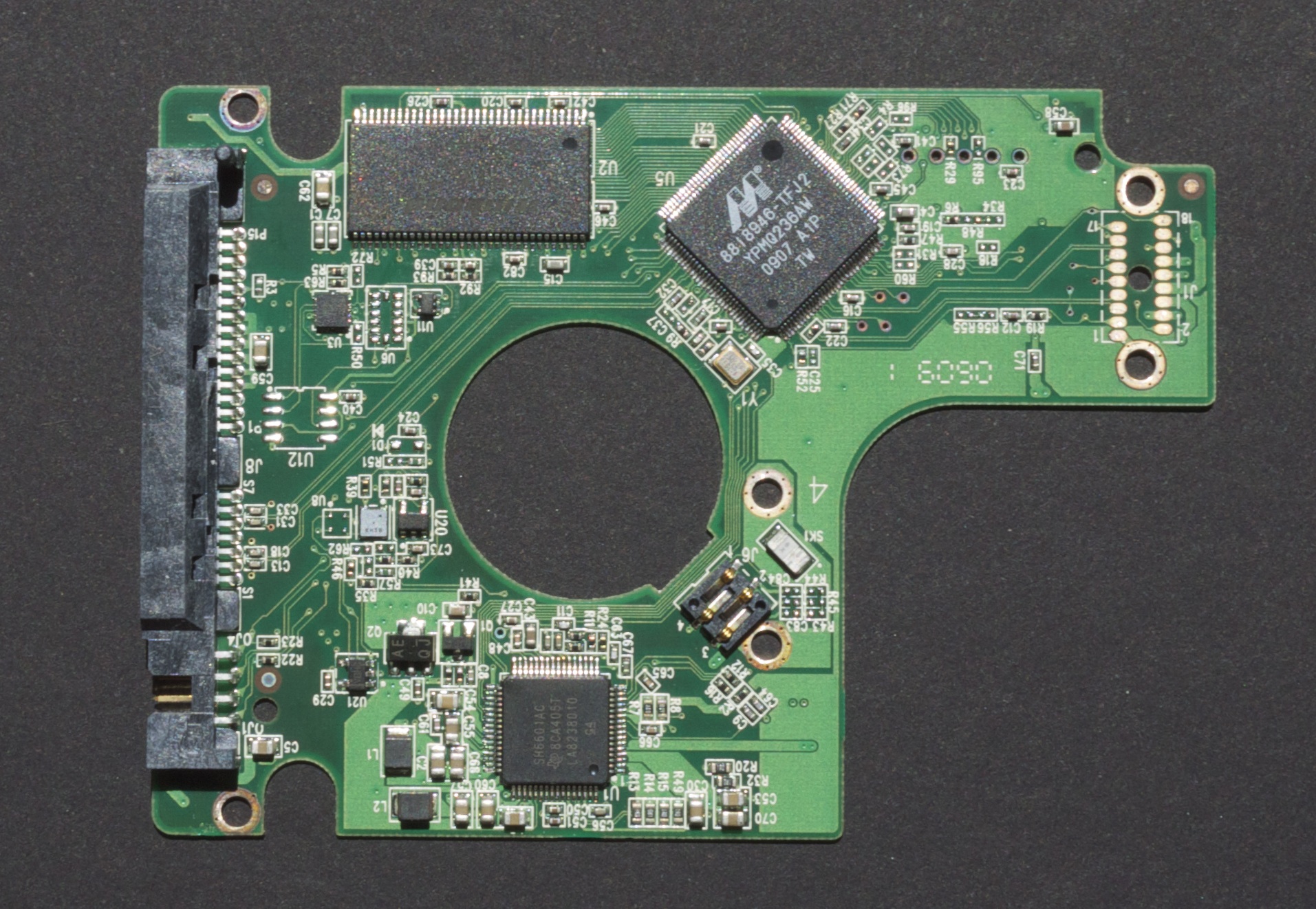

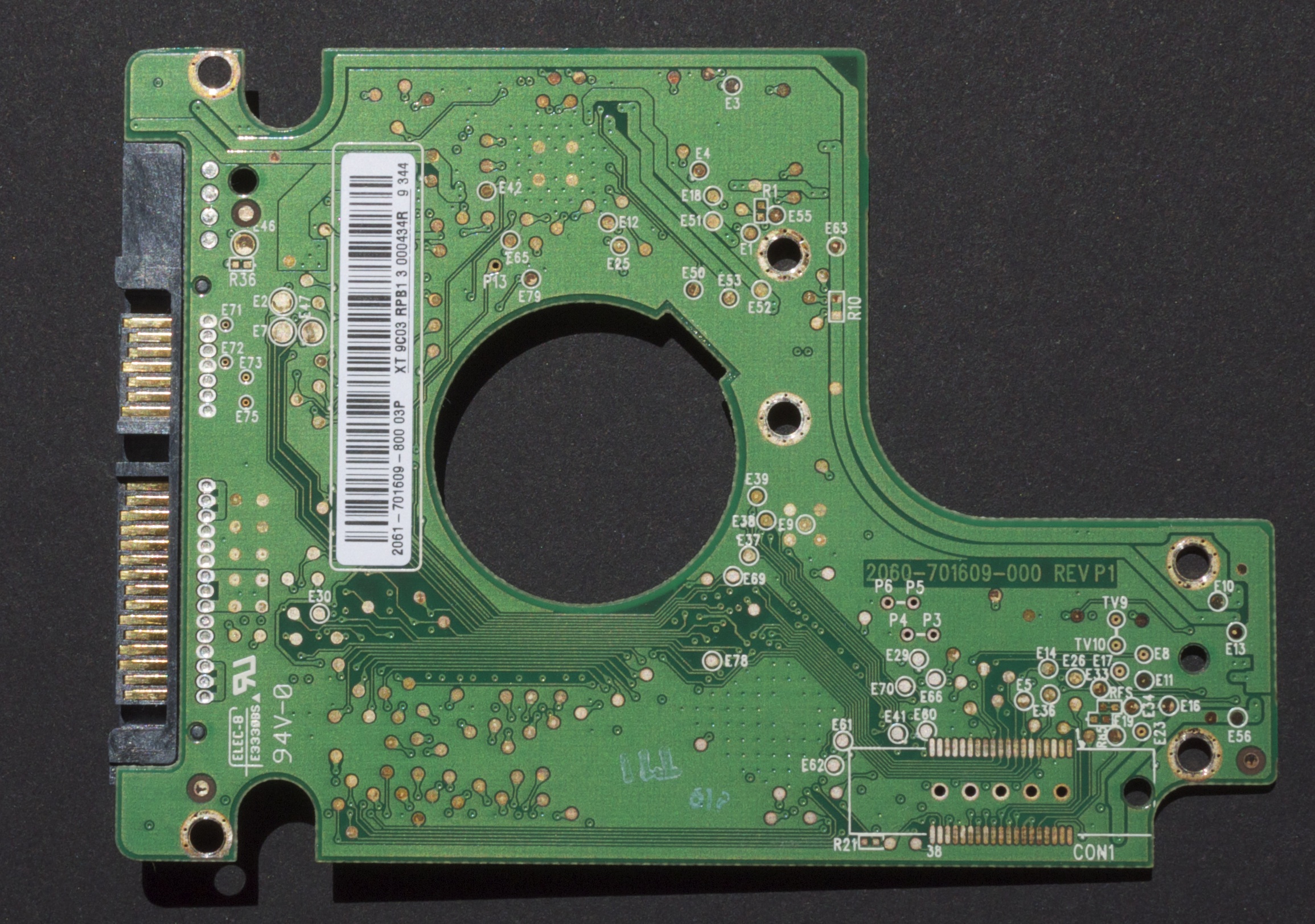

Could you upload a detailed photo or scan of the component side of the board? If you're lucky, there may be a simple DIY fix.
 Post subject: Re: trying to recover a wd500bevt
PostPosted: May 30th, 2011, 6:06
Joined: May 27th, 2011, 4:37
Posts: 6
Location: In A Crater
shure, here it is
PostPosted: May 30th, 2011, 6:39
Posts: 17232
I can't see any obvious problems. :-(
If you have a digital multimeter (US$10), then we could measure a few voltages. We could start with your good board and establish some test points. It may only turn out to be a post mortem exercise, but it may help others.
