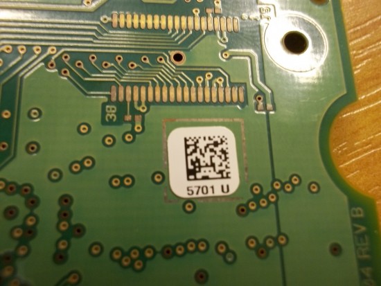

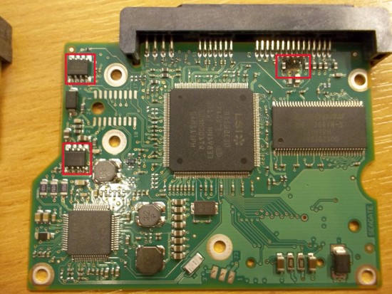

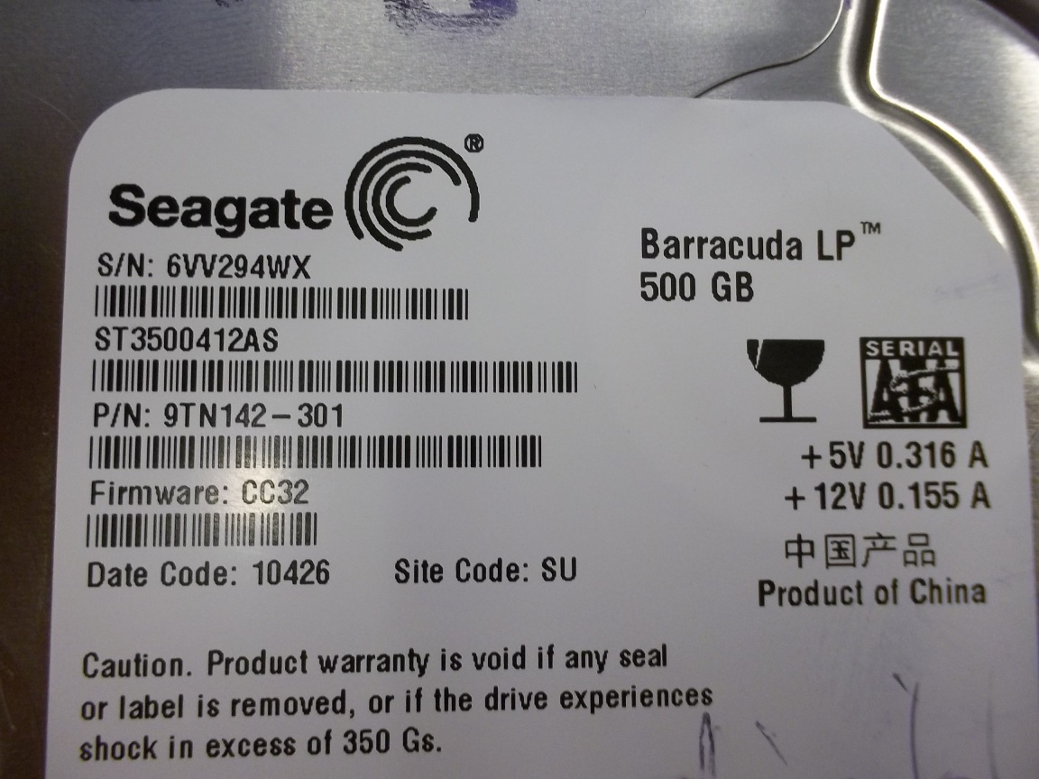

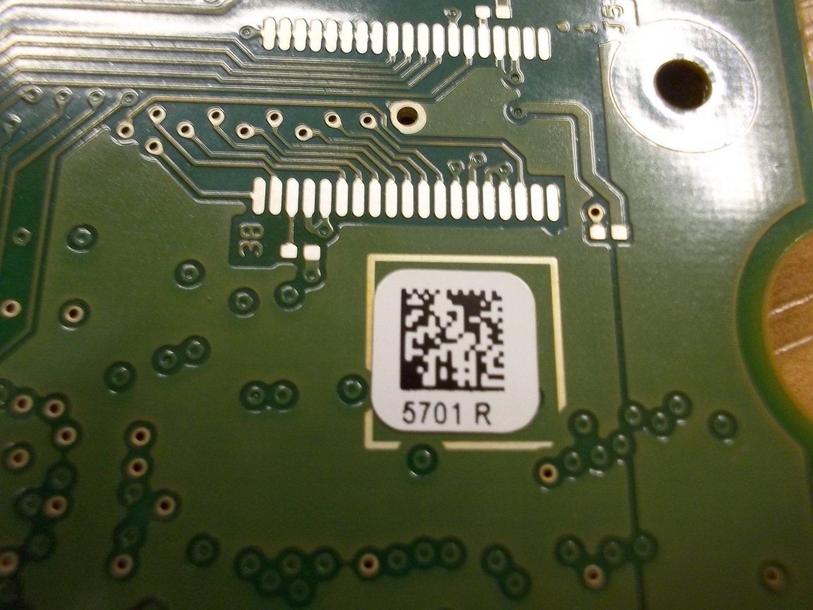

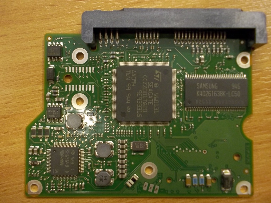

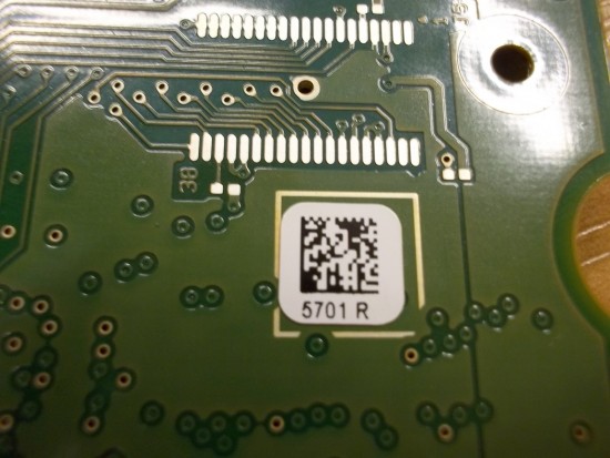

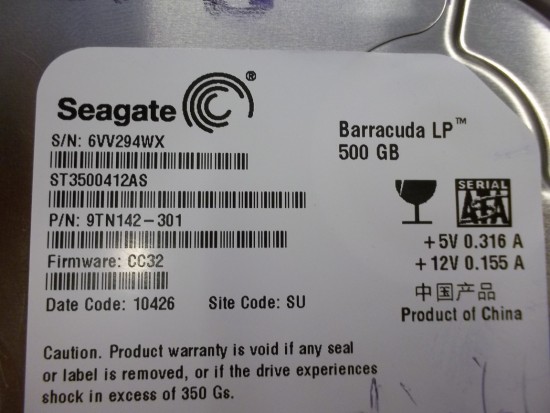

Have a burnt seagate
Donor is from same model but some chips are different manufacturer
Looking to swap the boards and the highlighted ROM chips
Will this be a match?
Many thanks
andy

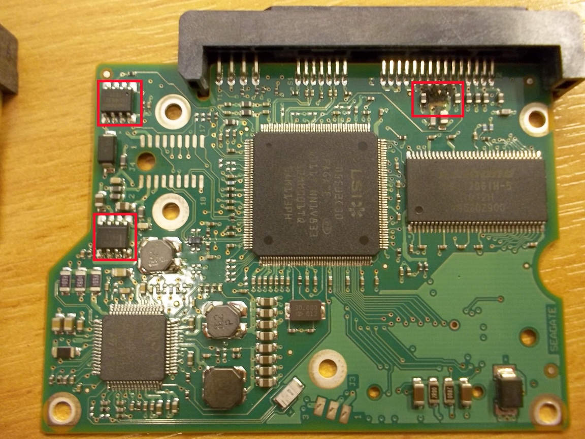

Client Board + Highlighted chips

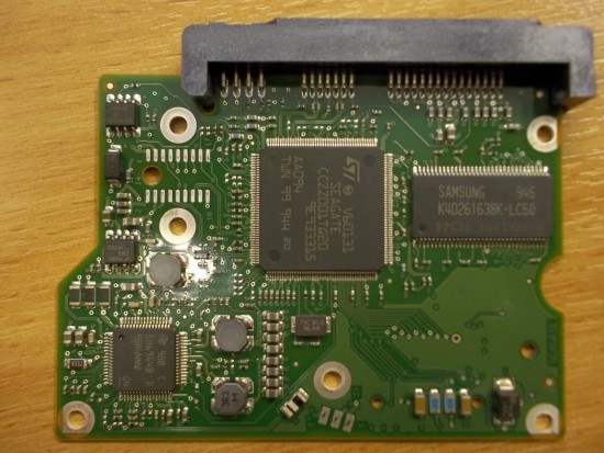

Client

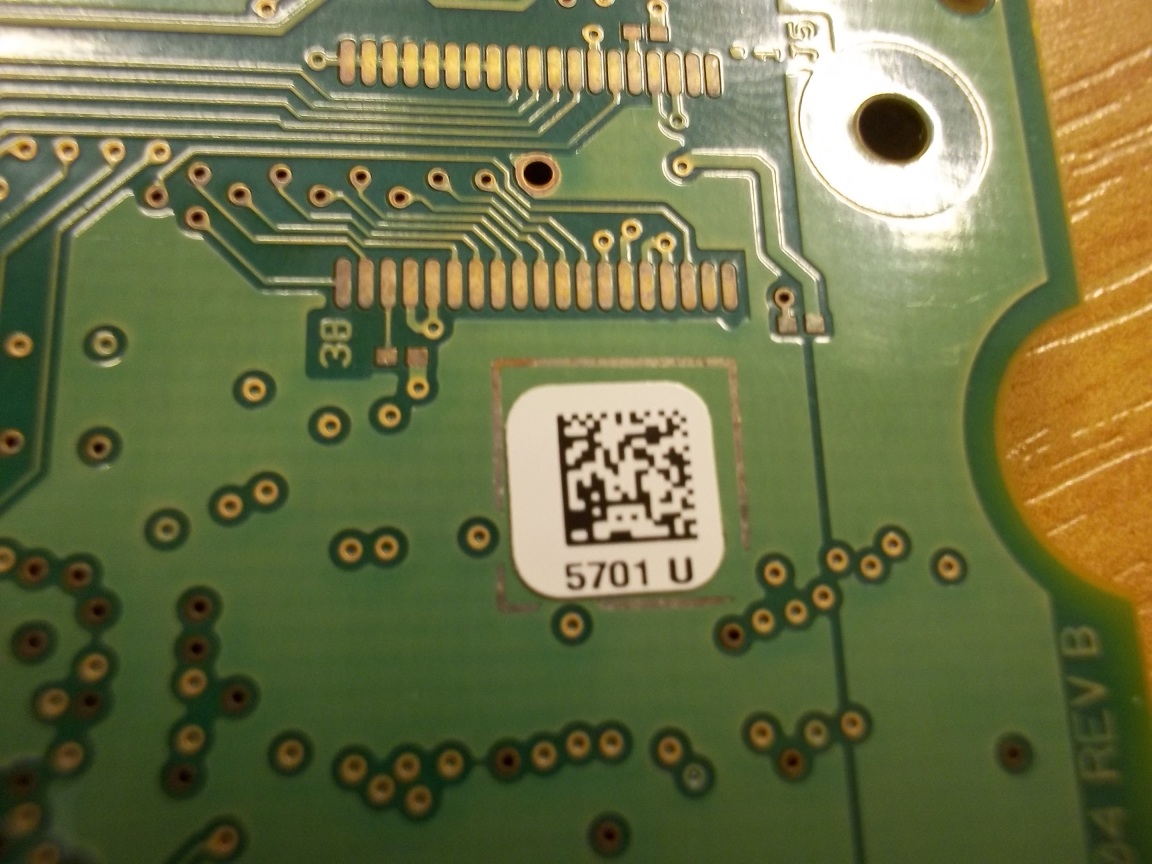

Donor
Donor Back

There is usually only one ROM chip. I think this is the one in the upper left corner.
You can try to swap them and see !
Yes it's true.

I've had success with using PCB from identical drive, even though controller chip is different (LSI vs ST). ROM chip will most likely start with the numbers '25'
Data Recovery Cape Town
 Post subject: Re: Seagate Compatibility Question
PostPosted: August 10th, 2011, 6:44
Posts: 248
Worked
Thanks to all :)
