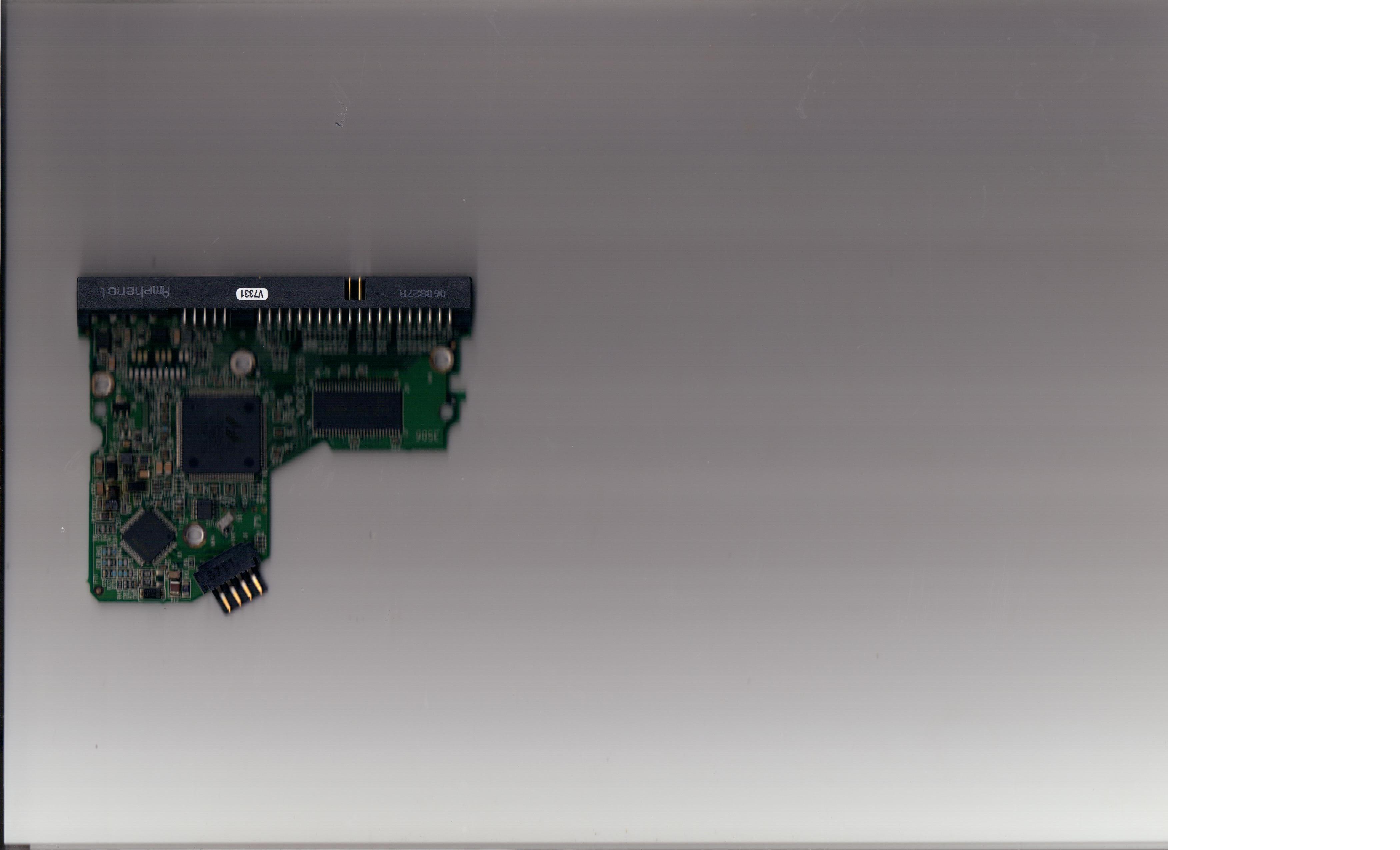

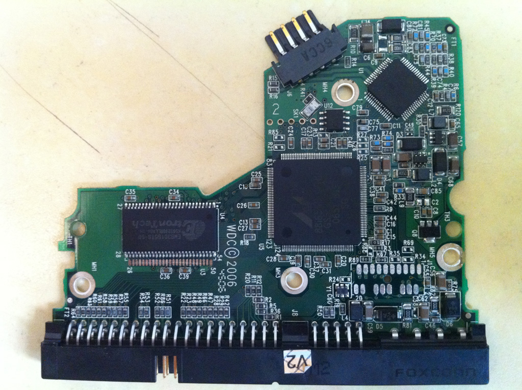

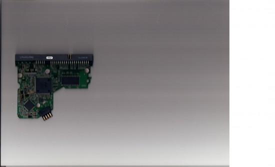

Hello everyone, i'm new on here and it seems that it's the place to ask when a HDD problem occurs :)
Introducing myself : I'm an IT professionnal, based in France, and am 33 y/o.
Now, on to the question. One of my customers has had an electrical blackout this weekend, which of course caused his PC to switch off.
He tried to start the PC, but the HDD does not spin anymore. It seems that the PCB is dead, or something like this, because mecanically the drive is OK and that it definitely does not even try to spin up.
I've read several topics speaking about TVS diodes that may be guilty, and was wondering if someone could help and tell me which diodes must i try to remove to try and recover the data ? I don't need the HDD to be saved for a long time, i just want to have it spin again so that i can ghost it on a brand new hdd, and really need this data back.
Anyone could help ?
Hard Drive:
Model: WD1600JB-00REA0
Date: 27 FEB 2007
DCM: HSBHNT2AH
PCB Info:
2061-701292-C00 AH
Here is the picture of the actual PCB :
Many thanks in advance.
 Post subject: Re: Western Digital WD1600JB-00REA0 does not spin... TVS diodes?
PostPosted: March 28th, 2011, 10:18
Posts: 260
Location: TN
Check D5 and D6

many thanks for the reply !!!
Can i cut them both or is there a risk ?

L-Tech wrote:
Can i cut them both
As networks said - you should check them, before deciding what to do. Diagnose first; act second.
To avoid me repeating again the same info as another member has given several times, you can look at the postings of fzabkar on this forum, who has previously given lots of examples of testing TVS diodes.
By removing the diode(s), you lose over-voltage protection on the related power input.
[edited to add this: In addition to checking the TVS diodes, it would also be a good idea to check the values of zero-ohm resistors R81 & R82.]
P.S. Your company website front page is breaking Google's guidelines, by having invisible links. :down:
PostPosted: March 28th, 2011, 11:26
Posts: 1091
Location: Angel Data Recovery
With your symptoms, more likely problem with motor driver chip (U1), and it would be nice that the only.
Angel Data Recovery

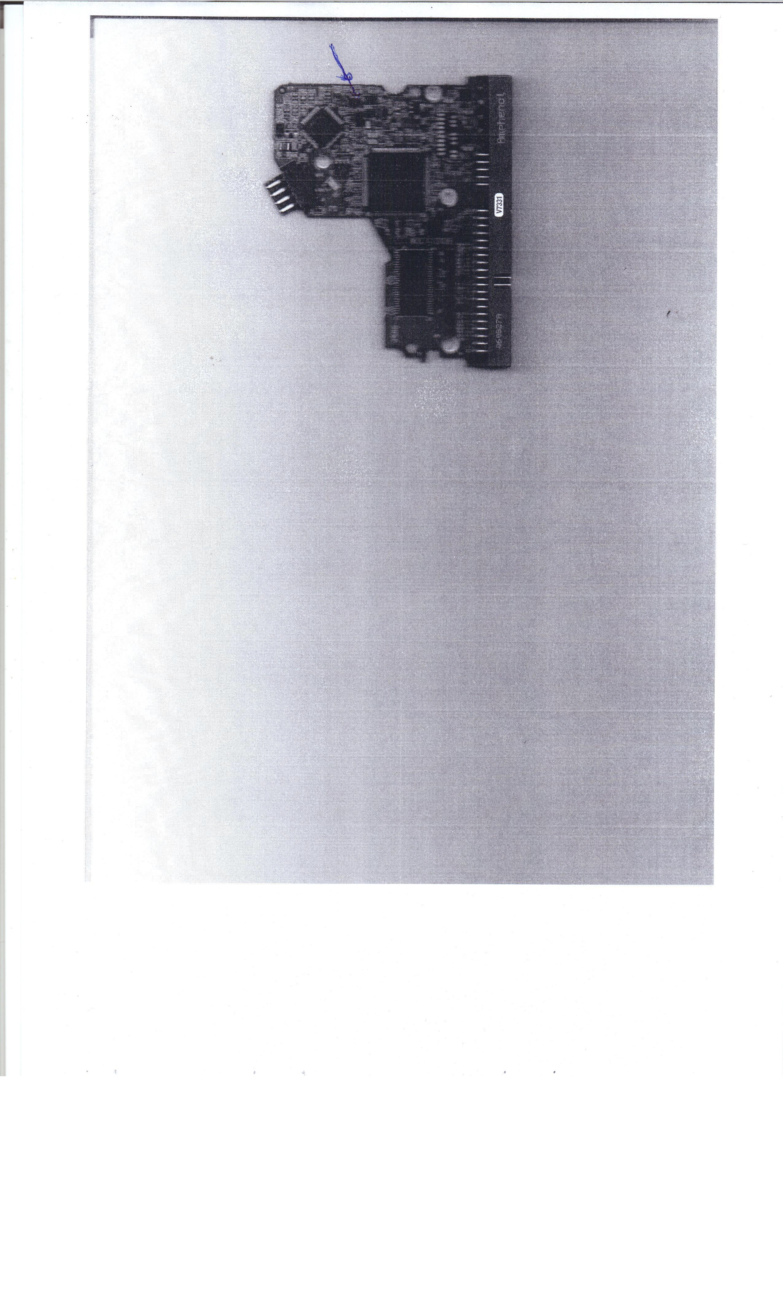

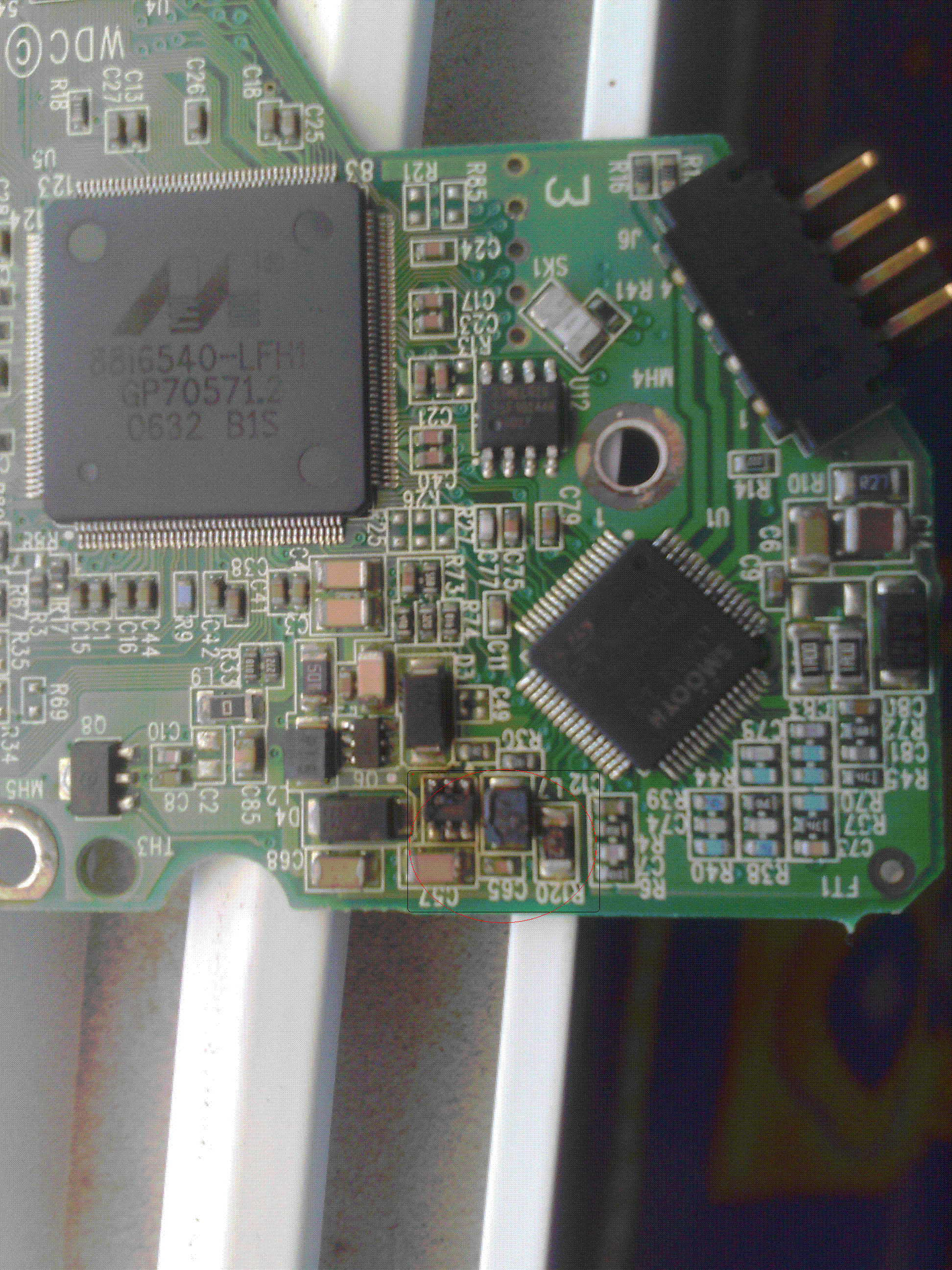

hello folks
i have same drive with somehow same problem.
drive details: WD1600JB-00REA0, dcm-
H8BHNT2CH
14 SEP 2006
pcb 2061-701292-C00 AE
MALAYSIA
attache a picture (sorry for quality). if u follow the arrow there is a burned chip. what is this chip? can it be exchange?
will it help for data recovery?
tks for your assistance
ephraim
PostPosted: August 25th, 2011, 23:30
Posts: 260
Location: TN
Need better quality pics the ones posted cant tell anything.

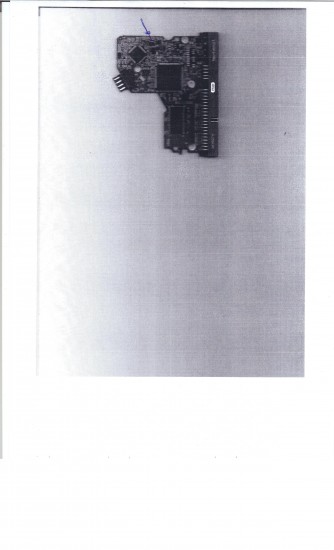

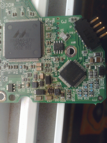

PostPosted: August 26th, 2011, 7:17
Joined: October 23rd, 2008, 6:11
Posts: 110
hello folks again
H8BHNT2CH
14 SEP 2006
MALAYSIA
attache a picture (better than last one). if u follow the circle there is are burned chips. what are these chips? can they be replaced?
ephraim
PostPosted: August 26th, 2011, 7:44
Posts: 260
Location: TN
I am guessing your best bet is to get another PCB and move U12 over or have one of the PCB houses do it for you. One place is http://www.hdd-parts.com
PostPosted: August 26th, 2011, 10:53
Posts: 110
tks a lot networks .
do u know something about those chips?
is the supplier u mentioned is reliable?
brgds and tks again
ephraim
PostPosted: August 26th, 2011, 14:56
Posts: 260
Location: TN
ephraim2 - I was not talking about individual components. If you order a new complete PCB and get the rom U12 swapped over that is no guarantee it will fix the drive. I have no idea what the chip number is I can't even tell from the better photo at the beginning of this thread. I think the damage is to great to take a chance replacing the components myself. Your pre-amp on the head stack could also have been taken out when the surge hit.
