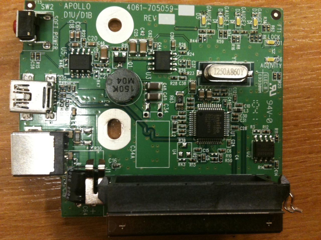

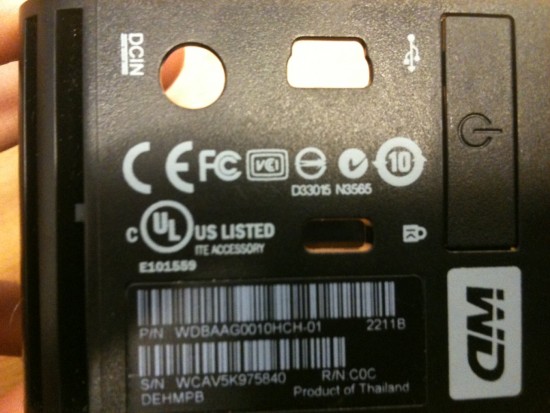

Been reading other posts on this.

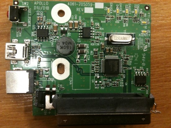

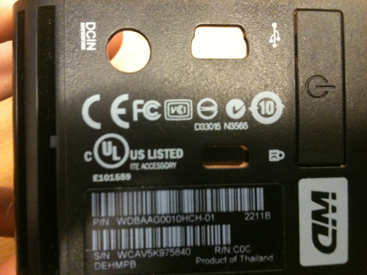

Basically the controller has died (just realized this after drive imaging perfect) and requesting the case
does the initio chip board hold specific info or can you match the model and slot it into another case?
thanks
andy

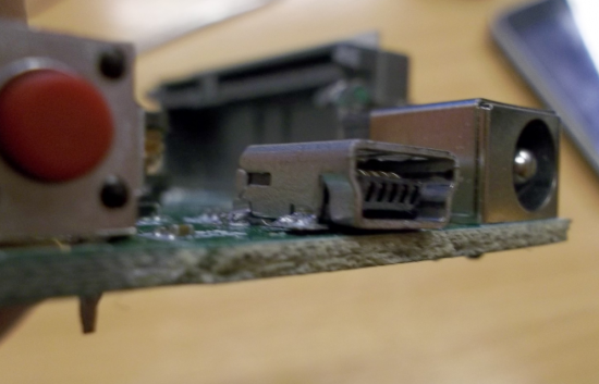

From what I understand you can put the drive into another, identical, case. So if you can get another WDBAAG0010HCH-01 (board number 4061-705059) then you can hook the drive up to that USB-SATA board and it should work.
I've seen a few of these where the problem is just the USB connector that has come loose, have you checked that?

cool, i know the USB on these can control the off/on state. Will give it a wiggle :)

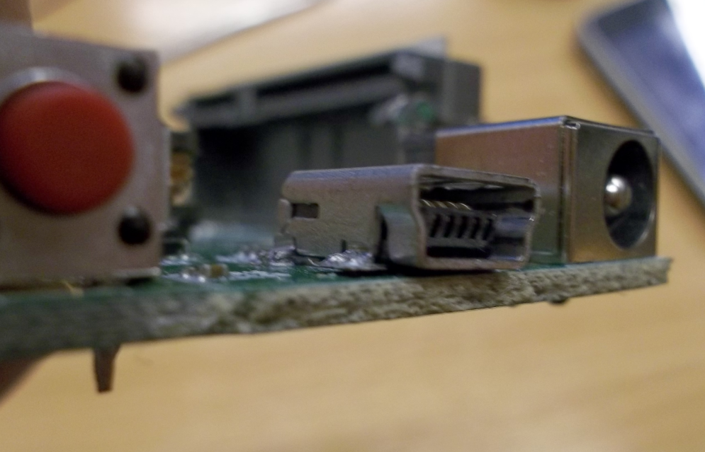

your good :)

Are your soldering skills up to it :wink:

im gonna say no but i will think of something :)

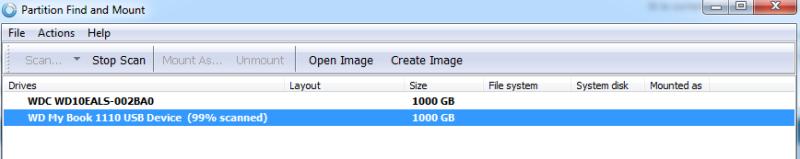

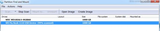

drvlas wrote:
Slow progress...
Well, the progress reached 99% and seemingly stopped.
 Post subject: Re: WD MyBook Encryption

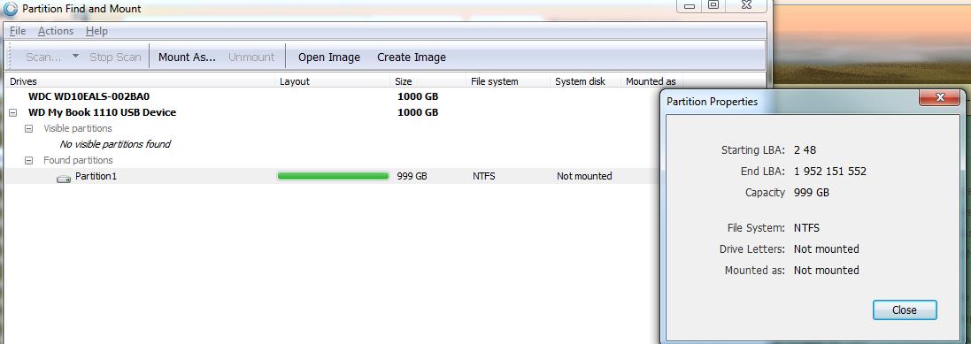

dick wrote:
Its likely there is something wrong so I would stop the scan and check any results.

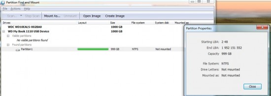

Well, I stopped the scan. Here are the properties of partition found.
The choice is not too rich:
- to create the image file
- to mount partition
