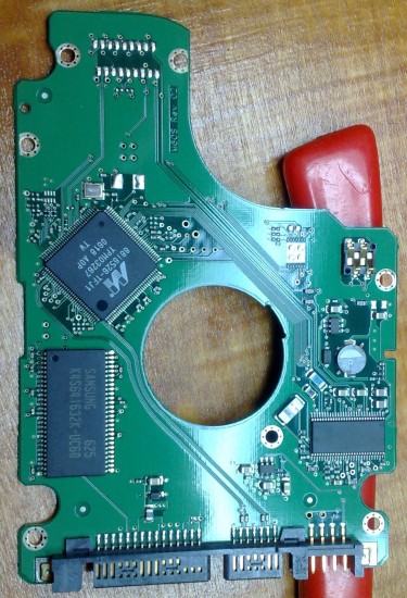

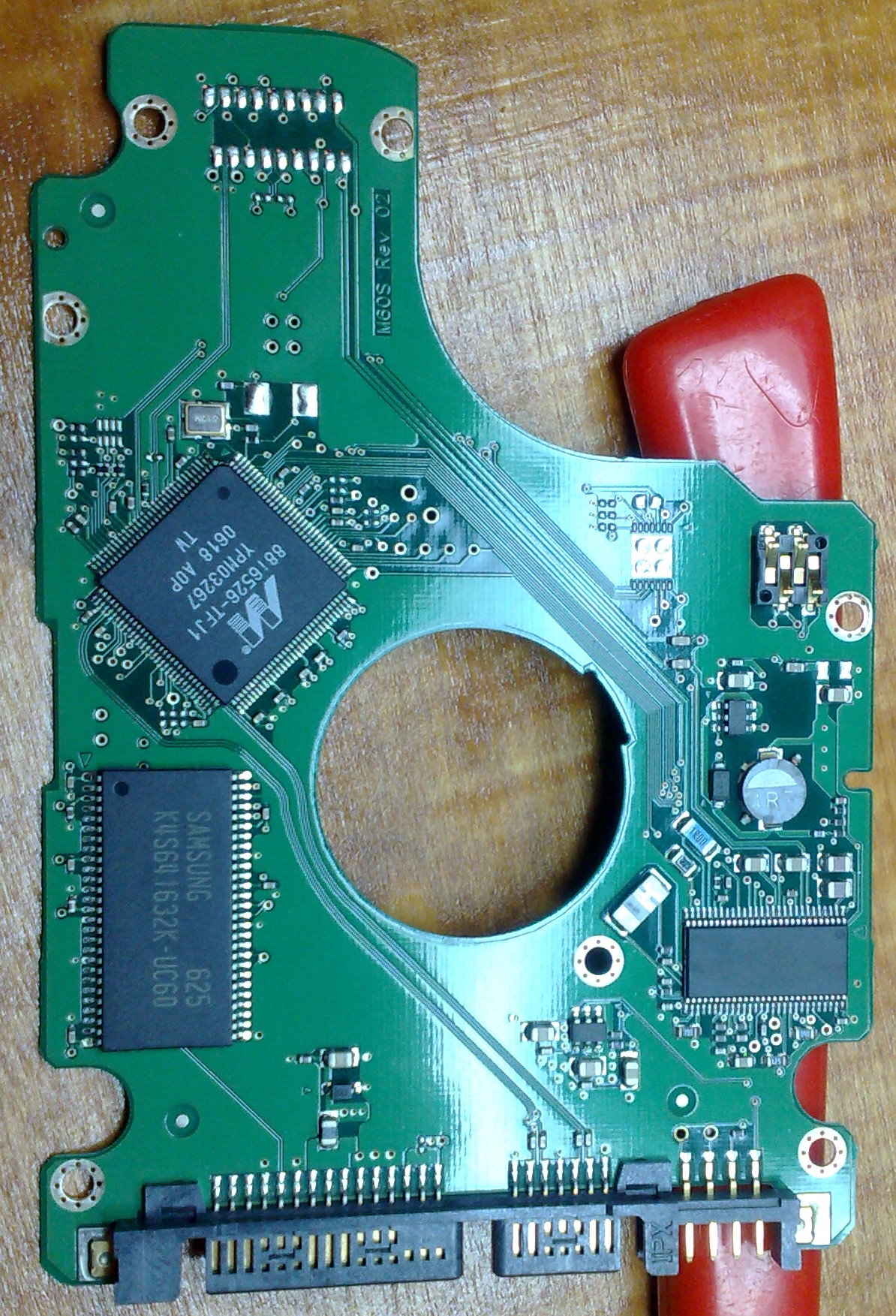

 Post subject: Re: samsung HM120JI always busy
PostPosted: September 15th, 2011, 3:28
Posts: 441
Location: italy
yes heads are fully ok (read and write test performed) on donor.
would like to try rom swap but i cant find "25" on any chip..
PostPosted: September 15th, 2011, 3:50
Posts: 1752
In that case, there's no external ROM, it's within the CPU.
