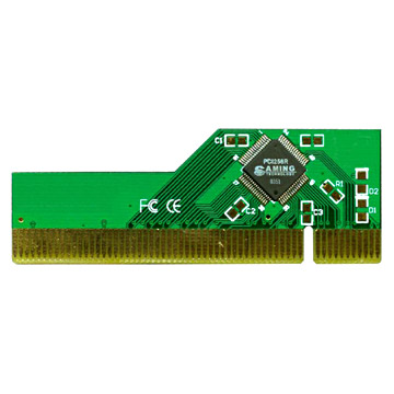

I suspect it could have been locked by some hardware based cards like recovery card. I will take some pro help to clear SA as suggested by poehere
 Post subject: Re: Hitachi works only on Thinkcenter
PostPosted: September 19th, 2011, 2:07
Posts: 2858
Seems that this PC-Guard is some how HW Solution to protect contents change
i`ve used such Software similar idea but with more network control options
called DeepFreeze if am not mistaking here
inside this solution, you should i think Unlock it through the HW, then take it back anywhere else
may or may not work
try it

I am wondering how Can a hardware lock hard disk in such a way that even manufacturer tool cannot detect right paramerters? I am sure any hardware card will not be writting anything on disk firmware ,rather no one can access or modify firmware.
isn't it a challeneging question
PostPosted: September 20th, 2011, 0:55
Posts: 2858
TaskManager wrote:
Hi
as an example to this the Smartware WD
in addition
i`ve seen many protection methods for privacy, and this is one of them and many more
there are many HW cards that locks the hdd in startup (power-on) and without unlocking them through it u will end up on Huge Circle
good luck
