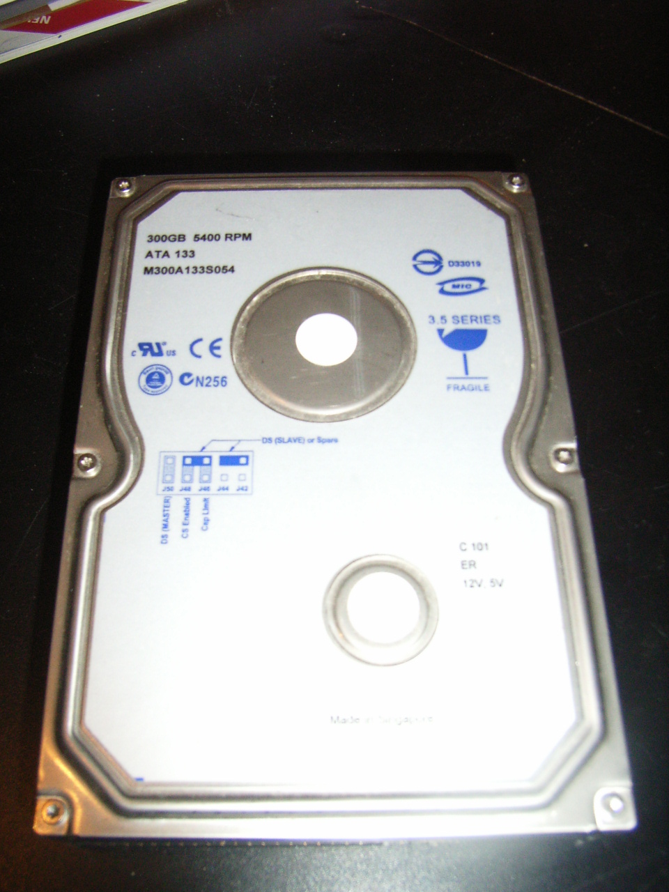

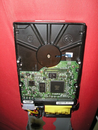

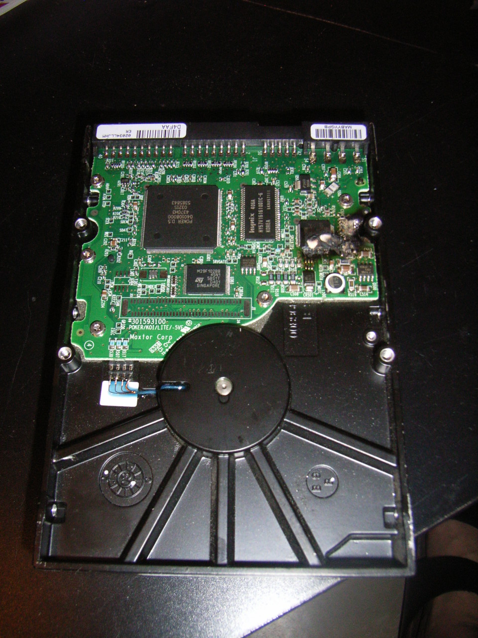

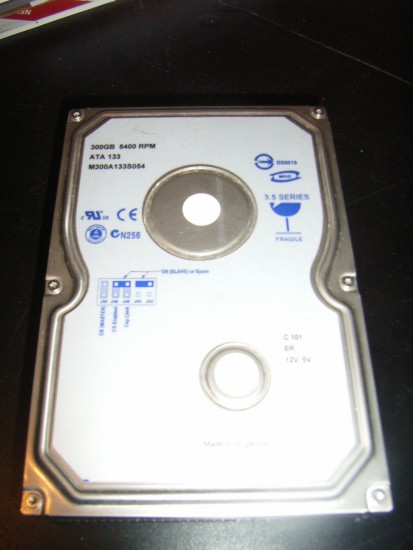

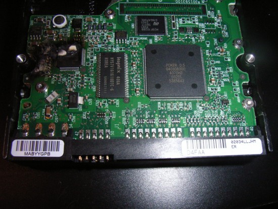

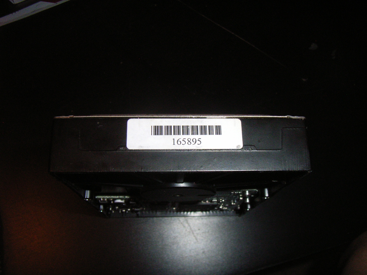

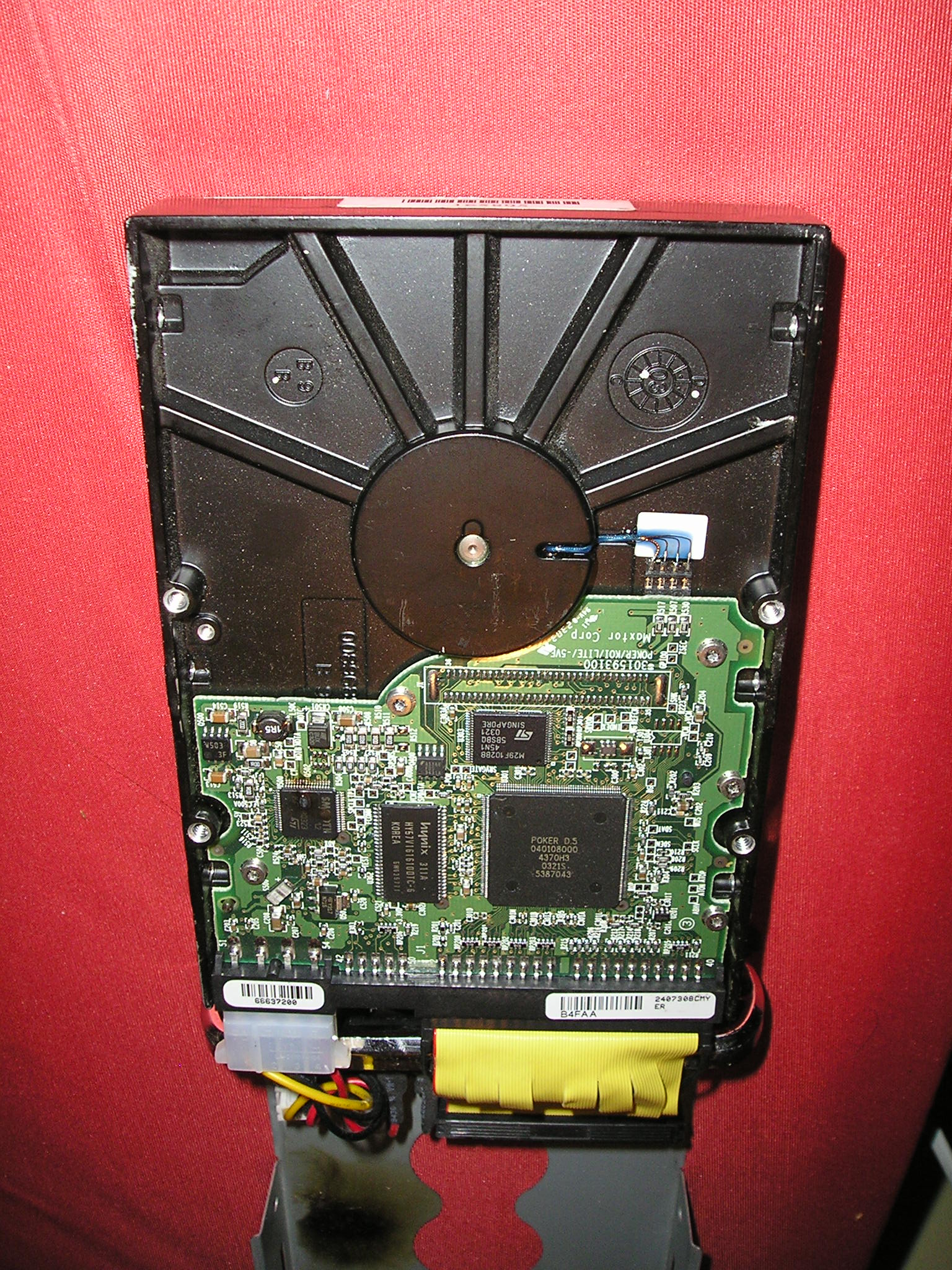

Hi there,
i'm a little new to this kind of hdd problem. Some component of the board of my hdd apparently got too hot. I don't believe the actual data on the disk is damaged so I'd like to replace the board. As far as I read this could be done with an equal or almost equal board.
Can someone tell me if my assumptions above are correct and maybe explain what numbers i have to check to find another board that is suitable? Any special place to find a board?
Attached are some pics of the hdd. Actually it doesn't even say the model on top.
Any help greatly appreciated, thanks

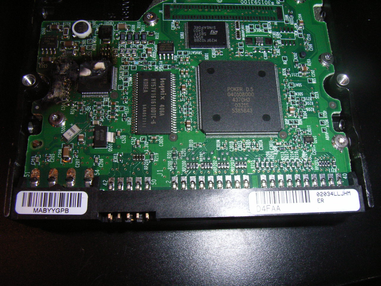

Your flash prevents me from reading it, but find a PCB with a label that matches the five alphanumeric characters under the barcode label on the right.

I assume you mean the barcode of the last picture. It says D4FAA. So that is the only thing that has to match?
Alright i'll see if I can find this somewhere... Thank you!

The letters are D4FAA, so this you have to match...And from the look of the pcb it may be an Maxtor Maxline II hdd....(5A series).

Your drive is(was) an 5A300P0xxxxxx model....You should search for a pcb from this type of drive(not 6Y080P0xxxxxx model)....And of course match D4FAA letters...Another big problem is that you don't know the "Code" of your drive. In your case should be RAMB1TV0 or RAMB1VV0.....If you don't match this "code" the drive will start clicking when put an incompatible pcb....

You'll also want to match the first 3 characters of the serial number.
I've not seen many of those drives, it could be quite tough finding a good match. Also that is one of the nastiest burnouts I've ever seen! What did you plug into it?

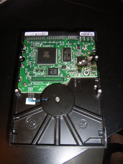

So, the replacement PCB I used in '09 worked until today.
Now I'm looking for a replacement again for the same drive :cry:
I attach a photo from the last PCB on the drive.
The one in the above photo was the original.
Anybody maybe have another replacement for me?
