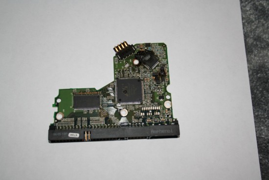

Hello All,
I recently experienced 2 hard drive failures due to electrical damage. Lost house power a couple times during the night and the PC power supply fried. I replaced power supply only to find both hard drives fried. I actually smelled them burning during power up. After this both hard drives would not power up, wouldn't even make a sound. I was able to get 1 hard drive working by replacing PCB board and swapping bios chip. This particular drive showed no visible signs of damage. However the other hard drive's PCB motor IC chip was burned. I also replaced the PCB and swapped bios but was not as lucky. The drive now makes a intermittent, repititious buzzing noise e.g. buzz, buzz, buzz, quiet, buzz, buzz, buzz, quiet, etc. Anyway I was hoping someone out there has some suggestions on what to do next. Is there something I'm missing or am I out of luck? Any ideas or suggestions are much appreciated. Almost forgot drive is a Western Digital 200gb model WD2000BB. I also attached photo of original PCB so you can see what burned (bios chip is removed).
Thank You,
Troy

Preamp is surely burned, too. It's not D.I.Y.

The buzzing sounds like a stiction fault.

I've never seen stiction on a WD 3.5" drive. I have seen bad motors and bearings.
Even if it were "stiction", if you open the drive you will ruin the head stack alignment. I don't recommend that you inspect the interior.

I fail to see how a bad bearing could be the result of a power outage. As for a motor problem, the OP could measure the resistances of the windings with a digital multimeter.
I was referring to the buzzing sound that the drive made and the fact that it didn't spin up. A missing phase on the motor could cause that -- no big surprise when you look at the motor IC on the fellow's PCB. I certainly wasn't trying to convey the idea that an electrical problem would cause a bearing problem. Not sure how you concluded that . . .
Although it is true that a multimeter could diagnose shorted or open motor windings, I'm afraid that this particular drive is way beyond help with a VOM. Sure, it would be nice to "know" if the motor is functional, but if the preamp is shot (like I am about 90% sure that it is) then it's a moot point. In any event, it's not a DIY recovery, so why do you propose that the person should expend time and resources on it, if the outcome is almost certain to be unfruitful? I'm just trying to understand your thought process. Thank you.
