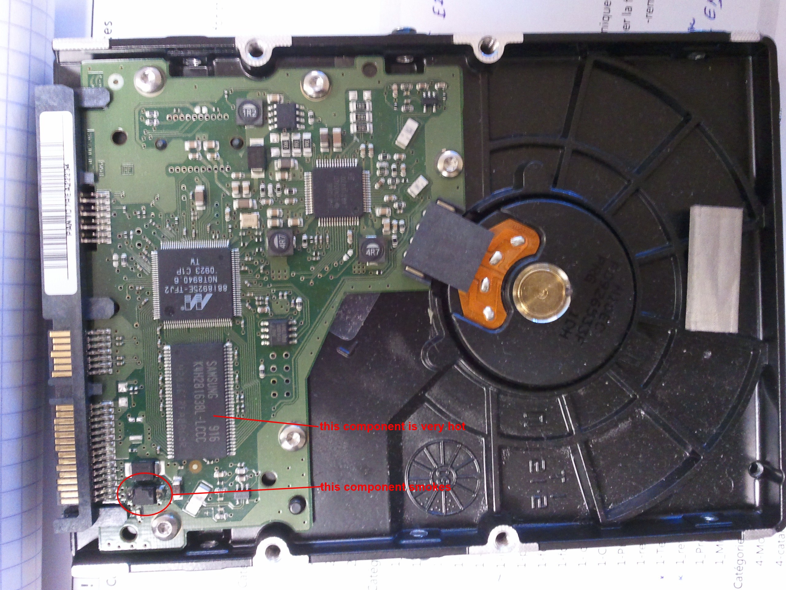

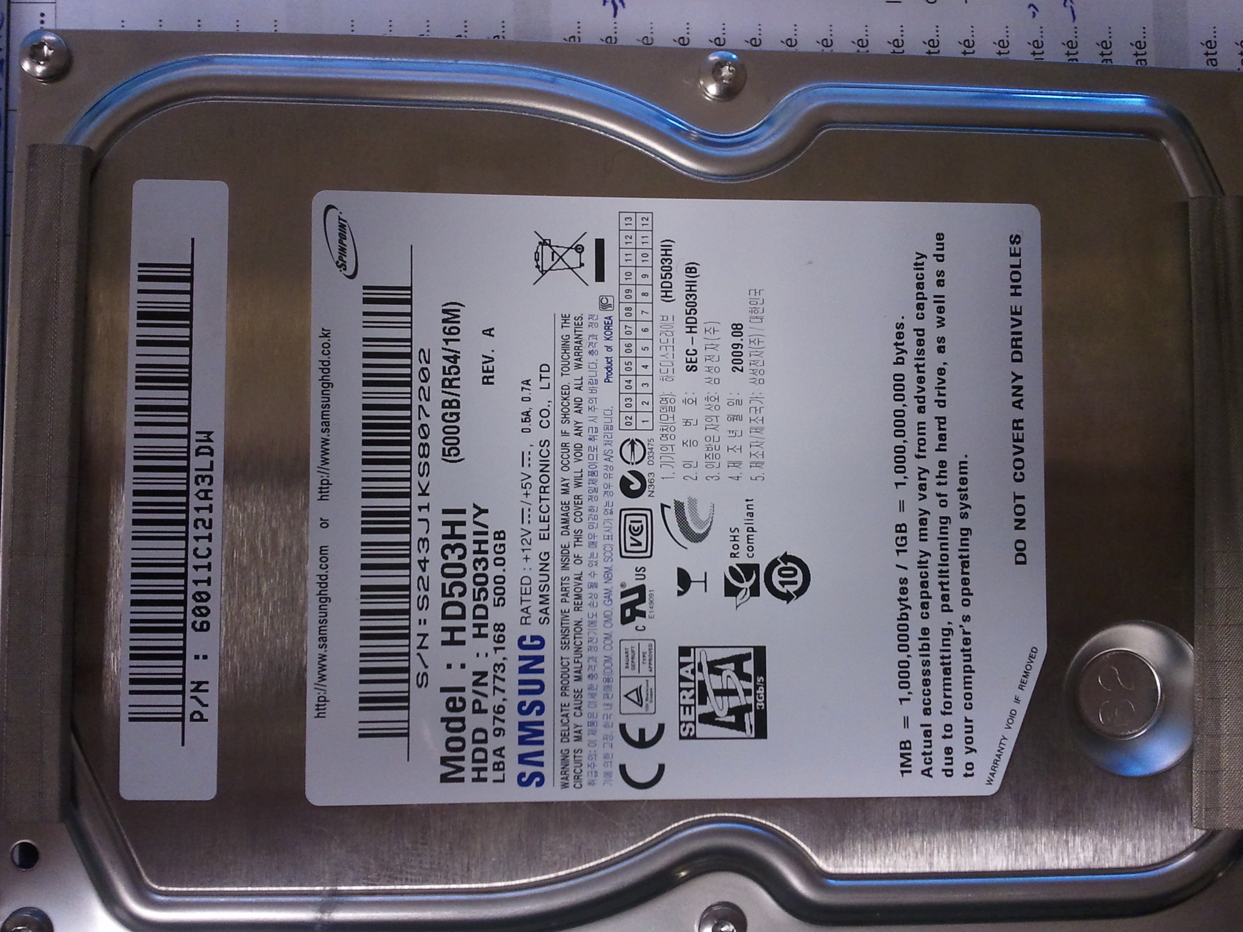

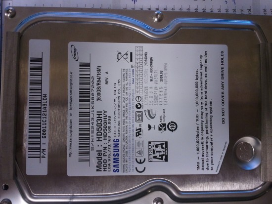

Hi i have an JD503HI F3_1D rev 02, trays not turn
i found :
HD503HI - FW: 1AJ10001 PCB: F3_1D Rev.01
Is compatible ?

hi,
ANY noise :-(
in red, I replaced a component that was much heated. (same reference)
My comclusion, pcb is dead, is correct ? or platters are stuck
 Post subject: Re: HD503HI, trays not turn
PostPosted: October 25th, 2011, 1:18
Posts: 17386
Your drive has sustained an overvoltage on the +12V input. The damaged component is a 12V TVS diode.
If you have a multimeter, then I could help you test the onboard voltages. A cheap digital multimeter should cost around US$10 or less.
BTW, I don't know if a direct board swap will work, but at least you will be able to confirm if the PCB is faulty.

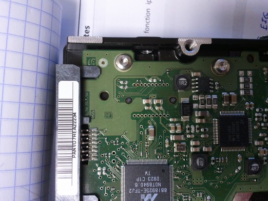

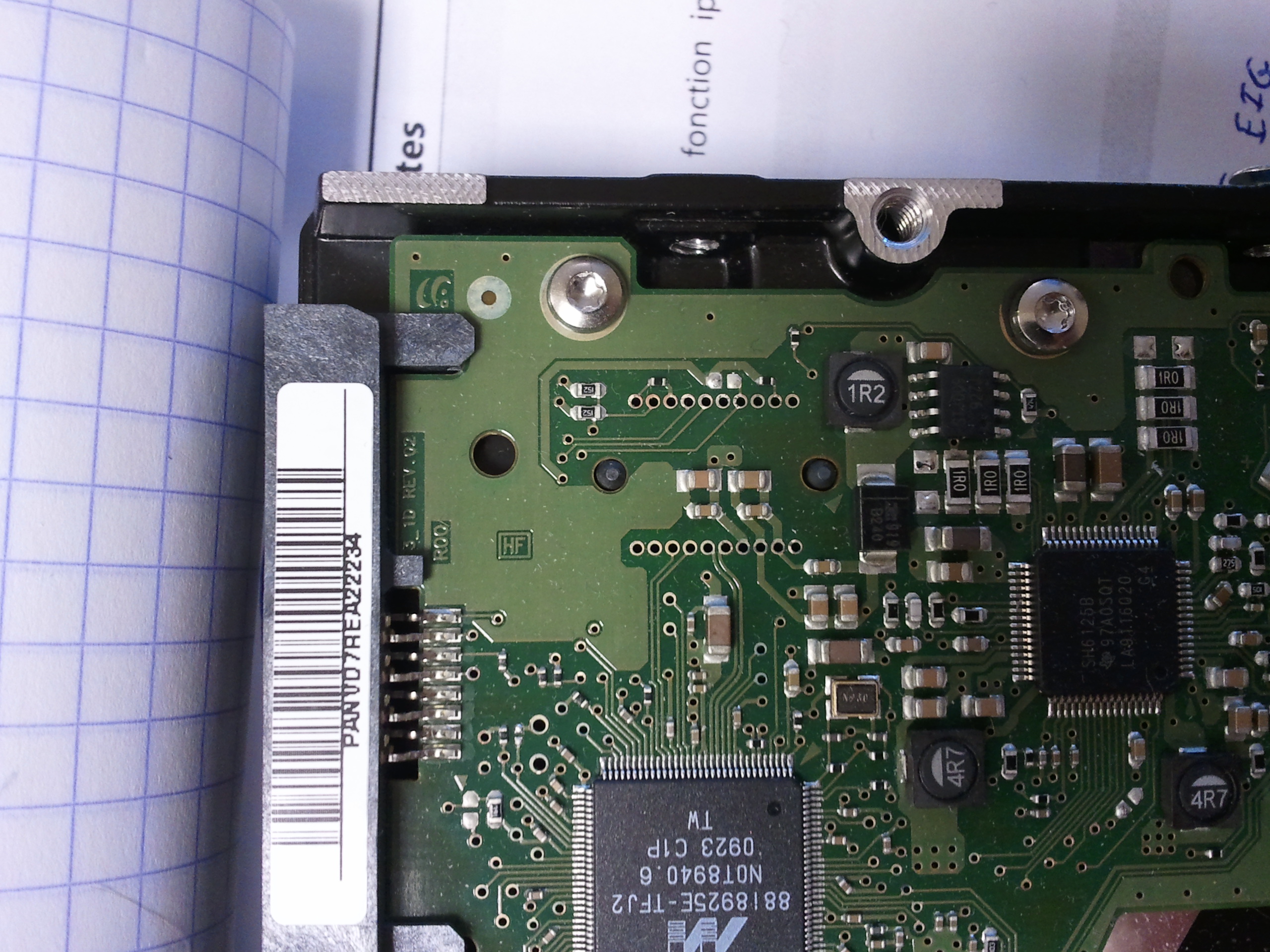

It would be better to test the board on its own first.
There are two 4R7 coils near the motor controller chip. Measure the voltages (Vcore & Vio) between ground and each of the coils. Use the plated through-holes below each coil as your test points.
Then measure the voltage (Vneg) at the bottom end of the diode below the 1R2 coil. This point should measure -5V.
I'm not certain which test point is which, but here is my first guess:
http://www.users.on.net/~fzabkar/HDD/HD ... ltages.jpg
You could use a screw hole or a SATA ground pin as your 0V reference.

hi,

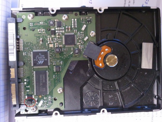

if i connect this PCB on the supply, it smoke :-(
PostPosted: November 2nd, 2011, 16:39
Posts: 17386

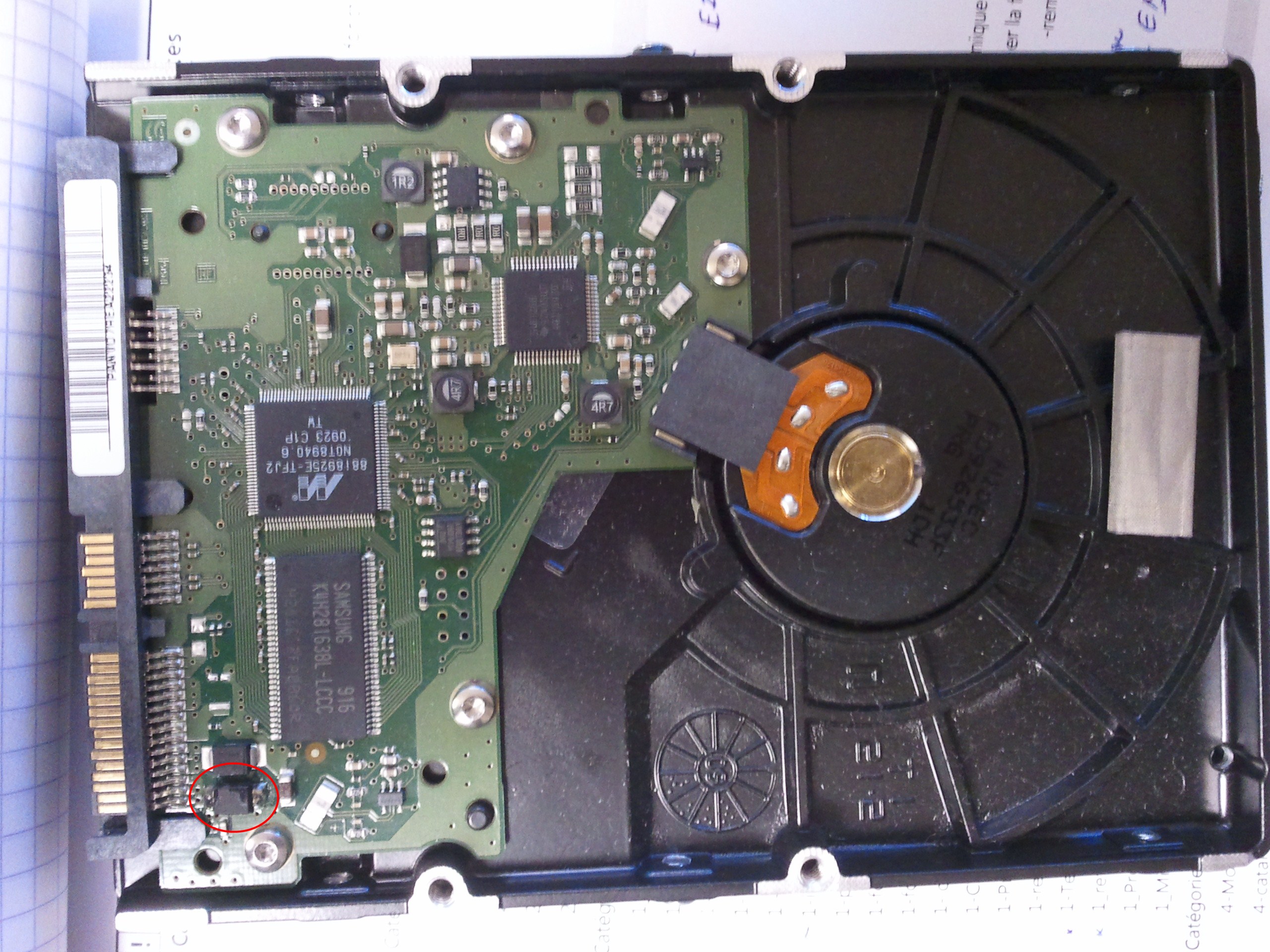

First you need to be sure that your power supply is good. Then you can remove the shorted diode with flush cutters (as stated in my FAQ). If there are no other problems, then the drive will work without it, albeit without overvoltage protection on the +12V supply
That said, if the Samsung SDRAM is getting hot, then you have other more serious problems.
PostPosted: November 3rd, 2011, 2:45
Joined: October 24th, 2011, 6:03
Posts: 10
Location: luxembourg
I have verify my power supply and it's work perfectly, i've test an other hard drive and with multimeter.
Then you can remove the shorted diode with flush cutters (as stated in my FAQ)--> i don't fond your FAQ :-(, is it in manuel section ?
i find this : js.list021.cn/view.php?num_iid=13707580923
PostPosted: November 3rd, 2011, 16:30
Posts: 17386
See Q9:
BTW, if the diode were shorted, then the power supply would be shutting down, and therefore the SDRAM wouldn't be heating up.

i remove one or two diode ?
PostPosted: December 7th, 2011, 3:40
Posts: 17386
Just remove the one that is shorted, ie the 12V diode.
PostPosted: December 7th, 2011, 4:14
Posts: 10
i have remove one diode, but the disk is not find by bios
PostPosted: December 7th, 2011, 4:57
Posts: 17386
So does it spin up now?
PostPosted: December 7th, 2011, 5:15
Posts: 10
yes, disc rotates now :-)
PostPosted: December 7th, 2011, 6:59
Posts: 10
ok, after 2 reboot, the hard drive is ok
PostPosted: December 7th, 2011, 7:18
Joined: July 7th, 2010, 4:45
Posts: 924
Thats good.
Now copy off your data to another drive as this drive no longer has over vaultage protection.
