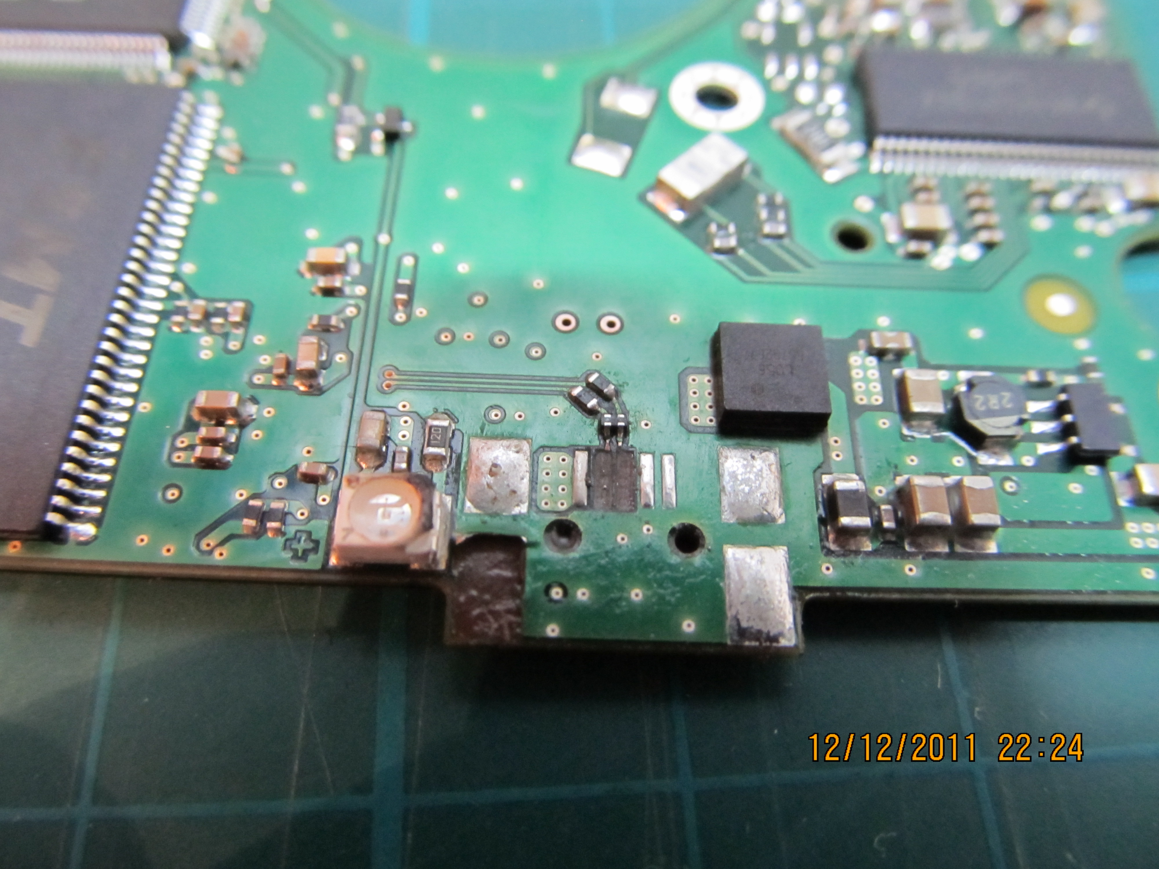

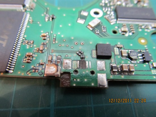

Question guys
if you look @ the 2 places where the USB mini goes which is Broken connector
i tried to follow the points trying to solder ext. wires to it, but the problem is that it is too damn tight
even i tried to pull a wire from the 2 points but too damn small hole
my question is: is there any soldering material which fills those empty broken places (brown) ?
or any other technique?
thank you

wirewrap wire

Hi, I would have thought for recovery purposes you can solder directly to what look like 2x inductors. Not sure what the other component is closer to the 2 broken pads but it might be a ferrite bead.
It dosn't look too hard from here! You just have to use the good magnifying lamp, the correct tip on your iron & a good quality solder. Maybe use kaynor wire though not always necessary.

thank you guys, will go through it again
my soldering skill were so bad, but now big Diff. heheh
thnx again
