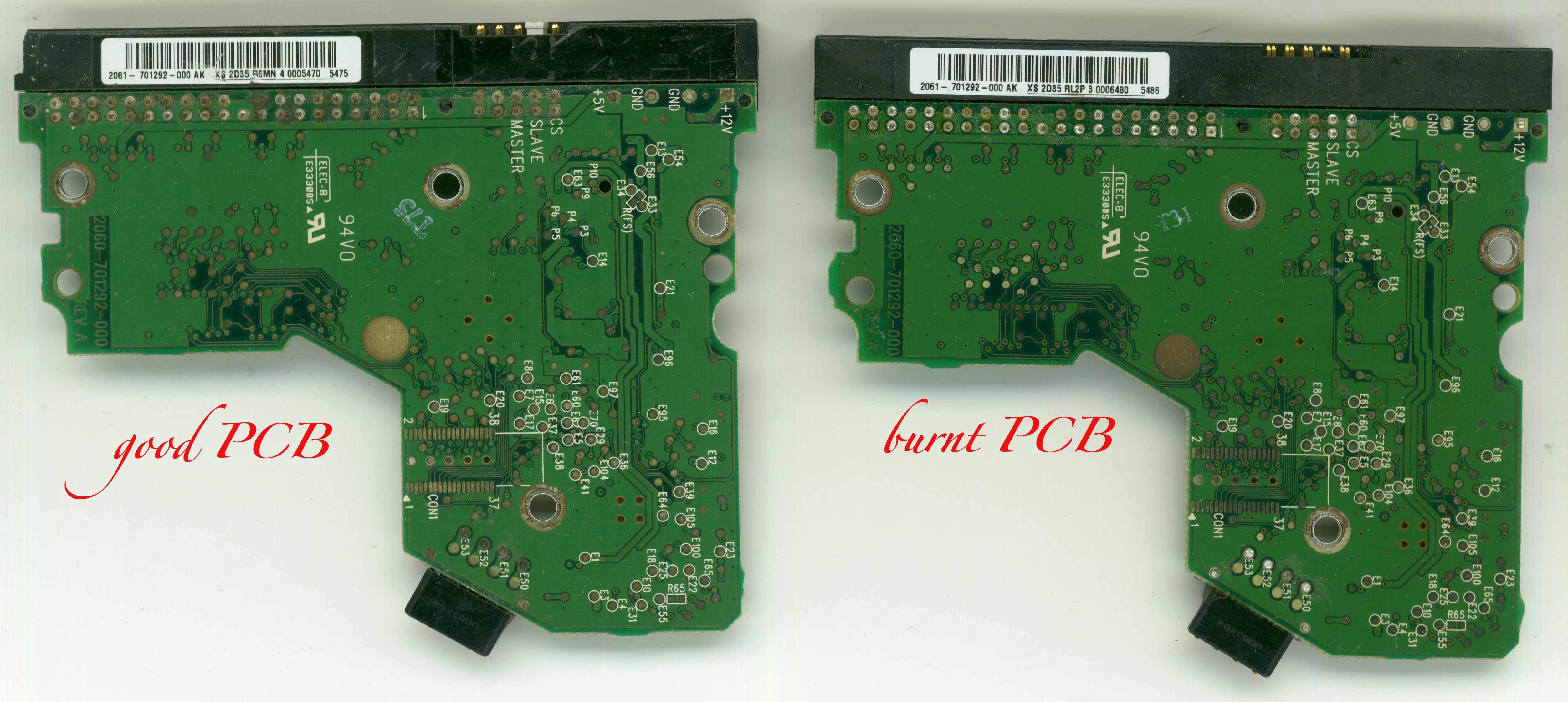

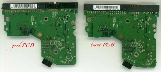

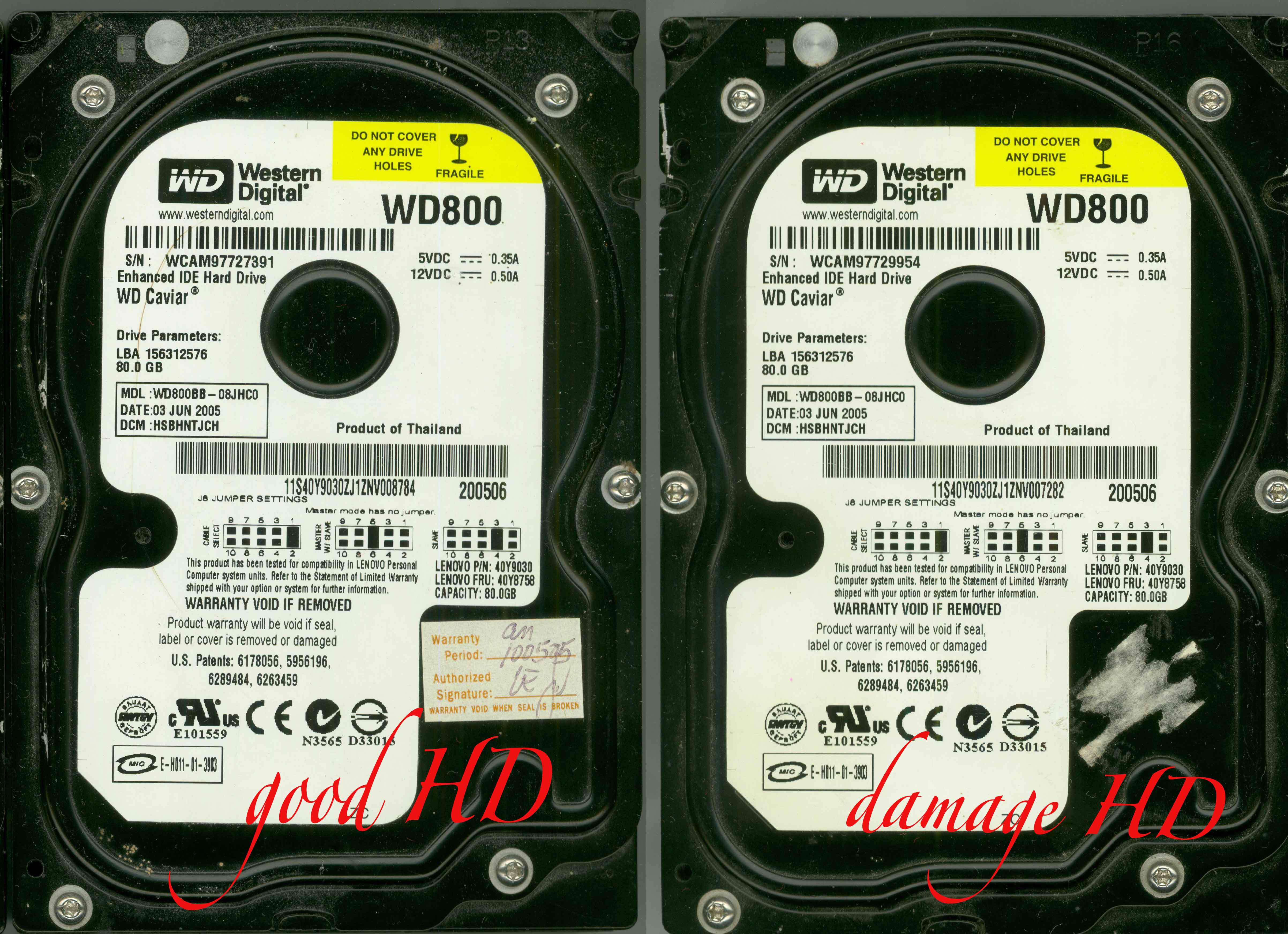

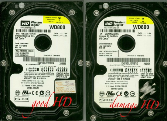

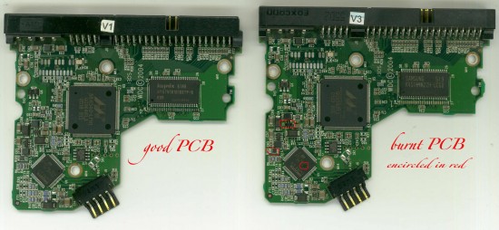

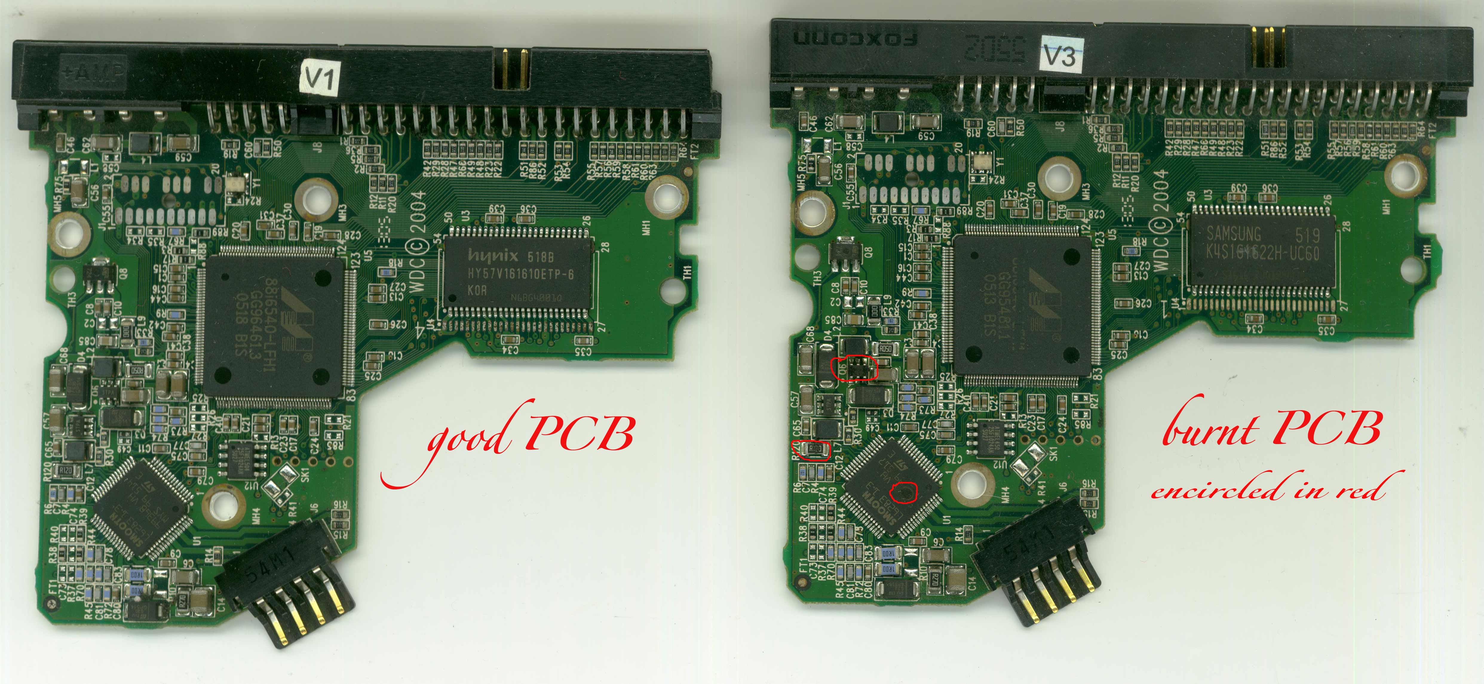

 Post subject: Re: Western Digital WD800BB-08JHC0 PLS help *** UPDATE PICTU
PostPosted: December 13th, 2011, 21:16
Joined: October 3rd, 2011, 1:39
Posts: 6
Location: Philippines
PCB FRONT:
PCB BACK:
The HD's:
Guys, let me know if the swapping of the U12 will fix the problem, just to be sure.
Like what I have first said in the thread, I swapped the two pcb and the result is just a noise on the HD, did not detect on the computer.
What if it won't work, any other method, I can DIY to fix the problem. Hoping to hear from you guys.
PostPosted: December 14th, 2011, 2:02
Joined: June 8th, 2006, 19:44
Posts: 3144
Location: Atlanta, GA
Mabuhay, Eiloh.
The burned parts in your photo usually mean bad preamp -- that is why the drive is clicking.
This is not a D.I.Y. recovery and is difficult for many pro firms.
Jon
http://www.datasaversllc.com
PostPosted: December 14th, 2011, 4:53
Posts: 3551
99.5% preamp as Jon says.
0.5% your new board makes preamp mimics due to marvel chip.
