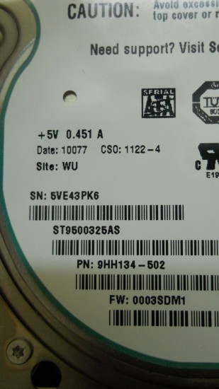

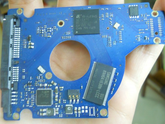

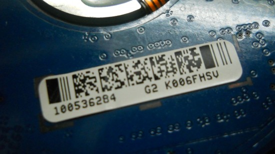

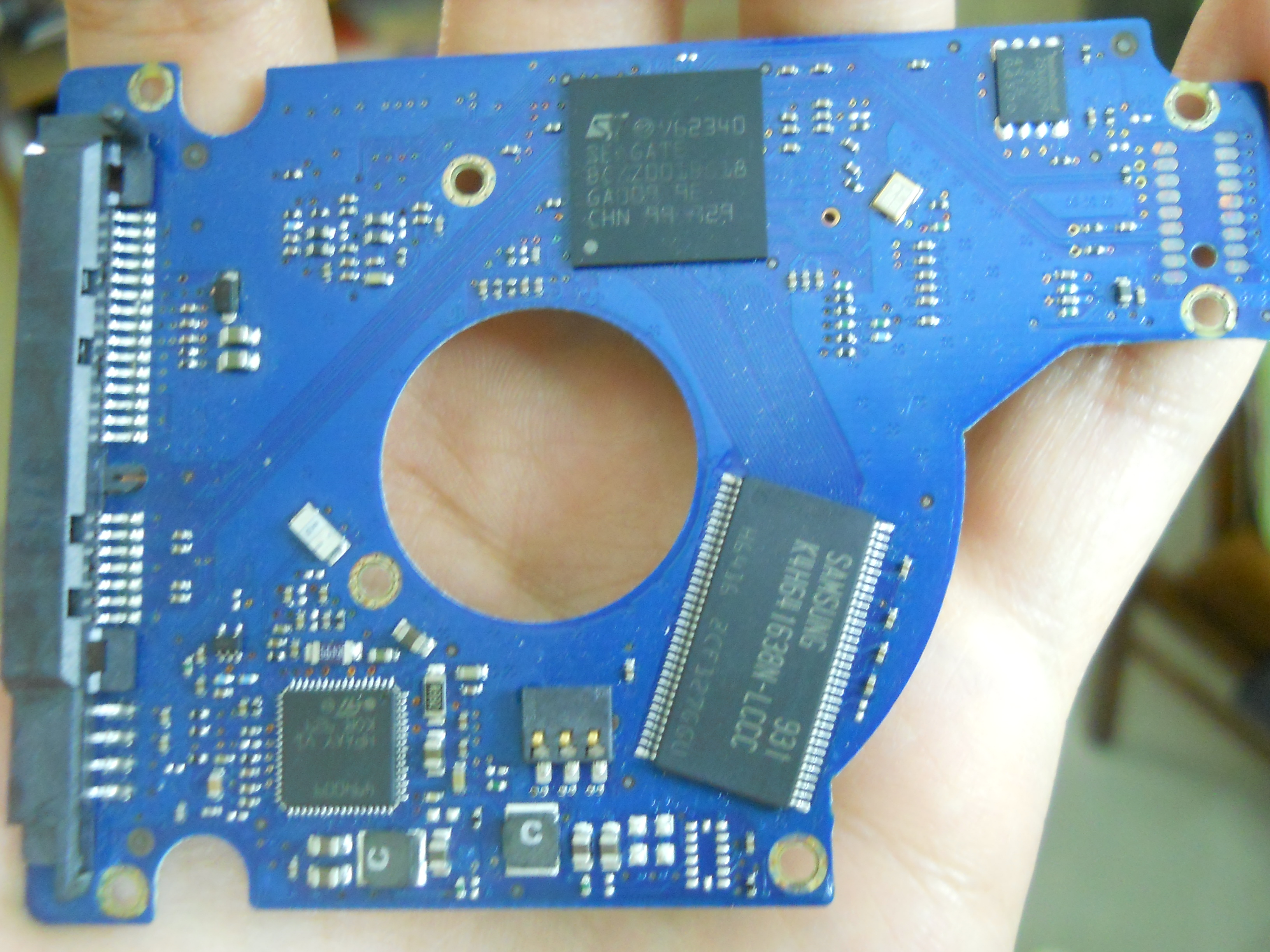

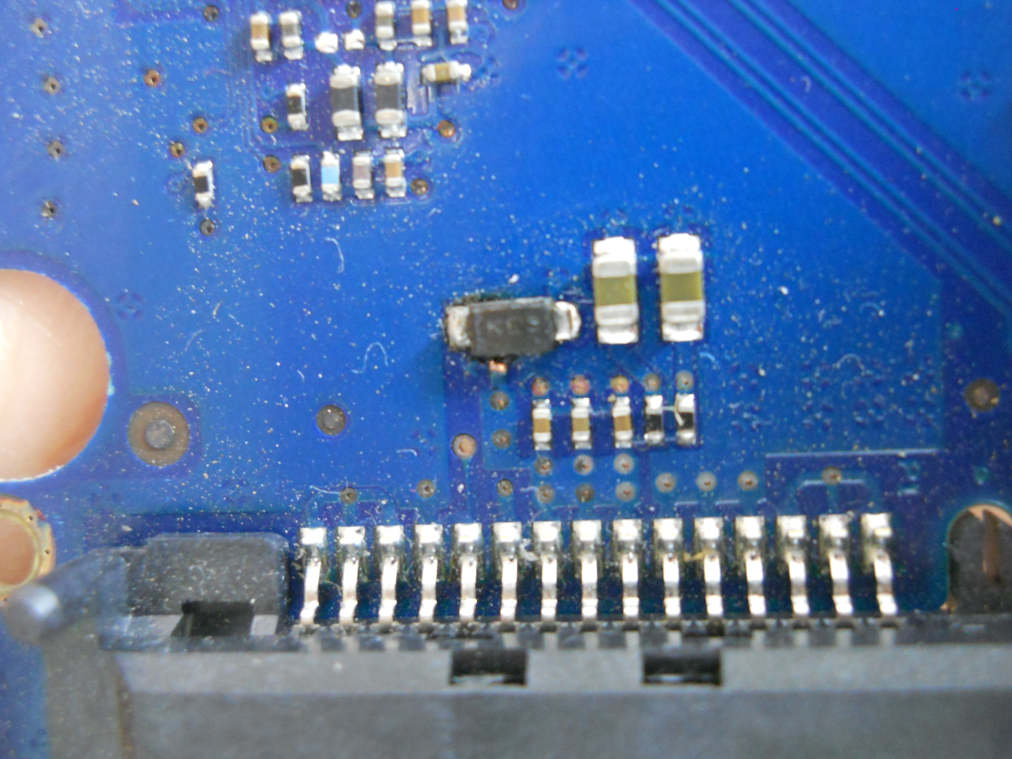

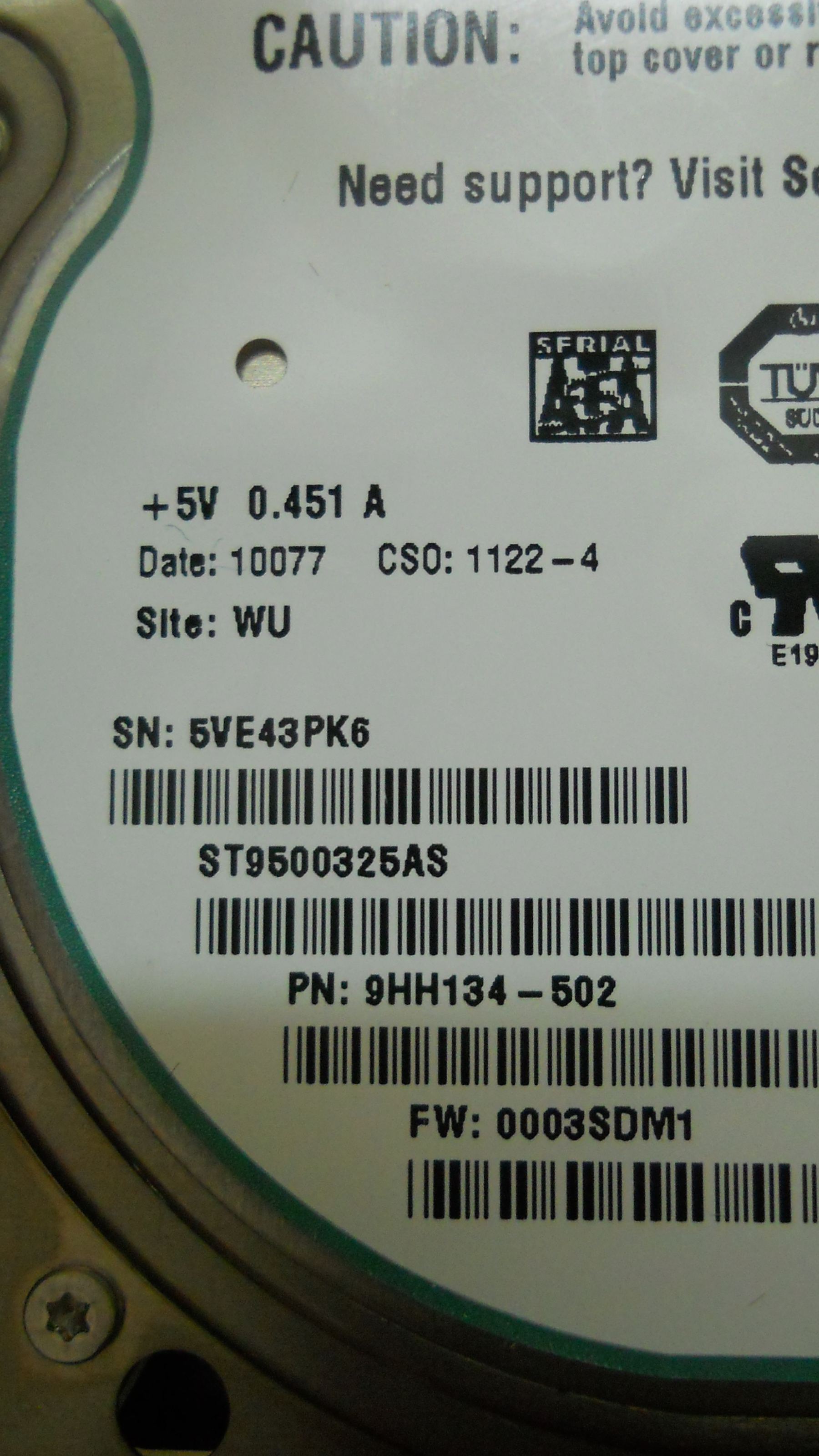

HD images please tell me if its repairable ? where is rom is there any idential board from which i don't need to replace the rom?
File comment: ic chip
File comment: disk
File comment: BURNED HERE
File comment: PCB

whats the next thing i can do? diode is blown away so if i remove it ? can i swap the diode but there is 1 c of damage in pcb too

in this pics where's the Rom?
Doomer is absolutely correct, all the PCB's on these are unique.
The ROM is the 8-leg chip top-right of the last pic, but be VERY careful indeed, these chips are very tricky to move and easily break.

Same disk model, but make sure PCB p/n is same also.

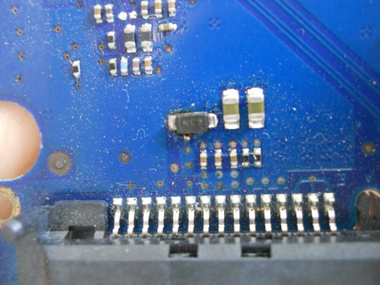

Use a digital multimeter (US$10) to measure the resistance of the 5V TVS diode (marking KE?) near the SATA power connector. Also measure the resistance between the ground and +5V pins at the connector.
You say that the "diode is blown away". What do you mean by that?

i think the diode is shorted .. i'm having another hhd board for diode but this one is IDE and the size of the diode is same its writting B2 on the top on IDE diode and XE5 OR KE5 on SATA diode (current disk)
should i just cut the diode and see if it spins?

i was touching the diode and it came off very clean both the legs were secure.
i thought i should try the disk without diode and i tried and still its not powering.
 Post subject: Re: Seagate 500GB (ST9500325AS) 5400rpm PCB Problem
PostPosted: April 7th, 2011, 7:03
Posts: 264
I can see in the picture you posted that the diode has burnt.
So even if you just remove the diode the Hdd should start working, no need to put another one. These diodes are for protecting drives from higher voltages and surges

still circuit is not complete to power it up.. oer there is some hinderance
PostPosted: April 7th, 2011, 7:13
Posts: 264
May be voltage is not reaching to the circuit.
check for any track breakage
