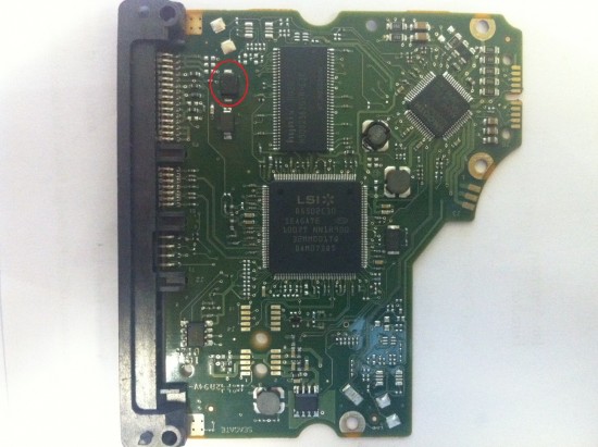

i need help with my hdd,
my hdd has been in my frozen car for a week and now it wont work,
if i plugg it, it smokes. So i have bolted the board on the back side of the hdd and seen that (in the added picture the red part) is broken.
I know that i can exchange the board with a new one, but 40€ is not little money.
So i need help of someone of you. If anybody can tell me what i can do and where i can buy this small part for the board please help.

Thats the 12v TVS Diode it is there for over voltage protection.
If your sure your PSU is ok you could try removing the faulty diode. If your lucky & theres no other damage the drive will work & you should copy off your data & then bin the drive.
40 Euros is cheap if it fixes your drive so you can get access to your data!!!
If you swap the PCB yourself you will need to desolder the 8 legged rom chip (bottom left on pic) & solder it on to the donor PCB. This rom chip has unique drive info.

Hey thank you very much, it works without this diode.
Can i use it for future without this diode? Or when i can have problems???

You should replace this diode, otherwise the drive now have no protection.

As I said it will no longer have over voltage protection.
You could buy a 12v TVS diode & solder it on if you want?
