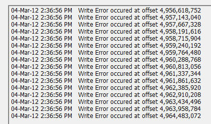

got an error during wipe out
& also when I run SMART, it also gave me an error that "not a native IDE or sata"
Since I did not suggest any "wipe out", I don't know what you are doing. Please ask for advice from the person who suggested that you did a "wipe out".
Some utilities cannot read the SMART data from disks attached via USB, but there are many utilities which support at least some USB-IDE bridges. You can try smartmontools and HDDScan, for example. There are many others. If you are unable to find a utility which is compatible with your USB-IDE bridge for reading the SMART data, then you may need to attach the IDE disk directly, to be able to do that.
