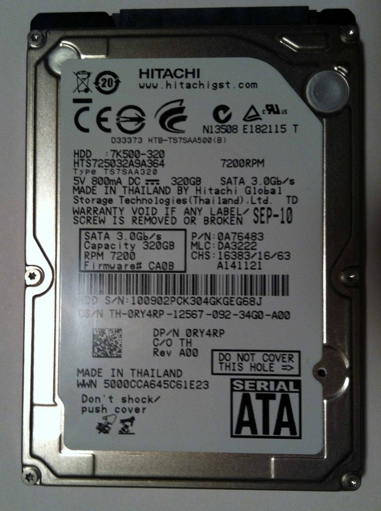

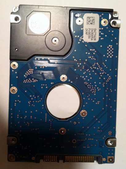

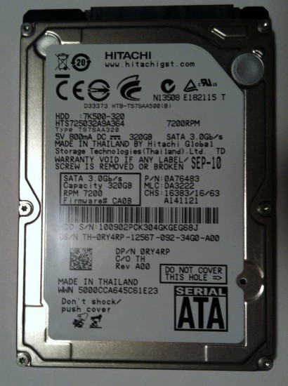

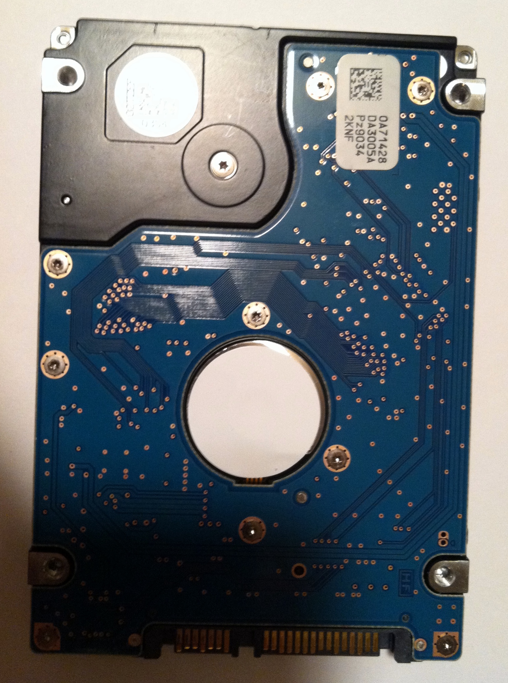

Also, here are photos of the exact drive in question.
I have another message with more details and also an MP3 of the noise the drive is making - it's waiting on moderator approval (I'm guessing because of the link to the sound file on arlo dot net slash harddrive dot mp3). Perhaps "clicking" was not the best choice of terms.

Sounds like stiction to me.
What you do now depends on how much you value your data.
No doubt you'll get advice on relieving this stiction by "percussive maintenance" and DIY crap like that.
By all means give it a go if your data is worthless, but if you value your data then take it to a pro, shouldnt be to expensive AT THIS STAGE before its tampered with.
Your data your choice!

Sounds like stiction to me too.
PCImage has given you the right advice here; if you value your data, consult a pro. Also, these attempts:

Agree with above opinions, sounds like a stiction.
Just fixed one today the same model and the capacity. :)

I just want to make sure this isn't an electronic board failure - can someone tell me that it's not the PCB (I wouldn't be hearing the clicking if it was the board, etc...)? I'd rather open the drive as a last resort. I am an electronics tech so I do have a DVM, soldering iron, o'scope, etc... Are there checks I can make to verify I'm not dealing with a board failure?
 Post subject: Re: Hitachi HTS725032A9A364 Drive Not Recognized
PostPosted: March 13th, 2012, 9:41
Posts: 1749
According to the sound uploaded. IMO I can definitely say it is not a PCB.
