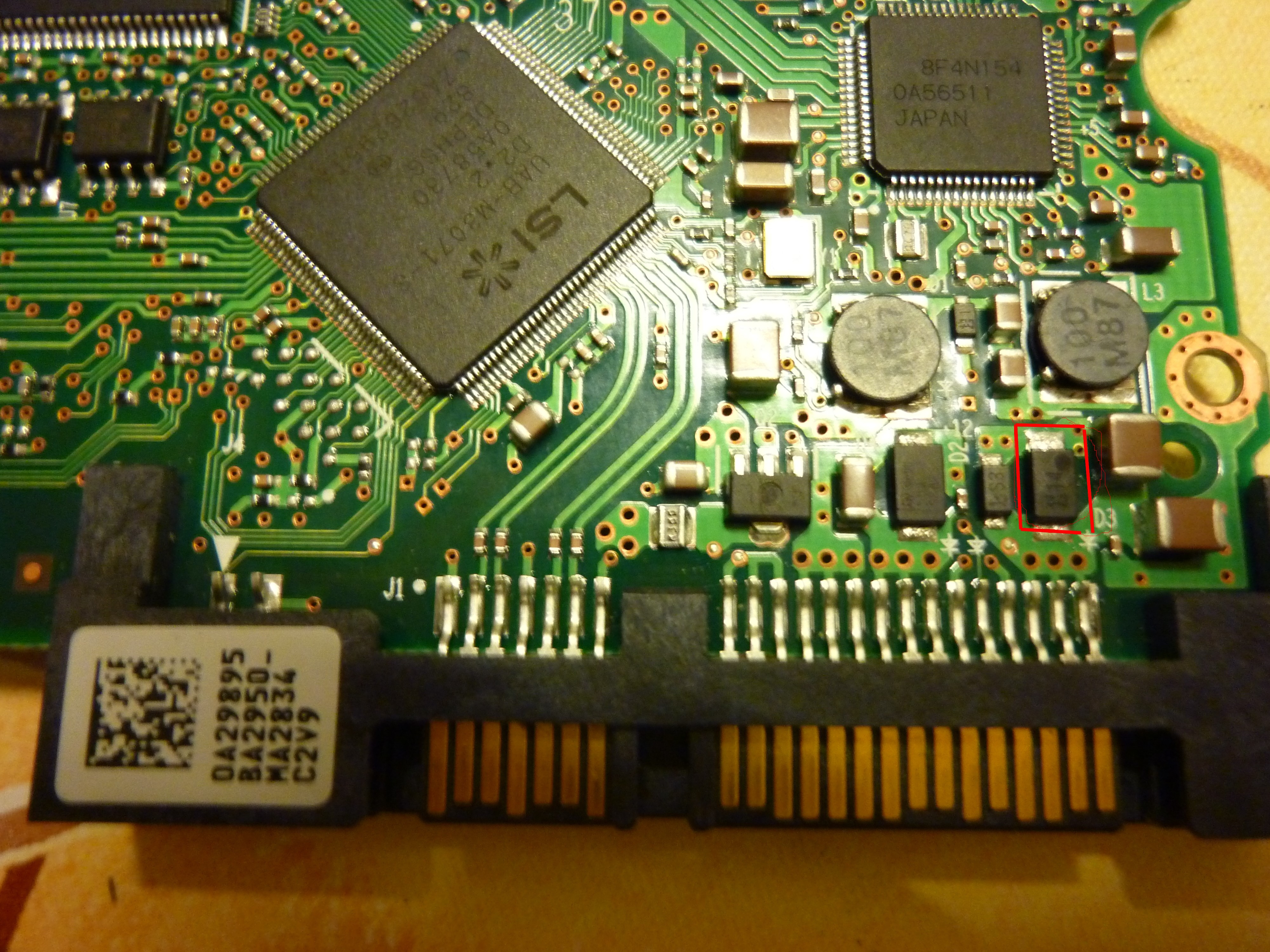

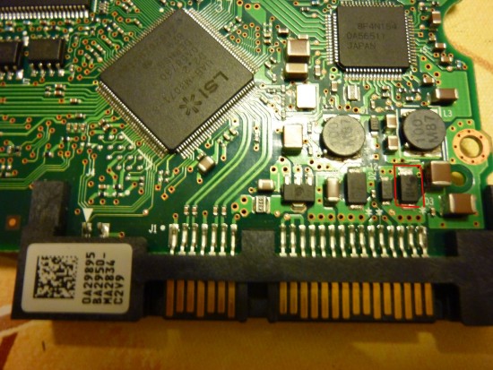

I tested the TVS diode near the power in, I detect a short when I test with an ohm meter on de PCB out of hdd. There is not other sign like burned part. This evening I'll try tu send a picture.
Thanks for your interest.

Remove the shorted diode. If there is no other problem with the PCB, then you won't need to visit the Hard Drive Market.
Good luck.
Many thanks for this advice, Fzabkar, I removed the diode and I could backup all the disk.
Here is the picture of the PCB, the diode is circled in red, so can help another guy.

I would have thought that the "L14" component was the 12V TVS diode. :?

File comment: This is the correct picture with the L14 tvs diode I removed
Oh sorry, you're right :oops: I removed the "L14" as you tell but I did a mistake when I circled in the picture.
So, the L14 I removed is at the right of the circled one, and is 12V.
