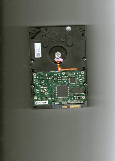

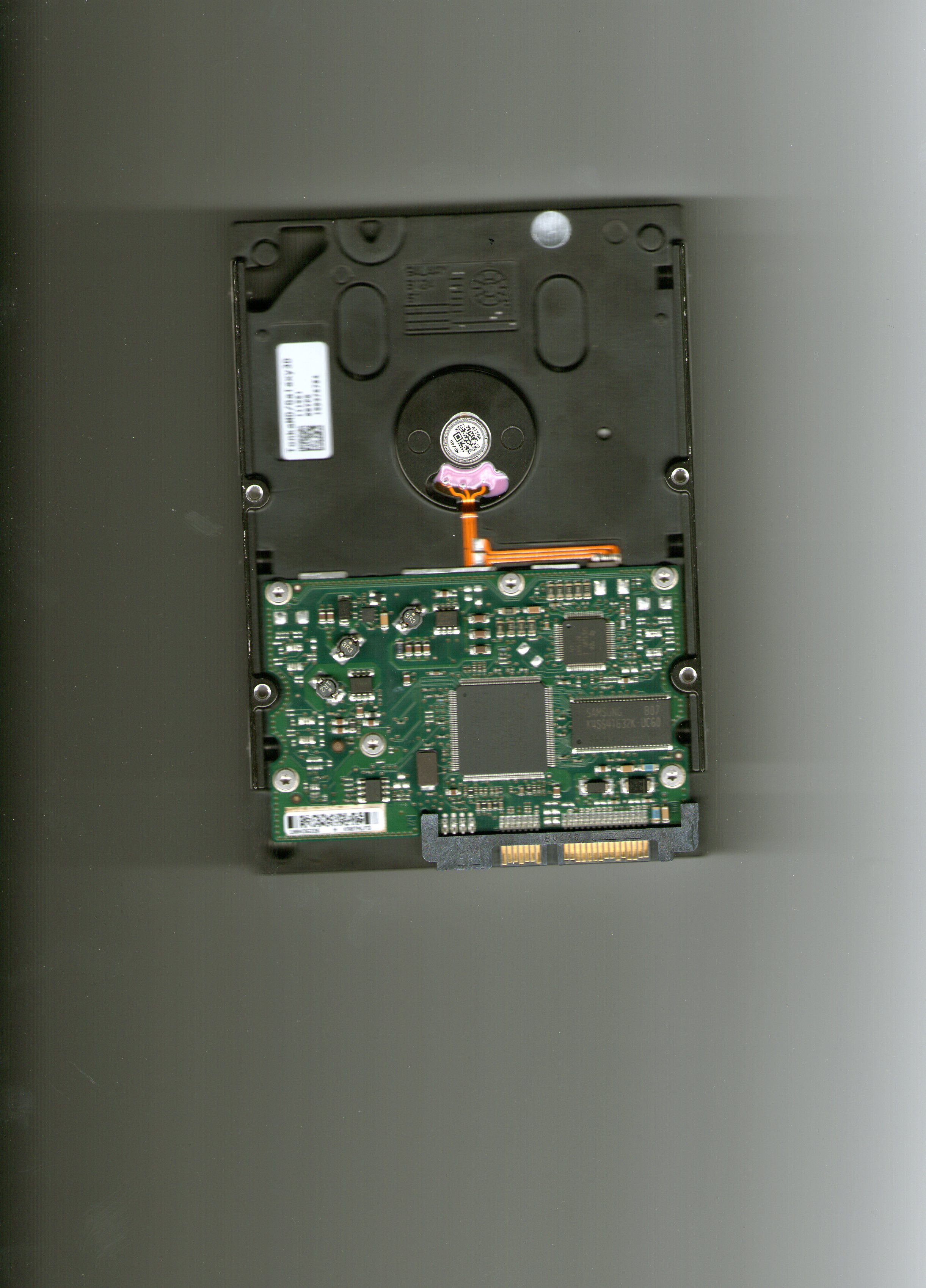

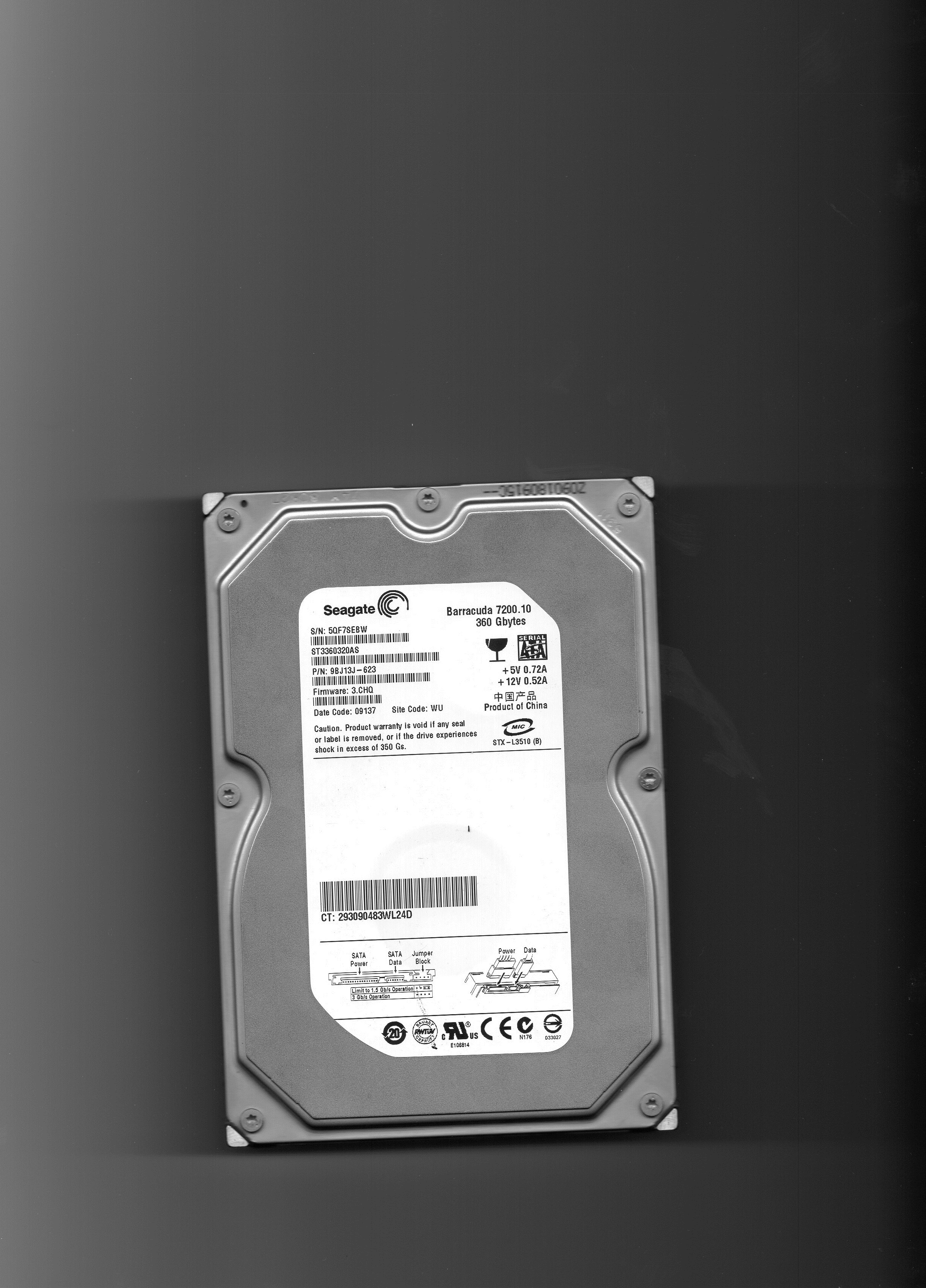

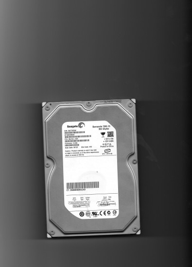

I think my PCB short circuited. When I connect it and turn on the PC, it doesn't not turn om. The power to the board switches off. I need help in making this PCB work as my data is in that HDD. I backed up until Jan but due to my laziness didn't do for feb and march :(
I am a programmer so you know the drill in coding from the start :roll:
I am attaching the scanned images of the HDD for some help from the experts. I searched in the forum and found this thread
seagate-st3360320as-damaged-pcb-t17369.html?hilit=ST3360320AS
In that it is mentioned to change the diode. How do I do that ?

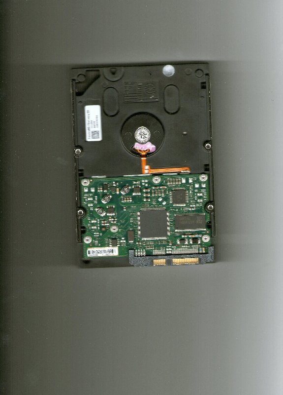

Check here if one is bad remove it. Try to cut it off do not pull it off. If you can not do this use a solder iron and remove the solder and take it off. Try not to damage your board more.
BTW one removed no more protrection on your PCB on this one. Get off what you need and would think that you would protect the HDD with a surge protector when doing this one. One short and your entire drive might die this time and you might need heads after this one. Take care in this one
Sorry circlied the two in read but might have to download it does not show up too well here in this image. Anyhow can not see the red on this one. There are the two right under your large SATA connector. Directly under this one you have one large and one small and they are the HDD TVS. Check them one is 5v and the other is 12. Find out which one is bad and remove it.
