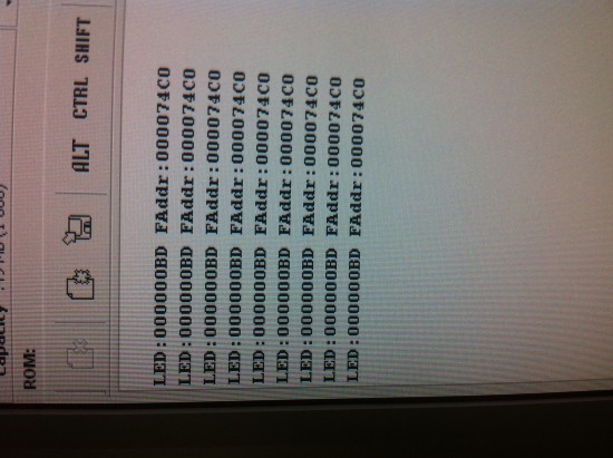

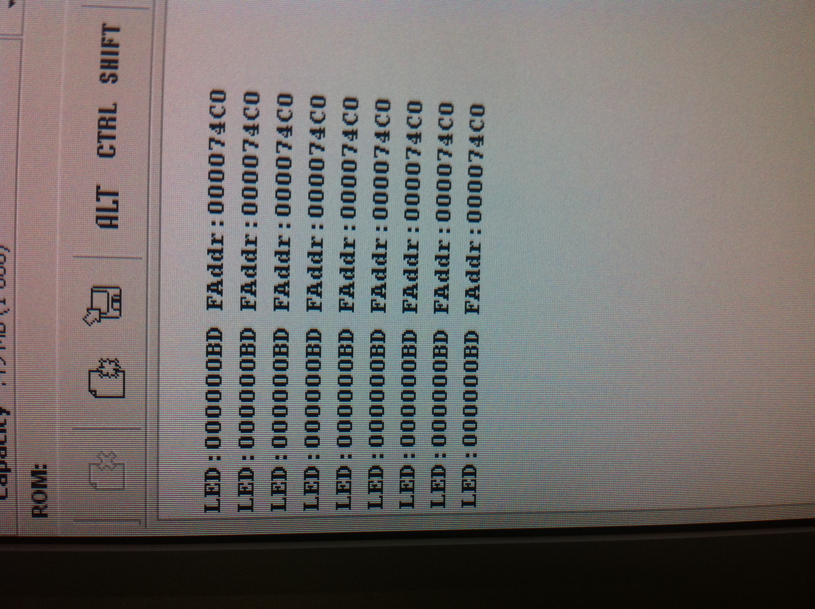

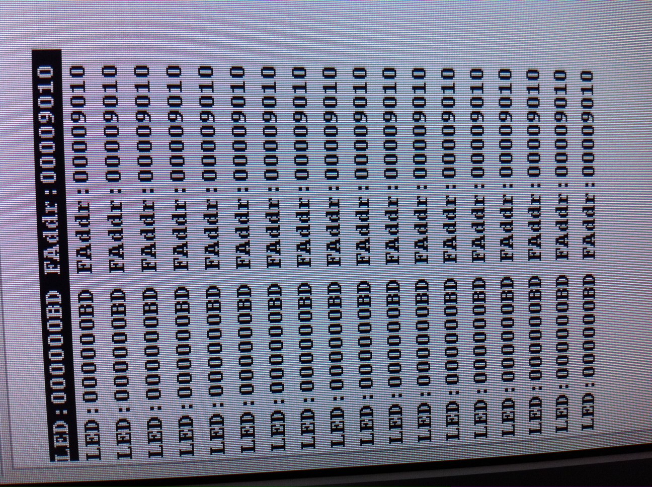

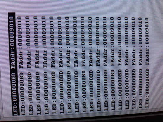

this problem is due to firmware corruption, you can see output in terminal similar to LED: 000000BD FAddr : 00009010 or LED: 000000BD FAddr : 000074C0
there is a solution..... pls pm if you have problems with it.
