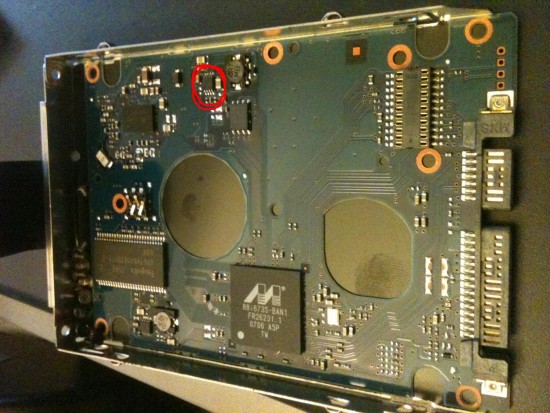

I'm hoping to have some success repairing a Hard Drive to recover data. The hard drive hasn't been backed up for a few months so this isn't a Severe case scenario. The amount of data that has been added the past few months is limited, but this is a worthwhile project to try and attempt to restore it. At the moment, the hard drive will not power up! Silence, nothing! I tried connecting to 3 different sata power sources with the same result.
The laptop hard drive is out of a Lenovo laptop. The numbers on the hard drive are as follows:
FUJITSU
MADE IN THAILAND
MODEL: MHV2120BH PL
PART NO: CA06672-B216000L
SER. NO: NW9ST7428V56
DATE: 2007-04-17
REV. NO: A (0 AND 1 with doublestrike) 2 3 4 5 6 7 8 9
0BCB1B-0084002A
I have read that swapping the PCB board might be a good first attempt, so I purchased the following PCB board off of Ebay. (note: I have highlighted identical values in blue)
DISK DRIVE: MHV2120BH PL
SER NO: NW9ST7126F2N
DATE: 2007-01
LBA: 234441648
CAP: 120GB
SATA
REV.NO: A (DOUBLE LINE THROUGH 0) 1 2 3 4 5 6 7 8 9
0BCBEC-00840029
Board number on label: VBT6ZS8B17 (appears to be a serial number of some sort)
Board number on PCB (T): CA26338-B74104BA
Controller chip: 88i6735-BAN1
I'm currently awaiting the PCB to shipped to my house for the swap. After searching this forum, it appears that it's wishful thinking to try and do a simple swap. I'm curious what my options are at this point. I'm not a Hard Drive professional, but I'm somewhat technical so I may be able to try and repair parts on the defective board with the new one. Any tips or suggestions? I would like to budget up to $100 bucks for this project. I currently have about $30 on the new board. I just need to get this drive turned on one last time to do a data extract! ;)
I appreciate any info. Thanks alot!
File comment: Here is a pic of the defective PCB board

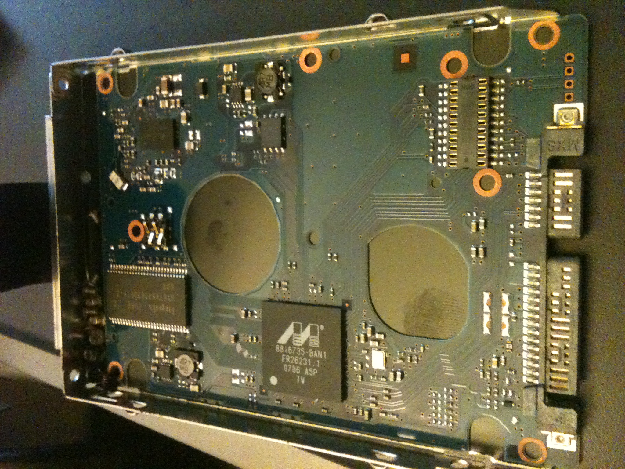

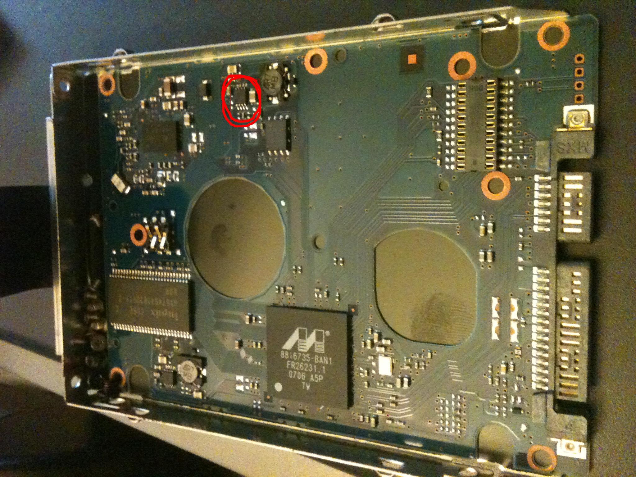

Damn It!...
After searching the forum for over an hour, i tried testing my "fuse" with a multimeter and sure enough it was short. I bypassed the fuse and my Hard Drive powered up! =D. I quickly attached it to my desktop to try and copy over data and I noticed it was terribly slow!!!!
I felt the hard drive and it was burning hot! I quickly powered down and let it cool off. Went ahead it hooked back up and it started smoking :( ...
Opened it up and it appears this chip is burnt!... I highlighted the burnt chip in the pic below... This sucks!... :oops: what now?...

The nearby 4R7 coil would suggest that the circled component is a MOSFET in a switchmode regulator. There is a similar regulator at the bottom of the board.
I would expect that one regulator provides the Vio supply (+3.3V or +2.5V) for the MCU, SDRAM, and flash memory.
The other regulator would provide the Vcore supply (~1.2V ?) for the MCU.
The chip located at 4 o'clock to your circled component looks like it may be a serial flash memory. If so, then you may need to transfer it to your donor PCB. Could you tell us its markings?

The idea about "bypassing" the fuse was yours or did you read it "somewhere" ?
If things are fitted, there's a reason for it, and usually on equipment there's a warning about fuses : "REPLACE WITH SAME TYPE AND RATING" and this was no exception - hard wire or solder blob is not exactly a replacement.
I don't understand this. A functional fuse should show zero ohms or continuity! So what and how did you bypass before powering on?
