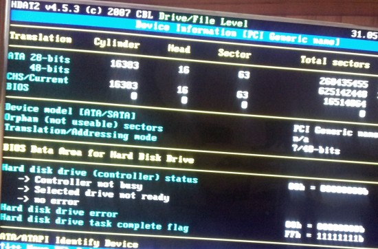

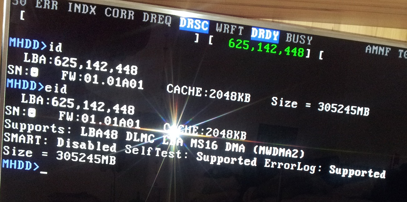

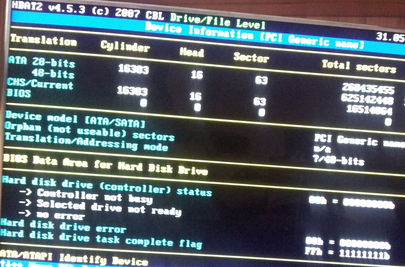

yesterday I tried to update the firmware of my WD drive in order to use it with my Xbox. For some reason the updated failed. So now it seems I have very limited access to the drive.

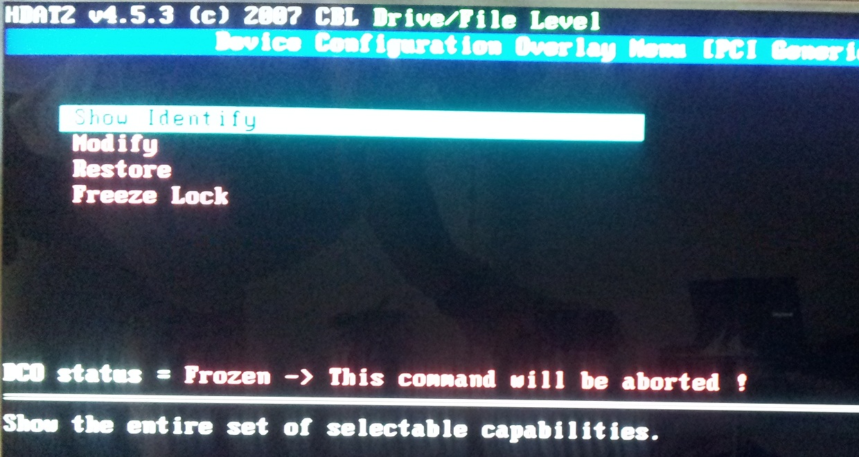

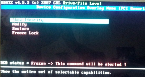

windows device manager only says "drive" without further information. I can see the hard disk with tools like MHDD or HDAT2. But I dont seem to be able to do very much with them. At one point HDAT2 says "DCO status = frozen"

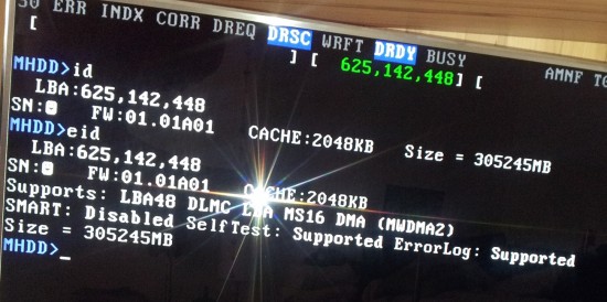

There must be some kind of communication to the drive though. Like if I select erase under MHDD it apparently tries to reset the drive and yet I can hear a click sound from the drive...
is there anything I could still try to do except putting it into the trash?

DCO frozen state is not an issue at all. It's one of the normal states of a drive
what if its disabled?..what impact on the drive would that have?

OK, but I can not create a partition any programs.. error inputs / outputs ?? Drive is somehow locked (?) it is not password?
When I want to create password/erase by mhdd - "fail", scan - "! ABRT", create partition - "no access error inputs/outputs"
