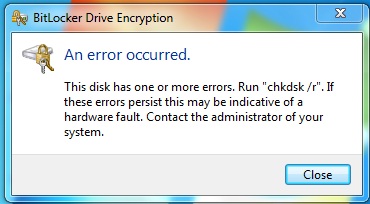

I've a 500GB Hard Drive of WD Cavier Blue
And this Hard Drive is all ready full.
Few days ago, I just turn the Bitlocker on. After Encrypting 19 or more System says to do "Chkdsk /f" and try again. But tried to do that, i'm failed to do.
Now I can't open the Hard Drive.
Please give me a way to get my Data.

Did checkdisk actually run? As in did you see a progress process fixing anything?

suggestion to run chkdsk /r shows that the drive has bad blocks you disk is failing physically
In the Process of Checking, it's says "Invalid Parameter".

ur case may have degraded head or bad blocks, in this situation never run chkdsk which will degrade the case more, even may be make it worse.

Clone it with DMDE or HDClone (or DD if you're familiar with linux)
