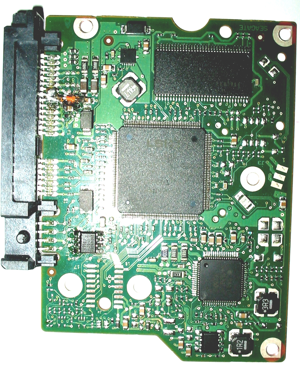

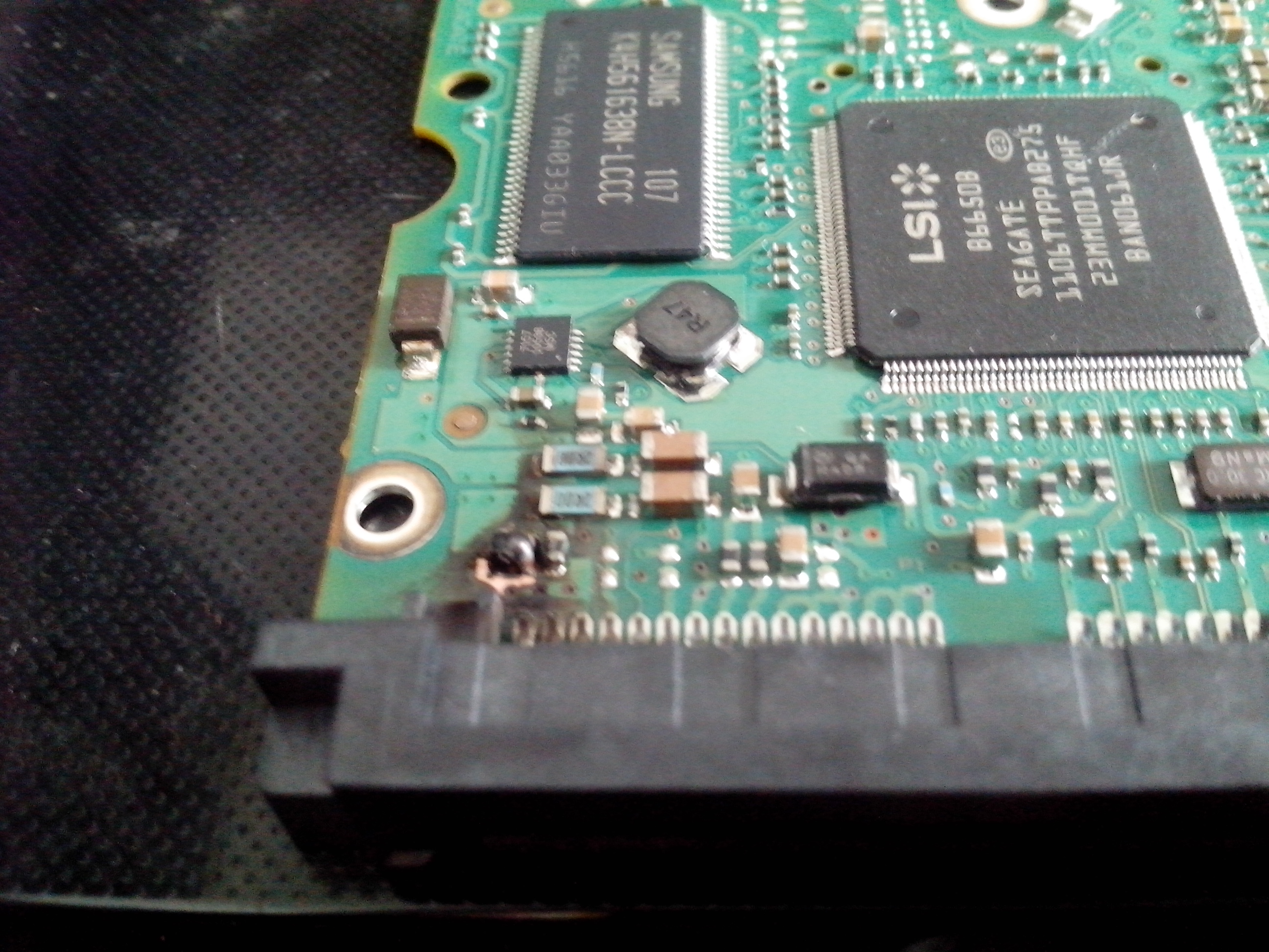

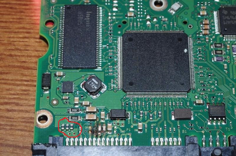

Hello, i've this Seagate ST1000DL002 with burned PCB.
PCB number is 100617465 REV B
I'm going to repair it with wire wrap and capacitor substitution (but i don't know it's value), someone does it know the value of the capacitor indicated in the pic?
There are also 2 destroyed fuse, but i don't care because i'm goin to substitude them with wire wrap, i nedd your help for the capacitor value. Does any of you know the value?
Thank you.

 Post subject: Re: Seagate ST1000DL002 burned PCB 100617465 REV B
PostPosted: July 27th, 2012, 13:29
Pessima idea. Auguri.
Really bad idea. Good luck.

If you not sure which parts are needed, get a new PCB.

Perchè pensi che sia una pessima idea?
Sono bravo con l'elettronica
Why do you think it's a bad idea?
I'm good with electronics
I just need to know the capacitor value, and i can bypass the 2 microfuse with wire wrap.
I don't care if the pcb will burn more, in case i buy a new one.
I have soldering iron, hot air soldering gun, multimeter, capacitor tester, wire wrap and a lot of practice in SMD micro electronics

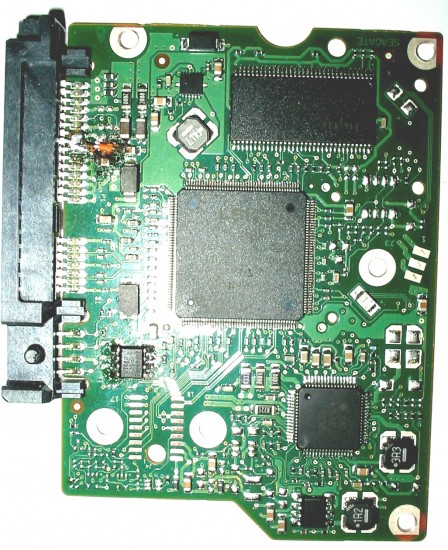

PostPosted: July 28th, 2012, 13:24
Posts: 1768
Location: Verona, Italy
I substituted the capacitor with onother of 10uF (micro farad).
Instead of 2 microfuse i put 2 wires (one cannot even see in the pic), rebuilding at the same time the tracks burned.
PostPosted: August 9th, 2012, 9:54
Posts: 1768
Repaired :D
I substituted the capacitor with a good 10 uF capacitor and the TVS 5 volt diode.
2 microfuse are impossible to substitute, so i put 2 wires.

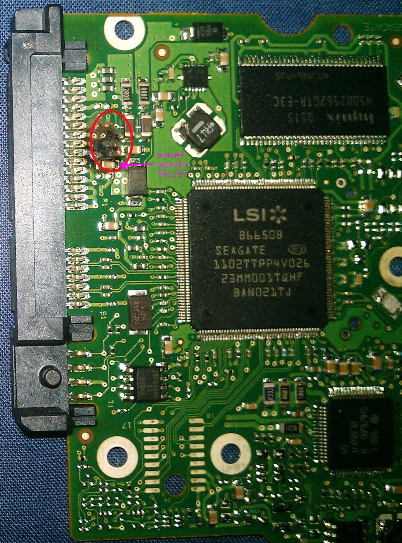

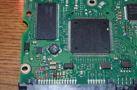

Hi Michael,
Congrats on your HDD recovery. Thankfully, I ran into this post after my HDD PCB failed a few months ago, with the exactly same blown caps.
I replaced the SMD caps, but the motor still isn't spinning. You mentioned micro fuses; can you tell me where they are please?
Thanks!
PostPosted: October 18th, 2012, 4:05
Posts: 1768

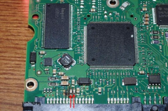

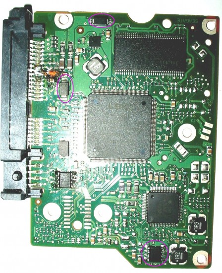

Look at the 2 red arrows, those two are microfuse

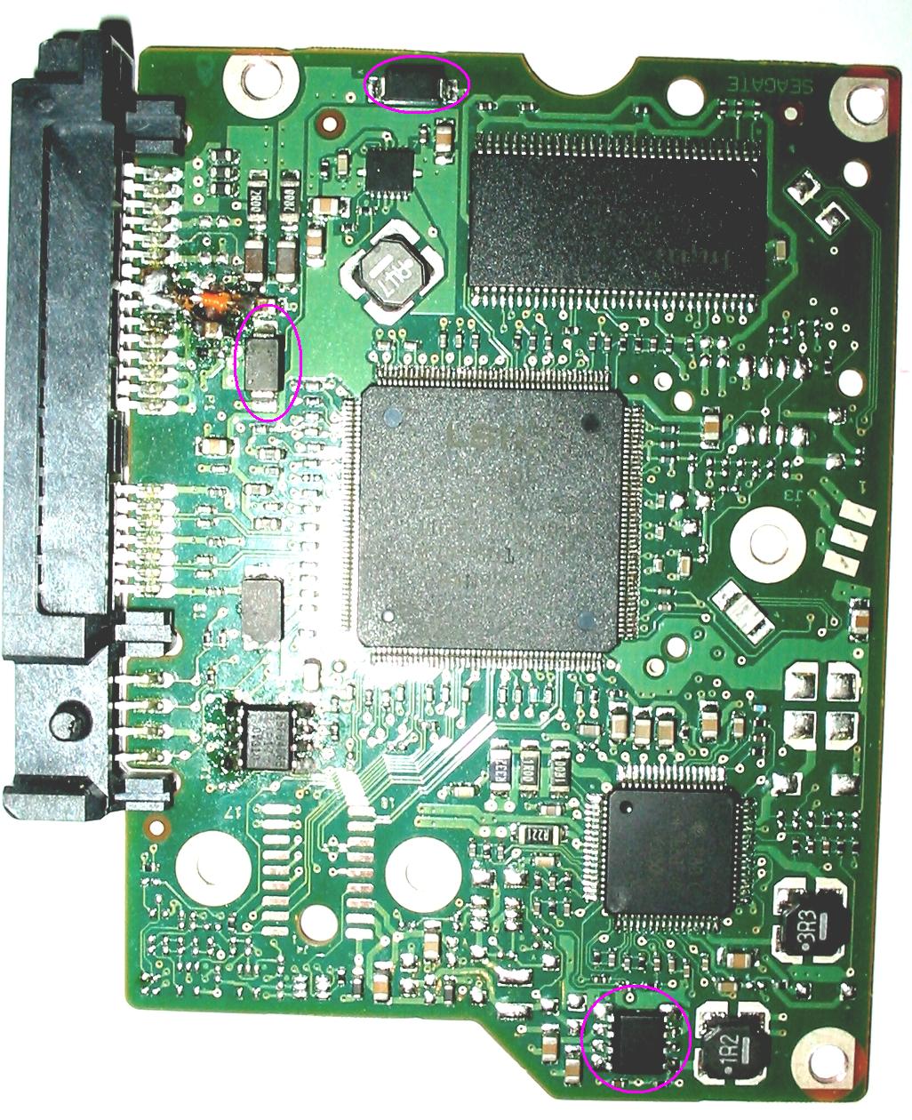

Don't forget to check the 2 tvs diodes and the mosfet, look at the pic in the bottom.
Good luck :wink:

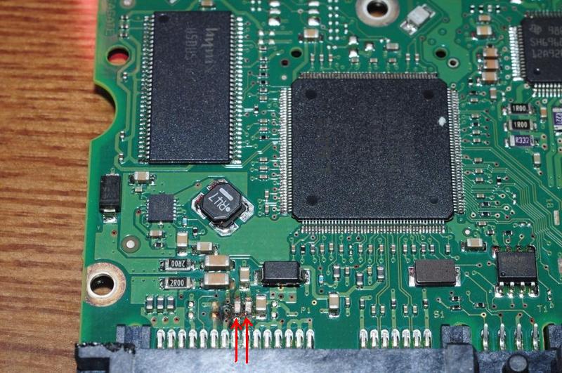

Thanks for your reply.
However, I'm still not so sure of the microfuses. The arrows you put point to the two SMD caps I've replaced...
Here's a better picture:
Appreciate it!
PostPosted: October 26th, 2012, 11:09
Joined: May 6th, 2008, 22:53
Posts: 2138
It would help if you explain how you decided that they are capacitors.
If they are in series with the +5V supply, which they seem to be on that photo (you'll have to check yourself, since you have the PCB in your hands and I don't!) then they cannot originally have been capacitors.
Doh! Yeah, I hastily confused the black microfuses with SMD caps.
I haven't realized that these black things were fuses; I didn't know they even exited!
Warming up the soldering iron again... :lol:
Thanks mate!

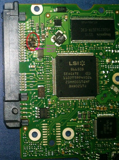

here see in this picture about repairing this pcb . in your pcb two fuse are burn and 1 diode .
see this picture

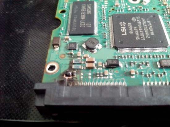

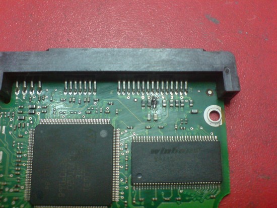

PostPosted: February 4th, 2014, 8:28
Joined: February 4th, 2014, 8:16
Location: Brasil-MG-BH

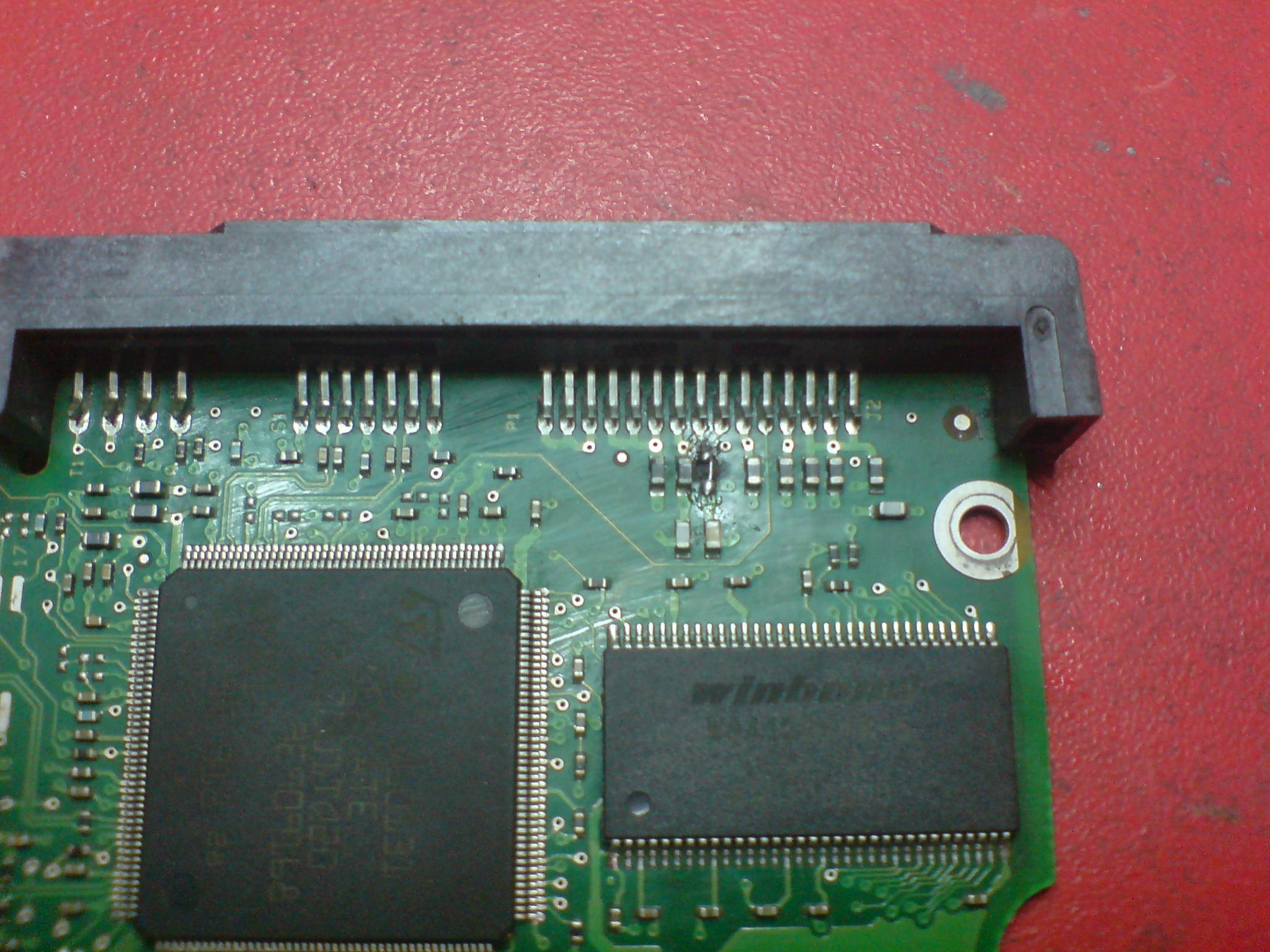

I do not speak English.
I'm from Brazil.
My HD spoiled / damaged
I use a case for HD.
Someone connected cable notebook 19 volts.
My case uses 12 volts.
Two capacitors burned. I will post photo.
THAT HAS REPAIR? THIS IS SOLUTION?

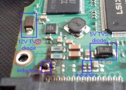

PostPosted: February 4th, 2014, 16:06
Posts: 17328
Remove the 12V TVS diode. It will be shorted.
