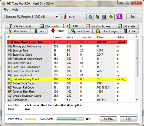

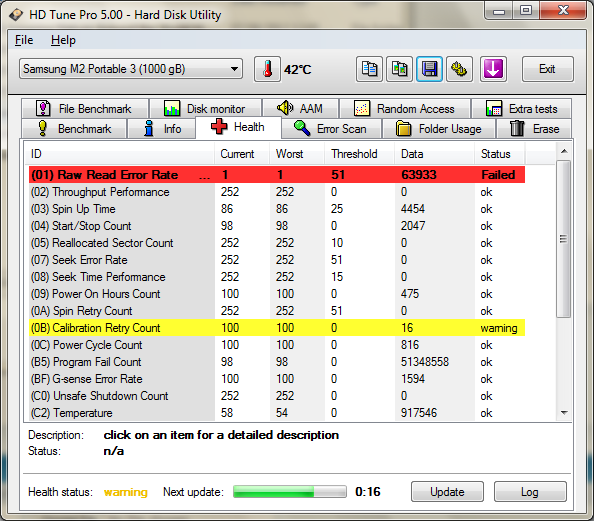

hello i bought m2 1 tb in January suddenly it is not working properly it corrupted the folder lock locker of 250 gb today i check the smart it show this errors please share you experience
HD Tune Pro: Samsung M2 Portable 3 Health
ID Current Worst ThresholdData Status
(01) Raw Read Error Rate 1 1 51 63933 Failed
(02) Throughput Performance 252 252 0 0 ok
(03) Spin Up Time 86 86 25 4454 ok
(04) Start/Stop Count 98 98 0 2047 ok
(05) Reallocated Sector Count 252 252 10 0 ok
(07) Seek Error Rate 252 252 51 0 ok
(08) Seek Time Performance 252 252 15 0 ok
(09) Power On Hours Count 100 100 0 475 ok
(0A) Spin Retry Count 252 252 51 0 ok
(0B) Calibration Retry Count 100 100 0 16 warning
(0C) Power Cycle Count 100 100 0 816 ok
(B5) Program Fail Count 98 98 0 51348558 ok
(BF) G-sense Error Rate 100 100 0 1594 ok
(C0) Unsafe Shutdown Count 252 252 0 0 ok
(C2) Temperature 58 54 0 917546 ok
(C3) Hardware ECC Recovered 100 100 0 0 ok
(C4) Reallocated Event Count 252 252 0 0 ok
(C5) Current Pending Sector 100 100 0 86 warning
(C6) Offline Uncorrectable 252 252 0 0 ok
(C7) Ultra DMA CRC Error Count 200 200 0 0 ok
(C8) Write Error Rate 100 100 0 381 ok
(DF) Load/Unload Retry Count 100 100 0 16 ok
(E1) Load/Unload Cycle Count 99 99 0 12882 ok
Health Status : warning

Can you check with another SMART tool to ensure the reading is consistent?

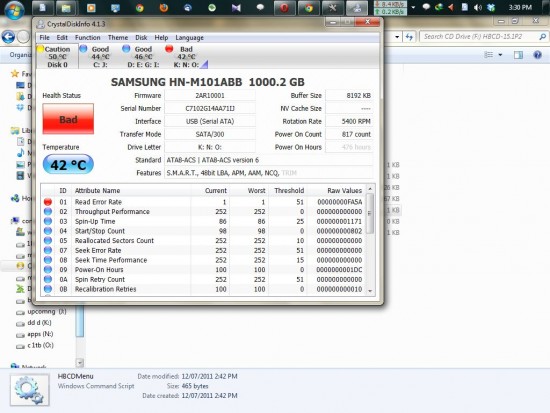

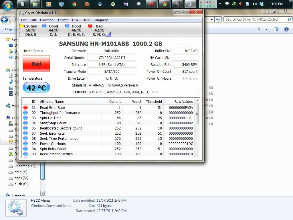

CrystalDiskInfo 4.0.3 (C) 2008-2011 hiyohiyo
Crystal Dew World : http://crystalmark.info/
(4) SAMSUNG HN-M101ABB
Enclosure : Samsung M2 Portable 3 USB Device (V=04E8, P=60C6, sa1)
Model : SAMSUNG HN-M101ABB
Firmware : 2AR10001
Serial Number : C7102G14AA71IJ
Disk Size : 1000.2 GB (8.4/137.4/1000.2)
Buffer Size : 8192 KB
Queue Depth : 32
# of Sectors : 1953525168
Rotation Rate : 5400 RPM
Interface : USB (Serial ATA)
Major Version : ATA8-ACS
Minor Version : ATA8-ACS version 6
Transfer Mode : SATA/300
Power On Hours : 476 hours
Power On Count : 817 count
Temparature : 40 C (104 F)
Health Status : Bad
Features : S.M.A.R.T., APM, AAM, 48bit LBA, NCQ
APM Level : 0080h [OFF]
AAM Level : FE00h [OFF]
-- S.M.A.R.T. --------------------------------------------------------------
ID Cur Wor Thr RawValues(6) Attribute Name
01 __1 __1 _51 00000000FA5A Read Error Rate
02 252 252 __0 000000000000 Throughput Performance
03 _86 _86 _25 000000001171 Spin-Up Time
04 _98 _98 __0 000000000802 Start/Stop Count
05 252 252 _10 000000000000 Reallocated Sectors Count
07 252 252 _51 000000000000 Seek Error Rate
08 252 252 _15 000000000000 Seek Time Performance
09 100 100 __0 0000000001DC Power-On Hours
0A 252 252 _51 000000000000 Spin Retry Count
0B 100 100 __0 000000000010 Recalibration Retries
0C 100 100 __0 000000000331 Power Cycle Count
B5 _98 _98 __0 0000030F8948 Unknown
BF 100 100 __0 00000000063E G-Sense Error Rate
C0 252 252 __0 000000000000 Power-off Retract Count
C2 _60 _54 __0 003A000E0028 Temperature
C3 100 100 __0 000000000000 Hardware ECC recovered
C4 252 252 __0 000000000000 Reallocation Event Count
C5 100 100 __0 000000000056 Current Pending Sector Count
C6 252 252 __0 000000000000 Uncorrectable Sector Count
C7 200 200 __0 000000000000 UltraDMA CRC Error Count
C8 100 100 __0 00000000017D Write Error Rate
DF 100 100 __0 000000000010 Load/Unload Retry Count
E1 _99 _99 __0 000000003261 Load/Unload Cycle Count

The hard drive is deteriorating by developing bad sectors, making data on it inaccessible.
Best course of action is to clone your drive to another healthy drive and then recover your data.
Can use the search function for "cloning" to see threads on how you can do this.
Power the drive off until you have a solid plan on how you will do this. Best option is for a professional with the proper hardware/software to do this.

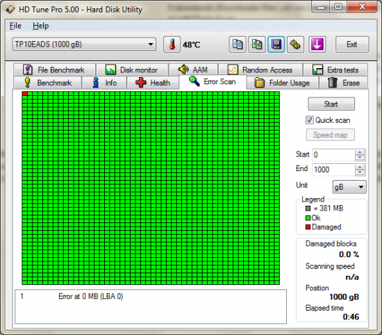

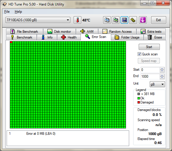

MY wd 1tb sata 6gb's mbr was deletd due to bad sectors and now this samasung TB get bad sector too.

I discussed some of your previous drive problems with you, in your earlier threads.
IMHO it is clear that something you are doing, or something in your environment (including power, as we discussed before), is causing you to suffer from similar problems with so many different drives.
Are you using a UPS now? If so, has that stopped the unplanned power losses for your PC & external disk drive(s)?
Without TV cameras following you, to watch everything you do with these drives, I don't know how we can accurately diagnosis your problem remotely. :(
