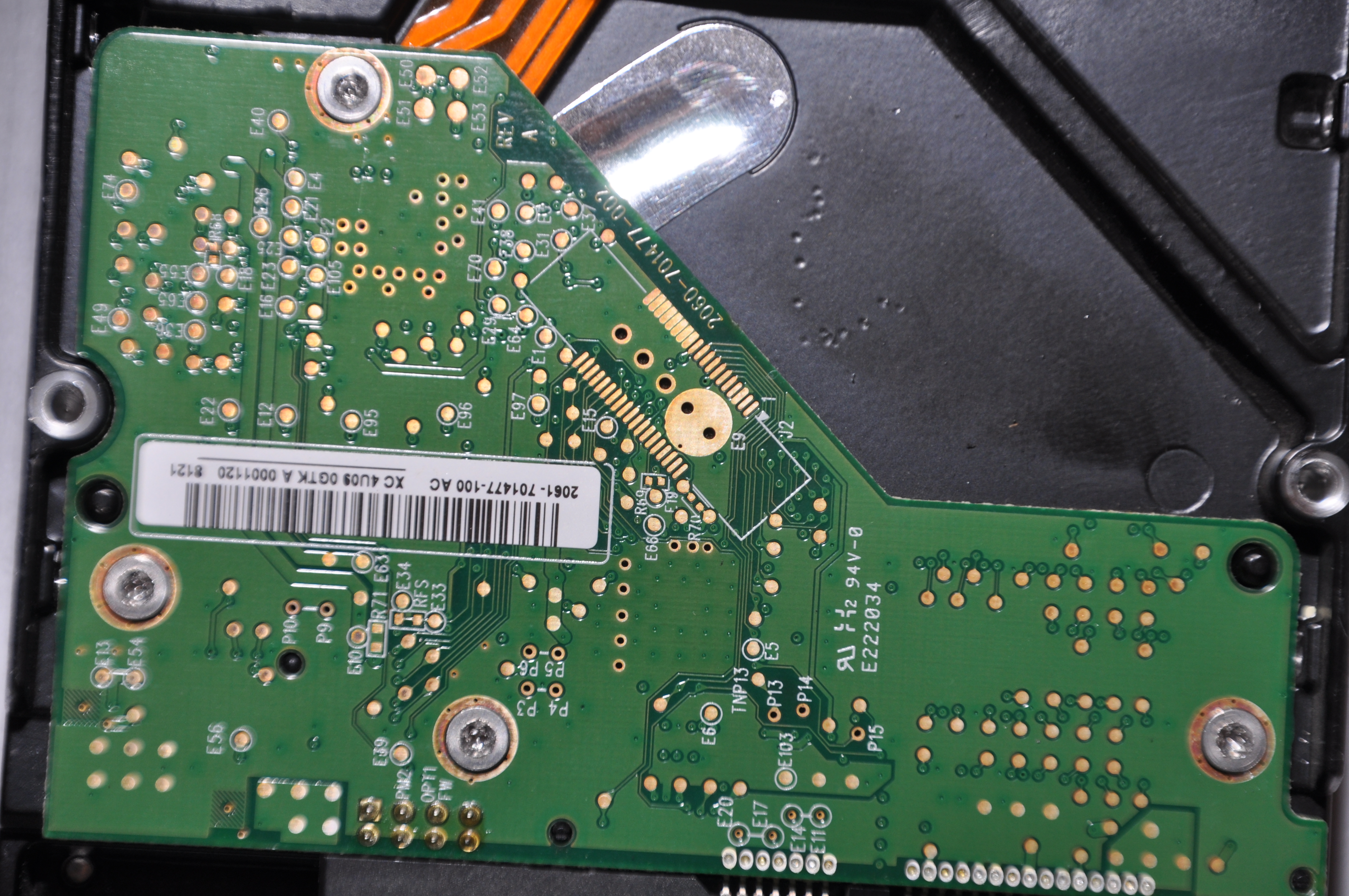

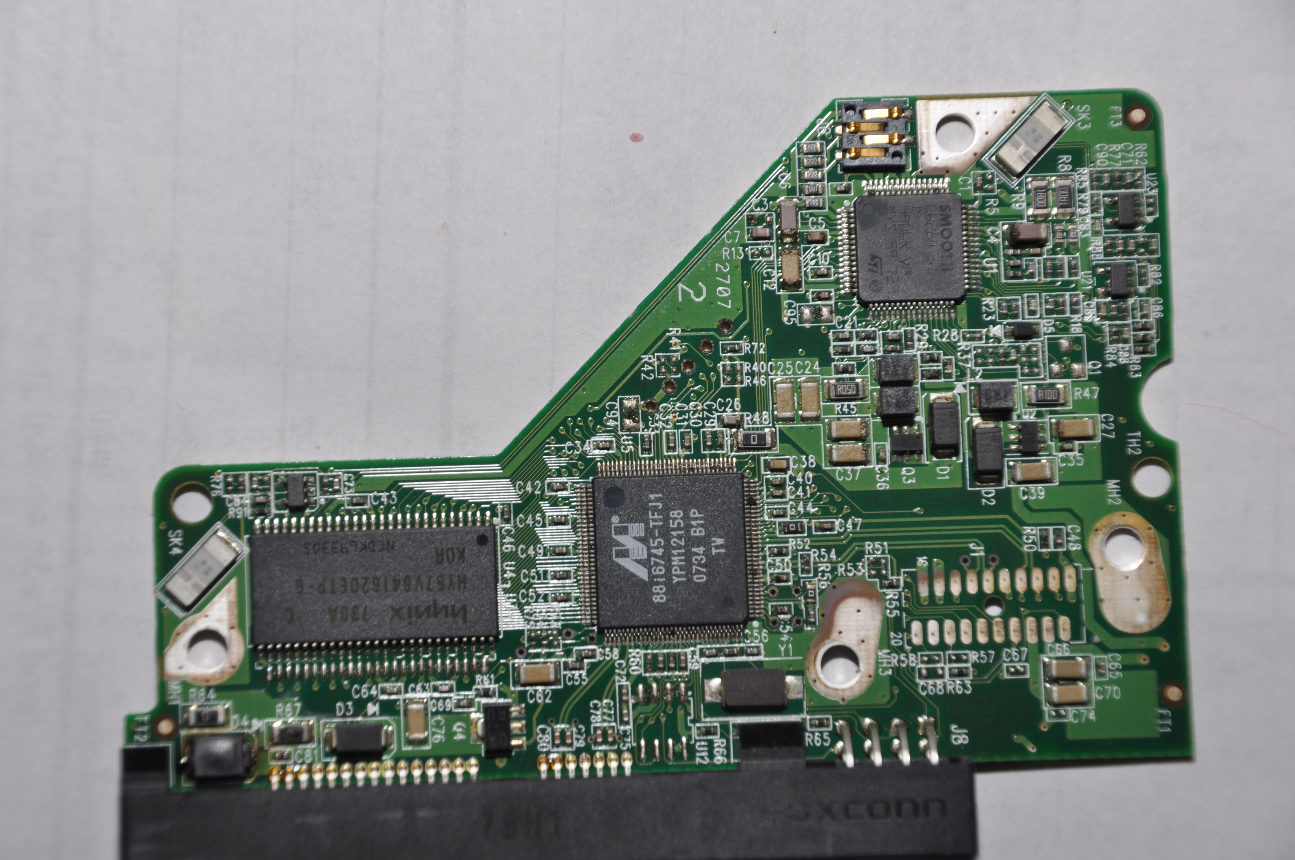

Hi! I'd like to try to replace SMAJ5.0A TVS diode on my PCB for the WD4000AAJS hard drive. How can I find it on the board and how it is marked?
Thanks in advance.

Diode at D4 looks damaged
 Post subject: Re: WD4000AAJS HD. PCB TVS replacing.
PostPosted: June 6th, 2012, 0:41
Posts: 17384
Agree, in which case an SMBJ12A would be a suitable replacement, not SMAJ5.0A.
... and http://www.users.on.net/~fzabkar/HDD/bi ... diodes.jpg

Thank you everyone for the answers. I am not 100% sure if it is one of those diode but I suspecting this. The multimeter diode test show me the following results:
D3 (=5v) resistance: 0.L, 0.5
D4 (=12v) resistance: 0.0, 0.0
so I am assuming that D4 is died. As fzabkar pointed it is SMBJ12A diode.

Yes, D4 is shorted (i.e. failed), as labtech and fzabkar discussed above.
