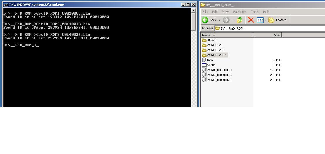

for some of us here it might be useless but really i came up with this idea since am too lazy
to check it in Winhex and asked my Developers (Partners) to do it and save some of my time here
i would like to share it with you guys here...
next release will be even much better
Thank you forum members/Admins
:wink: :wink:
:yayaya:
file can be downloaded from here: http://files.hddguru.com/download/Other ... dentifier/

From what I see it's .Net app (that probably won't work in DOS mode as specified) and it support some WD flashes

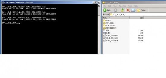

it should work my dear if you have .net 2.0 or later
have a look

it definitely should, in command prompt, you probably meant that
I wonder what's the practical value of this program
It returns internal version of the first found module with ROYL header, I might be missing something here but I cannot come with any idea where I could actually use that kind of information

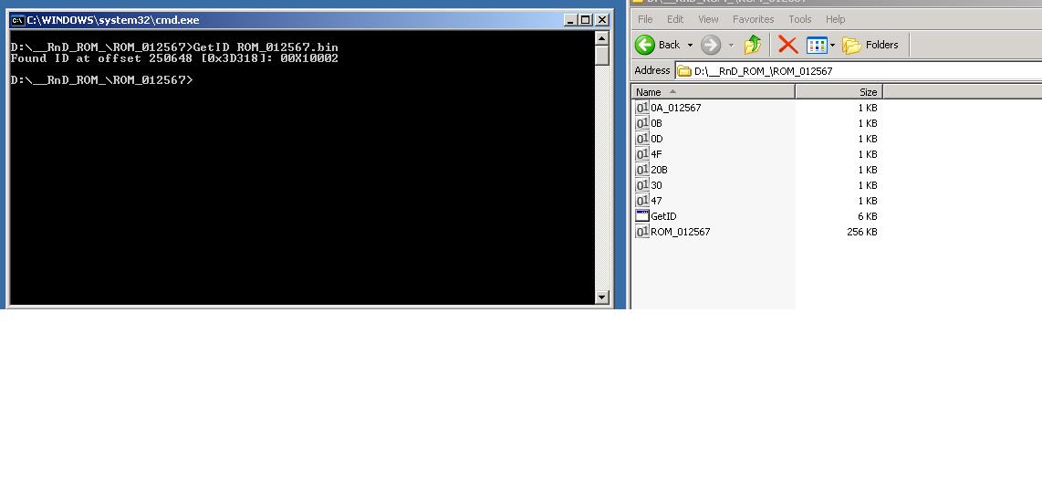

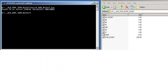

Oh, I think I figured that out
You need add additional check for Module ID. The module ID you are looking for is 4F :)
Because on the picture you are getting it from module 0A :)

yes, for the ROM revision you need to add Module ID check
Because right now it doesn't work

Doomer's (correct) point is that it is not returning the correct answer

i guess guys and you too Doomer are right
will ask my developer about that
