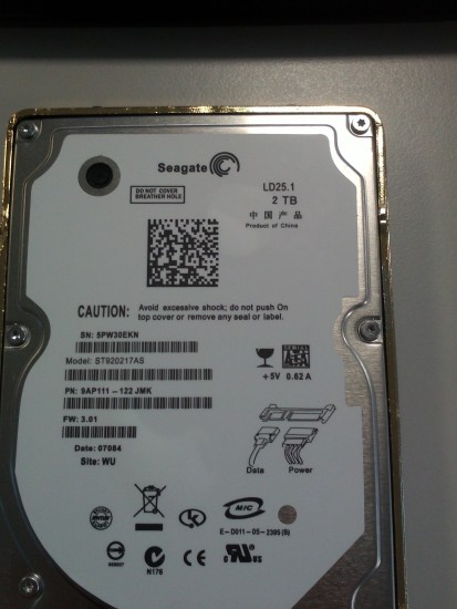

Hi, I've a toshiba canvio 2tb 2,5' usb 3.0.
It doesn't work. I try to erase partition, all is ok. I try to format, stop after some minutes with "impossible to format" from windows xp/7/ manage disk/partition manager.
Toshiba doesn't provide tool for this hd.
If I try to create and format a partition with around 19gb, all is ok: partitioned and formatted.
Biggest partition is impossible.
HD Tune Pro says there are some bad sector. Error check stop after 19gb.
I try hdd low level format, and it stop at sector 39,264,128. All is ok until that sector, after led on hard disk stop, tool freeze.
All the test with usb 2.0.
Anyone can help me?

Fake?
EBay china purchase?

Good point - I have not seen a Toshiba 2.5" 2TB disk drive...

Hehe, another one like this:
or this:

Mi sa che trattasi di SOLA.... 8)
I have a feeling it is a FAKE..... 8)
 Post subject: Re: Toshiba canvio 2tb 2,5' usb 3.0 SERIOUS PROBLEM
PostPosted: August 29th, 2012, 5:30
Posts: 3551
100% a fake.
