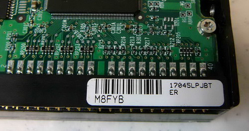

Yes you have mixed it up, the letters KMGA is one of the things needed for when you seeks new heads.
What you need is to get a compatible Pcb, the same code on the Pcb sticker must match: Like the example in this picture M8FYB
In your case it looks like A7GKA
