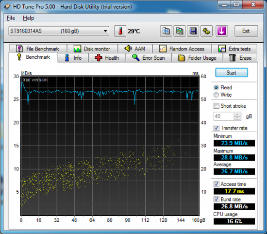

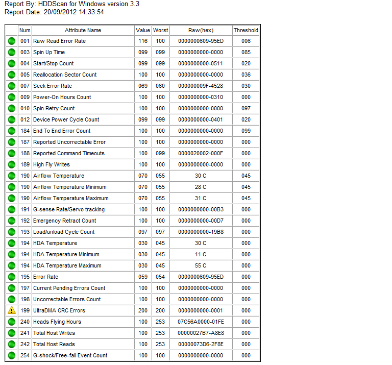

I have a Seagate hard disk problem with the SMART report. Specifically, UltraDMA CRC error.
I would like to know if this indicates a problem or I can forget about this report...
How do you see the graphical performance of the hard disk?
Thank you.

That drive's throughput is being limited somehow - is it attached via USB?
There has been only 1 CRC error, so it is not important at this stage IMHO.
Is this drive being used by you for data, or are you trying to repair it, or are you trying to recover data from it, or something else?

Yes, The testings have been done via usb. I forgot to comment. :oops:

Are you asking "will this drive" (the currently unused Seagate ST9160314AS, whose SMART data you listed at the start of this thread) "give [you] performance issues"? If so then why are you specifically asking about performance (and not reliability, or noise, or anything else)? Do you have a reason why you think the performance from that drive would be abnormal?
IMHO it's not sensible to try to answer any performance questions based on the data supplied so far, since the read throughput graph was collected when the drive was attached via USB. :( If you want to test the native throughput of the drive, you need at attach it via (e)SATA and re-run your throughput benchmark.
