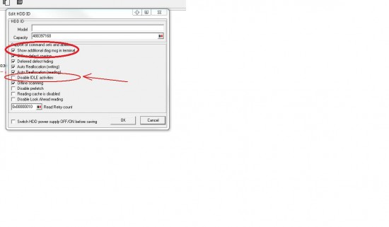

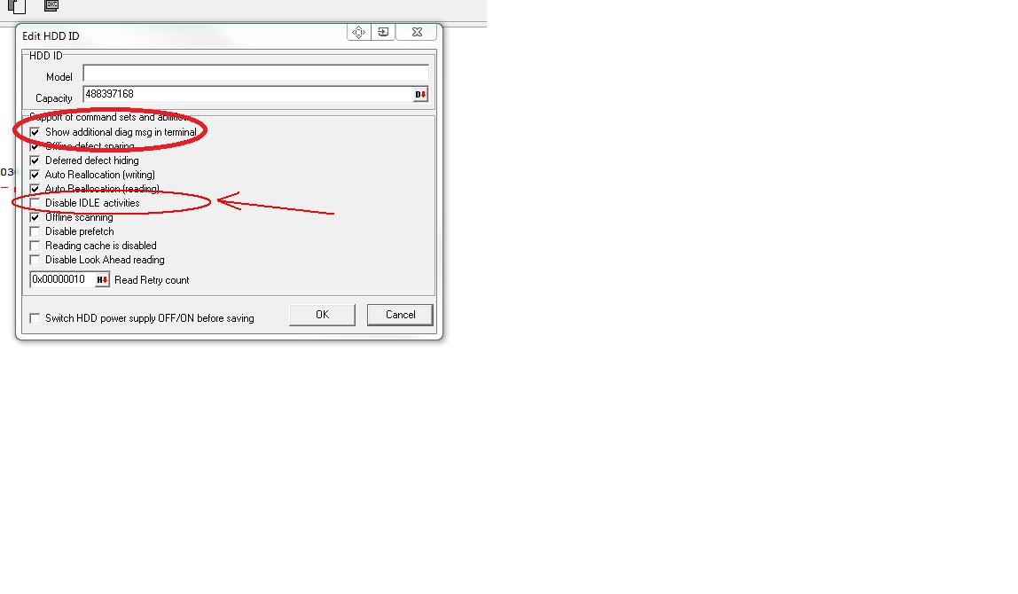

 Post subject: Re: VERY Strange Seagate Behavior
PostPosted: October 17th, 2012, 12:46
Posts: 1038
Location: South Africa
Edit HDD ID to enable additional diag messages in terminal, might get some more useful info.
Thnx Nick will go through this since now am trying what Vulcan told
both sounds interesting really
many thnx will update you soon

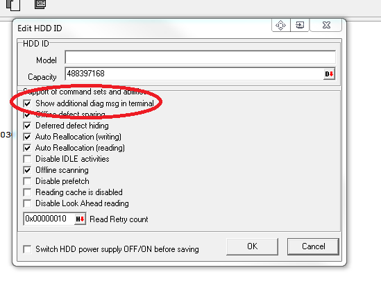

PostPosted: October 18th, 2012, 6:56
Posts: 1093
Location: Angel Data Recovery
Have you tried?
Angel Data Recovery
